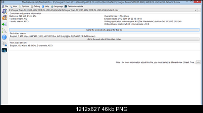

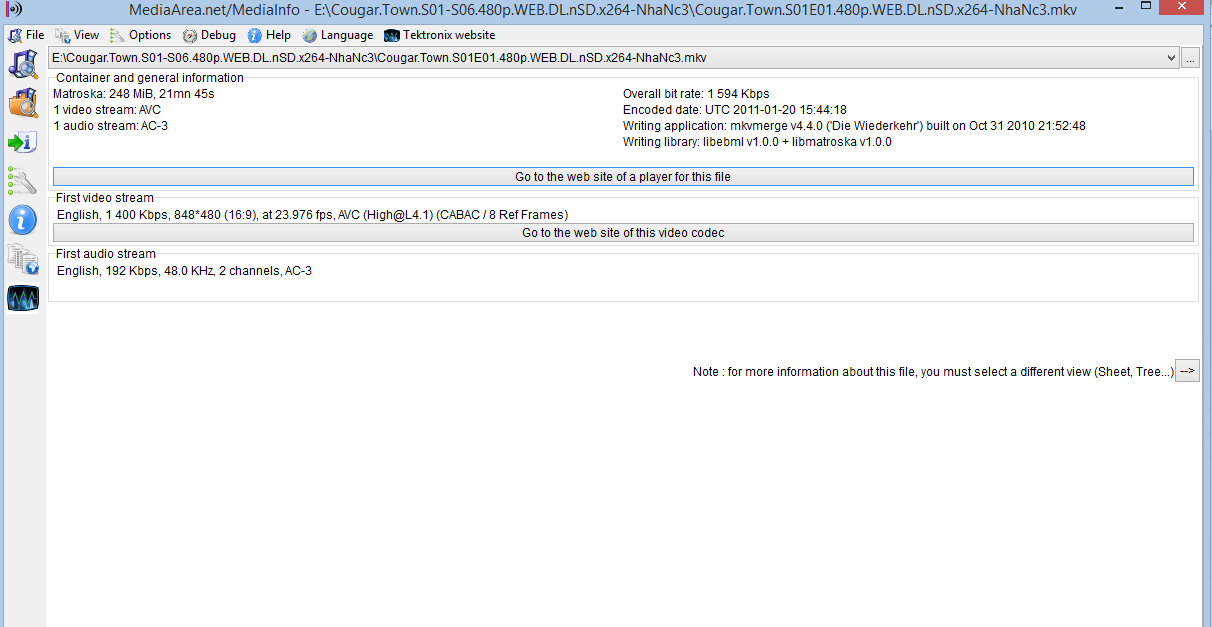

    im having a problem with my vids i make with this program. each video has the audio out of sync, i saw one option in one of the menus to delay the audio i clicked it and it still gave me out of sync videos. the other delay the audio wasnt i saw was greyed out. it remains out of sync throughout the whole vid. i checked the source vids and they were in sync. i just want to make these files into video_ts foler so i can burn it for my sister. this is a new computer and i dont understand why im having a problem with this program. is there a way i can post information about my settings and my computer specs? lso can someone let me know how to make chapters? a link is good enough for that. whenever i try it just returns to the beginning to the first vid. menus didnt help much.
    hoping for a solution soon. cause i would really really appreciate it
    Jan 2007
    this is probably NOT the computer, more likely the video has a problem
    use mediainfo to obtain the info about your video
    could be variable frame rate, number one problem for out of sync audio, number two is an mpr or mkv file with wrong format audio
    Dec 2007
    hi theewizard
    oh ok. well heres a snapshot i took. if you need anymore info on my end please let me know. my sister is getting kinda anxious to see these lol. Click image for larger version
    Jan 2007
    the frame rate looks good
    if you use text mode for the medainfo display
    it will give more specific data, including the run time / length for both the video and the audio
    i'm sure someone will suggest using MKV extract to separate the video and audio tracks
    Dec 2007
    hi theewizard
    heres the list in textmode
    if this determines if i have to use MKV extract will doing so degrade the quality? i find it hard to believe that i would have to do that. the source files look fine and by googling some people have found solutions in AVStoDVD's settings but unfortunately i still havent found a method that works for me. But i have hope.

  12. Member steptoe's Avatar
    Originally Posted by GTAGamesLvr View Post
    Hello
    Check your codecs settings
    Run AVStoDVD, when the main window appears click CodeCS on the top of the window, then choose Preferred DirectShow CodeCS Setup
    Make sure they are all set to LAV Filters and NOT Microsoft Filters .... assuming you have installed LAV Filters
    Even if you have installed LAV Filters it can still be on Microsoft Filters
    I personally use a nightly build with no issues :
    http://files.1f0.de/lavf/nightly/LAVFilters-0.65.0-2.exe
    Microsoft Filters can and will introduce delays and are terrible and outdated compared to decent 3rd party filters, I had this issue even though I had installed LAV Filters and got terrible out of sync issues until it was suggested the exact same problem your having, I had to use Filter Tweaker to force change the codecs to LAV Filters as Windows helpfully refused to let me change it. Another known issues with Windows
    Try this link ifyou cannot change to LAV Filters
    https://www.videohelp.com/download/Win7DSFilterTweaker_5.9.exe
