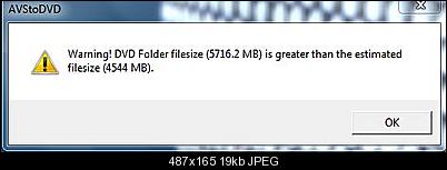

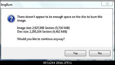

  2. Edit: Think I misunderstood what you meant by log. Where would I find the log you want to look at?
    Like I said before, tried having it on automatic but it just didn't calculate it right and it said it wouldn't fit on the disk anyway, tried it on automatic twice with no luck.
    As with the sync issue I just saw someone post that changing "false" to "true" would sort it and it did. At the start of the video, it had cut out about 3 seconds, there for the audio was behind and just couldn't find a fix. So I have been just doing that.
    Anyway, here is the log.
    '17:44:24' AVStoDVD Release 2.8.2 loaded!
    '17:44:24' AviSynth 2.6.0 is installed ("C:\Windows\system32\avisynth.dll").
    '17:44:24' LAV Filters 0.65.0 is installed ("C:\Program Files\LAV Filters\x86\LAVVideo.ax").
    '17:44:24' ImgBurn 2.5.8 is installed ("C:\Program Files\ImgBurn\ImgBurn.exe").
    '17:44:24' New AVStoDVD Project started!
    '17:45:33' MediaInfoLib - v0.7.74 initialized.
    '17:45:35' Title 1 "C:\Users\Daniel\Desktop\Game Of Thrones - Season 5\Game.Of.Thrones.S05E03.1080p.HDTV.x264.anoXmous\ Game Of Thrones - Episode 3.mp4" added.
    '17:45:43' MediaInfoLib - v0.7.74 initialized.
    '17:45:43' Title 2 "C:\Users\Daniel\Desktop\Game Of Thrones - Season 5\Game.of.Thrones.S05E04.1080p.HDTV.x264.anoXmous\ Game Of Thrones - Episode 4.mp4" added.
    '17:45:53' MediaInfoLib - v0.7.74 initialized.
    '17:45:53' Title 3 "C:\Users\Daniel\Desktop\Game Of Thrones - Season 5\Game.of.Thrones.S05E05.1080p.HDTV.x264.anoXmous\ Game Of Thrones - Episode 5.mp4" added.
    '17:46:23' DVD Size changed from DVD-5 to DVD-5
    '17:46:56' DVD Size changed from DVD-5 to Custom (4700 MB)
    '17:48:53' Motion 16:9 Thumbnails based DVD Menu initialized.
    '17:49:29' DVD Output Setup changed from 'DVD Folder' to 'Burn DVD'
    '17:49:32' AVStoDVD Project started.
    '17:49:32' Title 1 video encoding operations started.
    '17:50:16' AVStoDVD Project ended successfully.
    '17:50:32' Title 3 "C:\Users\Daniel\Desktop\Game Of Thrones - Season 5\Game.of.Thrones.S05E05.1080p.HDTV.x264.anoXmous\ Game Of Thrones - Episode 5.mp4" removed.
    '17:50:35' Title 2 "C:\Users\Daniel\Desktop\Game Of Thrones - Season 5\Game.of.Thrones.S05E04.1080p.HDTV.x264.anoXmous\ Game Of Thrones - Episode 4.mp4" removed.
    '18:00:08' MediaInfoLib - v0.7.74 initialized.
    '18:00:08' Title 2 "C:\Users\Daniel\Desktop\Game Of Thrones - Season 5\Game.of.Thrones.S05E04.1080p.HDTV.x264.anoXmous\ Game Of Thrones - Episode 4.mp4" added.
    '18:00:22' MediaInfoLib - v0.7.74 initialized.
    '18:00:22' Title 3 "C:\Users\Daniel\Desktop\Game Of Thrones - Season 5\Game.of.Thrones.S05E05.1080p.HDTV.x264.anoXmous\ Game Of Thrones - Episode 5.mp4" added.
    '18:01:17' Motion 16:9 Thumbnails based DVD Menu initialized.
    '18:01:53' DVD Output Setup changed from 'Burn DVD' to 'Burn DVD'
    '18:02:26' AVStoDVD Project started.
    '18:02:26' Title 1 video encoding operations started.
    '19:43:29' Title 1 video encoding operations have been completed.
    '19:43:30' Title 1 audio encoding operations started.
    '19:45:16' Title 1 Audio Track 1 encoding operations have been completed.
    '19:45:16' Title 1 chapters encoding operations started.
    '19:45:16' Title 1 chapters encoding operations completed.
    '19:45:17' Title 2 video encoding operations started.
    '20:51:09' Title 2 video encoding operations have been completed.
    '20:51:10' Title 2 audio encoding operations started.
    '20:52:41' Title 2 Audio Track 1 encoding operations have been completed.
    '20:52:41' Title 2 chapters encoding operations started.
    '20:52:41' Title 2 chapters encoding operations completed.
    '20:52:41' Title 3 video encoding operations started.
    '22:26:48' Title 3 video encoding operations have been completed.
    '22:26:48' Title 3 audio encoding operations started.
    '22:28:20' Title 3 Audio Track 1 encoding operations have been completed.
    '22:28:20' Title 3 chapters encoding operations started.
    '22:28:20' Title 3 chapters encoding operations completed.
    '22:28:20' DVD authoring operations started.
    '22:42:40' Warning! DVD Folder filesize (5716.2 MB) is greater than the estimated filesize (4544 MB).
    '22:46:28' DVD authoring operations have been completed.
    '22:46:29' DVD burning operations started.
    '22:47:44' DVD burning operations have been completed.
    '22:47:44' AVStoDVD Project ended successfully.

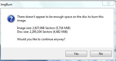

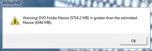

  4. The first one I think is with auto bit rate and the second is with title edit bit rate.
    <02/07/2015 19:16:05>
    START PROCESS
    PROJECT SETTINGS
    DVD Video Standard: PAL
    DVD Titles number: 3
    DVD Size: 4450/4450 MB (100%)
    DVD Output Setup: Burn DVD
    DVD Label: DVD
    DVD Menu: Motion Menu
    Output Folder: C:\Users\Daniel\Videos
    Delete Temp Assets Files: Yes
    Delete Temp Working Files: Yes
    Edit Command Parameters: No
    Post Process Task: Show Progress Status window
    PREFERENCES
    MultiThread: 1
    AVS Video Source Filter: A2DSource
    AVS Audio Source Filter: A2DSource
    AVS UpSize/DownSize Filter: Lanczos4Resize/Spline16Resize
    Frame Adjust Strategy: 0
    FPS Hard Conversion: 0
    PAL SpeedUp: 0
    NTSC SlowDown: 0
    Video Resolution: 1
    Video Encoder: 2
    Video BitRate Min: 3000
    Video BitRate Max: 8500
    Keep DVD Compliant Video: 1
    AC3 Audio Encoder: 0
    Force FFmpeg for Long Audio: 1
    DVD Audio Format: 0
    DVD Audio BitRate: 192
    Keep DVD Compliant Audio: 1
    Normalize Audio: 0
    Auto Delay Audio: 0
    DVD Audio Language (Primary): EN - English
    DVD Audio Language (Secondary): EN - English
    DVD Subs Language (Primary): EN - English
    DVD Subs Language (Secondary): EN - English
    DVD Subs Font: Tahoma 16pt (255,255,255)
    Chapters Interval: 5
    Use Source Chapters: 1
    DVD Burning Drive: D: MATSHITA DVD-RAM UJ870QJ 1.00
    DVD Burning Speed: 2.4x
    Auto Erase DVD RW: 1
    Unload ActiveMovie library: 0
    Adjust DirectShow Filters at runtime: 1
    Save General Settings: 0
    SYSTEM INFO
    Processor Name: Intel(R) Core(TM)2 Duo CPU T7250 @ 2.00GHz
    Operating System: Windows 7 Service Pack 1 (32 bit)
    Current user is Admin: YES
    Available Output Disc Space: 66.1 GB
    AviSynth is installed: YES (release 2.6.0)
    LAV Filters is installed: YES (release 0.65.0)
    ffdshow is installed: NO
    CODECS REPORT
    H.264/AVC: Microsoft DTV-DVD Video Decoder {212690FB-83E5-4526-8FD7-74478B7939CD}
    Xvid: Mpeg4s Decoder DMO {2A11BAE2-FE6E-4249-864B-9E9ED6E8DBC2}
    DivX 4/5/6: Mpeg4s Decoder DMO {2A11BAE2-FE6E-4249-864B-9E9ED6E8DBC2}
    Other MPG4: Mpeg4s Decoder DMO {2A11BAE2-FE6E-4249-864B-9E9ED6E8DBC2}
    DV: DV Video Decoder {B1B77C00-C3E4-11cf-AF79-00AA00B67A42}
    MPEG1: MPEG Video Codec {feb50740-7bef-11ce-9bd9-0000e202599c}
    MPEG2: Microsoft DTV-DVD Video Decoder {212690FB-83E5-4526-8FD7-74478B7939CD}
    MP2: Microsoft DTV-DVD Audio Decoder {E1F1A0B8-BEEE-490D-BA7C-066C40B5E2B9}
    MP3: MP3 Decoder DMO {BBEEA841-0A63-4F52-A7AB-A9B3A84ED38A}
    AAC: Microsoft DTV-DVD Audio Decoder {E1F1A0B8-BEEE-490D-BA7C-066C40B5E2B9}
    AC3: No Preferred Filter set
    TITLE 1 SOURCE FILES
    Video: C:\Users\Daniel\Desktop\Game Of Thrones - Season 5\Game.Of.Thrones.S05E03.1080p.HDTV.x264.anoXmous\ Game Of Thrones - Episode 3.mp4
    Info: AVC - 2151 kbps - 1920x1072 - DAR 1.791 - 23.976 fps (CFR) - Progressive - 59:53 minutes - 86142 frames
    Audio 1: C:\Users\Daniel\Desktop\Game Of Thrones - Season 5\Game.Of.Thrones.S05E03.1080p.HDTV.x264.anoXmous\ Game Of Thrones - Episode 3.mp4
    Info: AAC LC - 124 kbps - VBR - 2 ch - 48000 Hz - 59:53 minutes (0 ms delay)
    [MediaInfoLib - v0.7.74]
    AVISYNTH SCRIPT
    Import("C:\Program Files\AVStoDVD\Lib\A2DSource.avsi")
    Video = A2DVideoSource("C:\Users\Daniel\Desktop\Game Of Thrones - Season 5\Game.Of.Thrones.S05E03.1080p.HDTV.x264.anoXmous\ Game Of Thrones - Episode 3.mp4", CacheFolder="C:\Users\Daniel\AppData\Local\Temp", FrameRate=23.976, VFR=true)
    Audio = A2DAudioSource("C:\Users\Daniel\Desktop\Game Of Thrones - Season 5\Game.Of.Thrones.S05E03.1080p.HDTV.x264.anoXmous\ Game Of Thrones - Episode 3.mp4", CacheFolder="C:\Users\Daniel\AppData\Local\Temp")
    Video = Video.ConvertToYV12()
    Video = Video.AddBorders(0,4,0,4)
    Video = Video.Spline16Resize(720,576)
    #PullDown: using DGPulldown/HCenc to upsize FPS
    AudioDub(Video, Audio)
    START VIDEO ENCODING OPERATIONS
    Video Encoding Profile: HCenc VBR 1-pass
    Target Video FileSize: 1494.8 MB
    Encoding Parameters: -ini "C:\Users\Daniel\AppData\Local\Temp\DVD_Title_01_G ame Of Thrones - Episode 3.HCenc.ini"
    HCenc ini file:
    *INFILE C:\Users\Daniel\AppData\Local\Temp\DVD_Title_01_Ga me Of Thrones - Episode 3_1.avs
    *AVSRELOAD
    *OUTFILE C:\Users\Daniel\Videos\DVD_Title_01_Game Of Thrones - Episode 3.m2v
    *LOGFILE C:\Users\Daniel\AppData\Local\Temp\DVD_Title_01_Ga me Of Thrones - Episode 3.HCenc.log
    *MAXBITRATE 9000
    *1PASS
    *BITRATE 3490
    *PROFILE BEST
    *ASPECT 16:9
    *PROGRESSIVE
    *TFF
    *BIAS 30
    *DC_PREC 8
    *MATRIX MPEG
    *AQ 1
    *LUMGAIN 1
    *SMP
    *PRIORITY IDLE
    *DBPATH C:\Users\Daniel\AppData\Local\Temp
    *WAIT 2
    <02/07/2015 20:50:10>
    END VIDEO ENCODING OPERATIONS
    Video Source Filter: A2DSource (DirectShowSource)
    Created File: C:\Users\Daniel\Videos\DVD_Title_01_Game Of Thrones - Episode 3.m2v (2102.6 MB)
    OUTPUT VIDEO INFO: MPEG-2 Video - 4909 kbps - 720x576 - DAR 16:9 - 23.976 fps - Progressive (TFF) - 59:53 minutes - 86145 frames
    START PULLDOWN OPERATIONS
    DGPulldown Parameters: "C:\Users\Daniel\Videos\DVD_Title_01_Game Of Thrones - Episode 3.m2v" -srcfps 23.976 -destfps 25 -inplace -tff
    <02/07/2015 20:56:15>
    END PULLDOWN OPERATIONS
    DGPulldown executed on File: C:\Users\Daniel\Videos\DVD_Title_01_Game Of Thrones - Episode 3.m2v (2102.6 MB)
    OUTPUT VIDEO INFO: MPEG-2 Video - 4909 kbps - 720x576 - DAR 16:9 - 24 fps - Progressive (2:2:2:2:2:2:2:2:2:2:2:3 Pulldown) - 59:53 minutes - 89824 frames
    <02/07/2015 20:56:19>
    DIRECTSHOW AUDIO MIXER OPERATIONS:
    No LAV Filters mixer ON/OFF adjustment required at runtime
    START AUDIO ENCODING OPERATIONS (Track 1)
    Wavi+Aften Parameters: "C:\Users\Daniel\AppData\Local\Temp\DVD_Title_01_G ame Of Thrones - Episode 3_1.avs" - | "C:\Program Files\AVStoDVD\Aften\aften.exe" -b 192 -pad 0 -dynrng 5 -bwfilter 0 - "C:\Users\Daniel\Videos\DVD_Title_01_Game Of Thrones - Episode 3_1.ac3"
    <02/07/2015 20:58:02>
    END AUDIO ENCODING OPERATIONS (Track 1)
    Audio Source Filter: A2DSource (DirectShowSource)
    Created File: C:\Users\Daniel\Videos\DVD_Title_01_Game Of Thrones - Episode 3_1.ac3 (82.2 MB)
    OUTPUT AUDIO INFO: AC3 - 192 kbps - CBR - 2 ch - 48000 Hz - 59:53 minutes (0 ms delay)
    DVD CHAPTERS CREATION OPERATIONS
    Title 1 Input Chapters List: 7193 14386 21578 28771 35964 43157 50350 57542 64735 71928 79121
    Title 1 Output Chapters List: 7500 15000 22499 29999 37500 45000 52500 59999 67499 75000 82500
    Created File: C:\Users\Daniel\Videos\DVD_Title_01_Game Of Thrones - Episode 3_Chapters.txt (78 Byte)
    <02/07/2015 20:58:03>
    TITLE 2 SOURCE FILES
    Video: C:\Users\Daniel\Desktop\Game Of Thrones - Season 5\Game.of.Thrones.S05E04.1080p.HDTV.x264.anoXmous\ Game Of Thrones - Episode 4.mp4
    Info: AVC - 2151 kbps - 1920x1078 - DAR 1.781 - 23.976 fps (CFR) - Progressive - 50:22 minutes - 72442 frames
    Audio 1: C:\Users\Daniel\Desktop\Game Of Thrones - Season 5\Game.of.Thrones.S05E04.1080p.HDTV.x264.anoXmous\ Game Of Thrones - Episode 4.mp4
    Info: AAC LC - 124 kbps - VBR - 2 ch - 48000 Hz - 50:22 minutes (0 ms delay)

    Created Folder: C:\Users\Daniel\Videos\DVD (5062.3 MB)
    CHECK DVD SIZE
    DVD Folder (actual) Size: 5062.3 MB
    vs Assets Size: 4947.2 MB -> OK
    vs Estimated Size: 4450 MB -> 13.8% oversize

    *OUTFILE C:\Users\Daniel\Videos\DVD_2_Title_01_Game Of Thrones - Episode 3.m2v
    *LOGFILE C:\Users\Daniel\AppData\Local\Temp\DVD_2_Title_01_ Game Of Thrones - Episode 3.HCenc.log
    *MAXBITRATE 9000
    *1PASS
    *BITRATE 3500
    *PROFILE BEST
    *ASPECT 16:9
    *PROGRESSIVE
    *TFF
    *BIAS 40
    *DC_PREC 8
    *MATRIX MPEG
    *AQ 1
    *LUMGAIN 1
    *SMP
    *PRIORITY IDLE
    *WAIT 2
    <03/07/2015 19:38:50>
    Created File: C:\Users\Daniel\Videos\DVD_2_Title_01_Game Of Thrones - Episode 3.m2v (2102.6 MB)
    DGPulldown Parameters: "C:\Users\Daniel\Videos\DVD_2_Title_01_Game Of Thrones - Episode 3.m2v" -srcfps 23.976 -destfps 25 -inplace -tff
    <03/07/2015 19:43:27>
    DGPulldown executed on File: C:\Users\Daniel\Videos\DVD_2_Title_01_Game Of Thrones - Episode 3.m2v (2102.6 MB)
    <03/07/2015 19:43:30>
    Wavi+Aften Parameters: "C:\Users\Daniel\AppData\Local\Temp\DVD_2_Title_01 _Game Of Thrones - Episode 3_1.avs" - | "C:\Program Files\AVStoDVD\Aften\aften.exe" -b 192 -pad 0 -dynrng 5 -bwfilter 0 - "C:\Users\Daniel\Videos\DVD_2_Title_01_Game Of Thrones - Episode 3_1.ac3"
    <03/07/2015 19:45:16>
    Created File: C:\Users\Daniel\Videos\DVD_2_Title_01_Game Of Thrones - Episode 3_1.ac3 (82.2 MB)
    Created File: C:\Users\Daniel\Videos\DVD_2_Title_01_Game Of Thrones - Episode 3_Chapters.txt (78 Byte)
    <03/07/2015 19:45:17>
    AVISYNTH SCRIPT
    Video = A2DVideoSource("C:\Users\Daniel\Desktop\Game Of Thrones - Season 5\Game.of.Thrones.S05E04.1080p.HDTV.x264.anoXmous\ Game Of Thrones - Episode 4.mp4", CacheFolder="C:\Users\Daniel\AppData\Local\Temp", FrameRate=23.976, VFR=true)
    Audio = A2DAudioSource("C:\Users\Daniel\Desktop\Game Of Thrones - Season 5\Game.of.Thrones.S05E04.1080p.HDTV.x264.anoXmous\ Game Of Thrones - Episode 4.mp4", CacheFolder="C:\Users\Daniel\AppData\Local\Temp")
    Target Video FileSize: 1260.9 MB
    Encoding Parameters: -ini "C:\Users\Daniel\AppData\Local\Temp\DVD_2_Title_02 _Game Of Thrones - Episode 4.HCenc.ini"
    HCenc ini file:
    *INFILE C:\Users\Daniel\AppData\Local\Temp\DVD_2_Title_02_ Game Of Thrones - Episode 4_1.avs
    *AVSRELOAD
    *OUTFILE C:\Users\Daniel\Videos\DVD_2_Title_02_Game Of Thrones - Episode 4.m2v
    *LOGFILE C:\Users\Daniel\AppData\Local\Temp\DVD_2_Title_02_ Game Of Thrones - Episode 4.HCenc.log
    *MAXBITRATE 9000
    *1PASS
    *BITRATE 3500
    *PROFILE BEST
    *ASPECT 16:9
    *PROGRESSIVE
    *TFF
    *BIAS 40
    *DC_PREC 8
    *MATRIX MPEG
    *AQ 1
    *LUMGAIN 1
    *SMP
    *PRIORITY IDLE
    *WAIT 2
    <03/07/2015 20:48:41>
    Created File: C:\Users\Daniel\Videos\DVD_2_Title_02_Game Of Thrones - Episode 4.m2v (1287.5 MB)
    OUTPUT VIDEO INFO: MPEG-2 Video - 3574 kbps - 720x576 - DAR 16:9 - 23.976 fps - Progressive (TFF) - 50:22 minutes - 72444 frames
    DGPulldown Parameters: "C:\Users\Daniel\Videos\DVD_2_Title_02_Game Of Thrones - Episode 4.m2v" -srcfps 23.976 -destfps 25 -inplace -tff
    <03/07/2015 20:51:07>
    DGPulldown executed on File: C:\Users\Daniel\Videos\DVD_2_Title_02_Game Of Thrones - Episode 4.m2v (1287.5 MB)
    OUTPUT VIDEO INFO: MPEG-2 Video - 3574 kbps - 720x576 - DAR 16:9 - 24 fps - Progressive (2:2:2:2:2:2:2:2:2:2:2:3 Pulldown) - 50:22 minutes - 75538 frames
    <03/07/2015 20:51:11>
    Wavi+Aften Parameters: "C:\Users\Daniel\AppData\Local\Temp\DVD_2_Title_02 _Game Of Thrones - Episode 4_1.avs" - | "C:\Program Files\AVStoDVD\Aften\aften.exe" -b 192 -pad 0 -dynrng 5 -bwfilter 0 - "C:\Users\Daniel\Videos\DVD_2_Title_02_Game Of Thrones - Episode 4_1.ac3"
    <03/07/2015 20:52:41>
    Created File: C:\Users\Daniel\Videos\DVD_2_Title_02_Game Of Thrones - Episode 4_1.ac3 (69.2 MB)
    OUTPUT AUDIO INFO: AC3 - 192 kbps - CBR - 2 ch - 48000 Hz - 50:22 minutes (0 ms delay)
    Title 2 Input Chapters List: 7193 14386 21578 28771 35964 43157 50350 57542 64735 71928
    Title 2 Output Chapters List: 7500 15000 22499 29999 37500 45000 52500 59999 67499 75000
    Created File: C:\Users\Daniel\Videos\DVD_2_Title_02_Game Of Thrones - Episode 4_Chapters.txt (71 Byte)
    TITLE 3 SOURCE FILES
    Video: C:\Users\Daniel\Desktop\Game Of Thrones - Season 5\Game.of.Thrones.S05E05.1080p.HDTV.x264.anoXmous\ Game Of Thrones - Episode 5.mp4
    Info: AVC - 2151 kbps - 1920x1078 - DAR 1.781 - 23.976 fps (CFR) - Progressive - 56:38 minutes - 81477 frames
    Audio 1: C:\Users\Daniel\Desktop\Game Of Thrones - Season 5\Game.of.Thrones.S05E05.1080p.HDTV.x264.anoXmous\ Game Of Thrones - Episode 5.mp4
    Info: AAC LC - 124 kbps - VBR - 2 ch - 48000 Hz - 56:38 minutes (0 ms delay)
    AVISYNTH SCRIPT
    Video = A2DVideoSource("C:\Users\Daniel\Desktop\Game Of Thrones - Season 5\Game.of.Thrones.S05E05.1080p.HDTV.x264.anoXmous\ Game Of Thrones - Episode 5.mp4", CacheFolder="C:\Users\Daniel\AppData\Local\Temp", FrameRate=23.976, VFR=true)
    Audio = A2DAudioSource("C:\Users\Daniel\Desktop\Game Of Thrones - Season 5\Game.of.Thrones.S05E05.1080p.HDTV.x264.anoXmous\ Game Of Thrones - Episode 5.mp4", CacheFolder="C:\Users\Daniel\AppData\Local\Temp")
    Target Video FileSize: 1417.8 MB
    Encoding Parameters: -ini "C:\Users\Daniel\AppData\Local\Temp\DVD_2_Title_03 _Game Of Thrones - Episode 5.HCenc.ini"
    HCenc ini file:
    *INFILE C:\Users\Daniel\AppData\Local\Temp\DVD_2_Title_03_ Game Of Thrones - Episode 5_1.avs
    *AVSRELOAD
    *OUTFILE C:\Users\Daniel\Videos\DVD_2_Title_03_Game Of Thrones - Episode 5.m2v
    *LOGFILE C:\Users\Daniel\AppData\Local\Temp\DVD_2_Title_03_ Game Of Thrones - Episode 5.HCenc.log
    *MAXBITRATE 9000
    *1PASS
    *BITRATE 3500
    *PROFILE BEST
    *ASPECT 16:9
    *PROGRESSIVE
    *TFF
    *BIAS 40
    *DC_PREC 8
    *MATRIX MPEG
    *AQ 1
    *LUMGAIN 1
    *SMP
    *PRIORITY IDLE
    *WAIT 2
    <03/07/2015 22:23:19>
    Created File: C:\Users\Daniel\Videos\DVD_2_Title_03_Game Of Thrones - Episode 5.m2v (1962.7 MB)
    OUTPUT VIDEO INFO: MPEG-2 Video - 4844 kbps - 720x576 - DAR 16:9 - 23.976 fps - Progressive (TFF) - 56:38 minutes - 81480 frames
    DGPulldown Parameters: "C:\Users\Daniel\Videos\DVD_2_Title_03_Game Of Thrones - Episode 5.m2v" -srcfps 23.976 -destfps 25 -inplace -tff
    <03/07/2015 22:26:46>
    DGPulldown executed on File: C:\Users\Daniel\Videos\DVD_2_Title_03_Game Of Thrones - Episode 5.m2v (1962.7 MB)
    OUTPUT VIDEO INFO: MPEG-2 Video - 4844 kbps - 720x576 - DAR 16:9 - 24 fps - Progressive (2:2:2:2:2:2:2:2:2:2:2:3 Pulldown) - 56:38 minutes - 84959 frames
    <03/07/2015 22:26:48>
    Wavi+Aften Parameters: "C:\Users\Daniel\AppData\Local\Temp\DVD_2_Title_03 _Game Of Thrones - Episode 5_1.avs" - | "C:\Program Files\AVStoDVD\Aften\aften.exe" -b 192 -pad 0 -dynrng 5 -bwfilter 0 - "C:\Users\Daniel\Videos\DVD_2_Title_03_Game Of Thrones - Episode 5_1.ac3"
    <03/07/2015 22:28:20>
    Created File: C:\Users\Daniel\Videos\DVD_2_Title_03_Game Of Thrones - Episode 5_1.ac3 (77.8 MB)
    OUTPUT AUDIO INFO: AC3 - 192 kbps - CBR - 2 ch - 48000 Hz - 56:38 minutes (0 ms delay)
    Title 3 Input Chapters List: 7193 14386 21578 28771 35964 43157 50350 57542 64735 71928 79121
    Title 3 Output Chapters List: 7500 15000 22499 29999 37500 45000 52500 59999 67499 75000 82500
    Created File: C:\Users\Daniel\Videos\DVD_2_Title_03_Game Of Thrones - Episode 5_Chapters.txt (78 Byte)
    <03/07/2015 22:28:21>
    START DVD MENU BUILDING OPERATIONS
    DVD Menu settings:
    Style: 1
    Aspect Ratio: 1
    Titles Format: 1
    Template: Menu in Black
    Max Titles Page: 12
    Enable Play All: 1
    Force Play All: 0
    Background Audio: 0
    Max Thumbs Row: 4
    Thumb Image Source: 0
    Thumb Frame Position: 10%
    HL Frame Format: 0
    HL Selection Color: 5
    HL Play Color: 0
    Menu Video BitRate: 6000 kbps
    Motion Menu Duration: 15 seconds
    Thumb Drop Shadow: 2
    Play All Shadow: 2
    Arrows Shadow: 0
    <03/07/2015 22:29:38>
    END DVD MENU BUILDING OPERATIONS
    Created File (Menu Page 1): C:\Users\Daniel\Videos\DVD_2_MenuPage1.m2v (10.7 MB)
    <03/07/2015 22:29:39>
    START DVD AUTHORING OPERATIONS
    BatchMux Parameters: -arglist "C:\Users\Daniel\AppData\Local\Temp\DVD_2_BatchMux .ini"
    BatchMux ini file:
    -d "C:\Users\Daniel\Videos\DVD_2\VIDEO_TS"
    -mxp "C:\Users\Daniel\AppData\Local\Temp\DVD_2_MuxMan.m xp"
    -l "C:\Users\Daniel\AppData\Local\Temp\DVD_2_MuxMan.l og"
    -muxman "C:\Program Files\AVStoDVD\MuxMan"
    -prio LOW
    -palette "C:\Users\Daniel\AppData\Local\Temp\DVD_2_Palette. txt"
    -v "C:\Users\Daniel\Videos\DVD_2_Title_01_Game Of Thrones - Episode 3.m2v"
    -vidmode LB
    -a1 "C:\Users\Daniel\Videos\DVD_2_Title_01_Game Of Thrones - Episode 3_1.ac3"
    -a1lang en
    -cellfr "C:\Users\Daniel\Videos\DVD_2_Title_01_Game Of Thrones - Episode 3_Chapters.txt"
    -progfr "C:\Users\Daniel\Videos\DVD_2_Title_01_Game Of Thrones - Episode 3_Chapters.txt"
    -chapfr "C:\Users\Daniel\Videos\DVD_2_Title_01_Game Of Thrones - Episode 3_Chapters.txt"
    -SEG2v "C:\Users\Daniel\Videos\DVD_2_Title_02_Game Of Thrones - Episode 4.m2v"
    -SEG2vidmode LB
    -SEG2a1 "C:\Users\Daniel\Videos\DVD_2_Title_02_Game Of Thrones - Episode 4_1.ac3"
    -SEG2a1lang en
    -SEG2cellfr "C:\Users\Daniel\Videos\DVD_2_Title_02_Game Of Thrones - Episode 4_Chapters.txt"
    -SEG2progfr "C:\Users\Daniel\Videos\DVD_2_Title_02_Game Of Thrones - Episode 4_Chapters.txt"
    -SEG2chapfr "C:\Users\Daniel\Videos\DVD_2_Title_02_Game Of Thrones - Episode 4_Chapters.txt"
    -SEG3v "C:\Users\Daniel\Videos\DVD_2_Title_03_Game Of Thrones - Episode 5.m2v"
    -SEG3vidmode LB
    -SEG3a1 "C:\Users\Daniel\Videos\DVD_2_Title_03_Game Of Thrones - Episode 5_1.ac3"
    -SEG3a1lang en
    -SEG3cellfr "C:\Users\Daniel\Videos\DVD_2_Title_03_Game Of Thrones - Episode 5_Chapters.txt"
    -SEG3progfr "C:\Users\Daniel\Videos\DVD_2_Title_03_Game Of Thrones - Episode 5_Chapters.txt"
    -SEG3chapfr "C:\Users\Daniel\Videos\DVD_2_Title_03_Game Of Thrones - Episode 5_Chapters.txt"
    -SEG4v "C:\Users\Daniel\Videos\DVD_2_MenuPage1.m2v"
    -SEG4vidmode LB
    -SEG4s1 "C:\Users\Daniel\Videos\DVD_2_Menu.sst"
    -SEG4s1dmode WIDE_LB
    -SEG4hlmnu "C:\Users\Daniel\AppData\Local\Temp\DVD_2_MenuPage 1_Buttons.mnu"
    -SEG4hlcsm "C:\Users\Daniel\AppData\Local\Temp\DVD_2_Highligh tScheme.csm
    -hcn "C:\Users\Daniel\AppData\Local\Temp\DVD_2_BatchMux .hcn"
    <03/07/2015 22:46:28>
    END DVD AUTHORING OPERATIONS
    Created Folder: C:\Users\Daniel\Videos\DVD_2 (5716.2 MB)
    CHECK DVD SIZE
    DVD Folder (actual) Size: 5716.2 MB
    vs Assets Size: 5592.7 MB -> OK
    vs Estimated Size: 4544 MB -> 25.8% oversize
    <03/07/2015 22:46:29>
    START DVD BURNING OPERATIONS
    ImgBurn (DVD) Parameters: /mode isobuild /buildmode device /src "C:\Users\Daniel\Videos\DVD_2\VIDEO_TS" /dest D: /volumelabel "DVD" /speed 2.4x /erase /testmode no /verify no /noimagedetails /start /waitformedia /close /log "C:\Users\Daniel\AppData\Local\Temp\DVD_2_ImgBurn. log"
    <03/07/2015 22:47:44>
    END DVD BURNING OPERATIONS
    Created DVD: 'DVD' in drive D: MATSHITA DVD-RAM UJ870QJ 1.00
    Log file created by AVStoDVD Release 2.8.2

  7. @Drastic
    the culprit is within the 1st title ("Episode 3"): predicted output filesize is 1494.8 MB, actual output filesize is 2102.6 MB. The other 2 titles ("Episode 4" and "Episode 5") deliver consistent filesizes.
    As gonca has suggested, you should avoid to have Microsoft DTV-DVD Video and Audio codecs doing the decoding stuff for your video and audio files. Use Win7DSFilterTweaker (or the tool inside AVStoDVD: 'Codecs'/'Preferred DirectShow Codecs Setup') to switch from MS codecs to LAV Filters. Then retry to encode just the 1st title ("Episode 3") to see if the output filesize becomes OK. Using LAV Filters instead of MS codecs could solve the sync issue too.
    Another option, if the previous try fails, is to select 'HCenc VBR 2-pass' instead of 'HCenc VBR 1-pass' in 'Edit Title'/'Video' of 1st title. Encoding in 2 passes could give a better bitrate allocation.
    Bye
    P.S. You can find many more info and details on how AVStoDVD works in the Help doc, mainly in the FAQ section. Just press F1 after opening AVStoDVD.
    MrC
    AVStoDVD Homepage
  8. Originally Posted by _MrC_ View Post
    @Drastic
    Bye
    Ok, so just changed to LAV Filters and in the title preview the sync issue has gone, also, the video actually plays from the start. It would normally cut out about 3secs. So hopefully all will be fine after the encoding!
