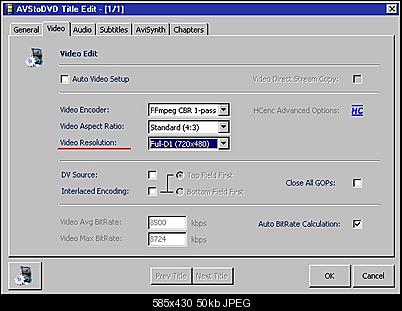

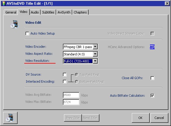

    How will removing one if I can fix my problem with avstodvd with the mpeg not keeping at correct size? I haven"t had no issues with any video at all using avstodvd expect the videos I been trying for months. I'm stumped.
    No reason to get stumped. All you did was discovering a bug in the VLC media player...
    I tried to reproduce your problem, I created a VCD with exactly the same properties as your source file, converted it to a DVD structure using your settings, and sure enough VLC would play the result as widescreen.
    All other software players I tried (MPC-HC, PowerDVD, Tiny Player, WMP) played the DVD at the correct aspect ratio. I burned the DVD structure and played it in my standalone DVD player, and the result was also a perfect 4:3 video playback.
    More tests showed that VLC only plays MPEG2 videos correctly if they have the Full-D1 size of 720 x 576/480. If the size is Half-D1 or VCD then VLC will distort the image. I did not find anything in the VLC settings which could remedy this problem. All you can do in VLC when you encounter such a distorted image is to right-click on the video and under Video -> Aspect Ratio force the correct aspect ratio.
    So you can either use a different player to test your VCD conversions, or you have to specify Full-D1 in the AVStoDVD settings.
    I am quite confident that your issues have nothing to do with AVStoDVD, your DirectShow filter setup is also not to blame.
    Cheers

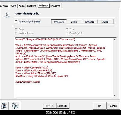

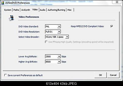

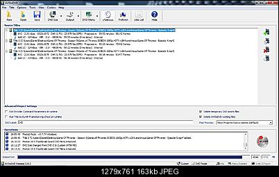

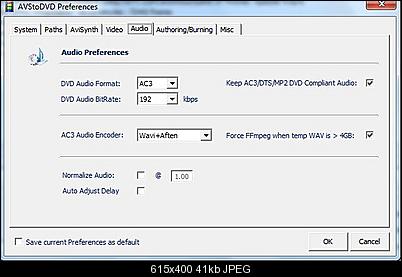

  24. Edit: Can't post log atm, will be able to later. Hopefully someone might have a suggestion without the log for now, if not will just post the log when I can. (Using different pc)
    Got a problem with the file size. Had a quick look around but can't find solution and hope someone knows whats going on.
    Trying to burn 3 files onto a dvd-5 disk. All goes well until its just about to burn them, then it pops up saying the files are to big to fit on the disk.
    Before starting the conversion, I checked that the bar below that shows if the files will fit on the disk was red and it wasn't, it was blue. Was able to fit 2 fine but not 3. For the 3 files it converts/formats them to just over 5bg, but it doesn't say that before I start the process. Even if i'm about to just do 1 file the size looks a lot bigger than it should be. bigger than the original file. The original file sizes for the files are about 800mb each. I do have the automatic bit rate on.
    Have been able to put the same 3 files on the disk using convertxtodvd with quite a bit of space left over but just don't like the quality it produces and not sure how to change it, so I'm a bit confused why I am having problems with avstodvd. Using latest AVStoDVD, 2.8.2.
    Hope someone can help, thanks!

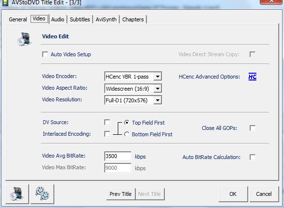

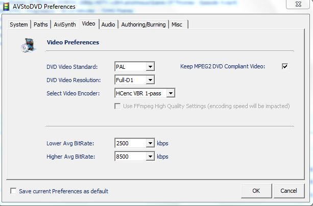

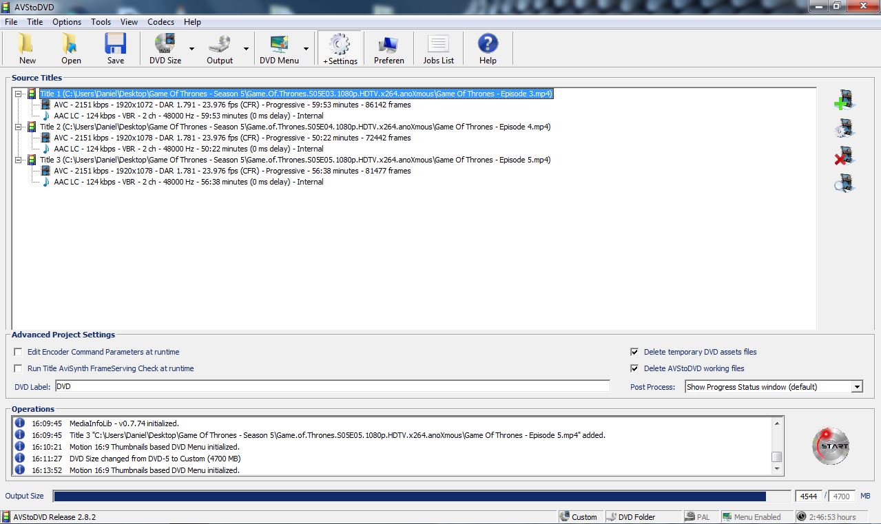

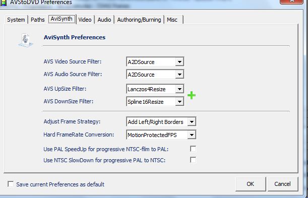

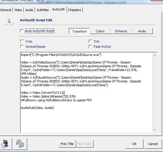

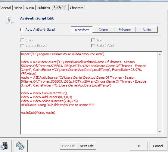

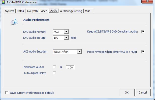

    Ok, just started the same project again but have changed the individual bit rates for the files as suggested and will post the log when it has finished. For now, will post my settings before it started, which might be useful. You'll see in the pics that I also have a problem with the sound syncing, but have temporally sorted it by changing the word "false" to "true" under Avisynth, which I saw someone posted somewhere else, maybe there is a better way to deal with this, I'm not sure.
    As you can see I have changed the bit rate for each file to 3500 so it says the files will fit onto the disk with some free. But as mentioned before, I had it so it did it automatically and the file sizes were not that different (Think they were around 3600/3700) And said it was able to fit to disk but after it had finished converting, just as it started to burn, it popped up with a message saying the files were to big.
    Also, for one files at 3500 bit rate, it says it will output onto the disk at 1.6gb. Is that normal or unusual. The file is about 900mb.

  30. Member
    Jan 2007
    Should work, but it's going to be close
    You have 2hrs 46 min of video on a 2 h4 disc
    I would have set max but rate at 6500 for this project, for ALL THREE videos
    IMO. 4544 estimated size for 4700 disc doesn't leave much room for coding variance
