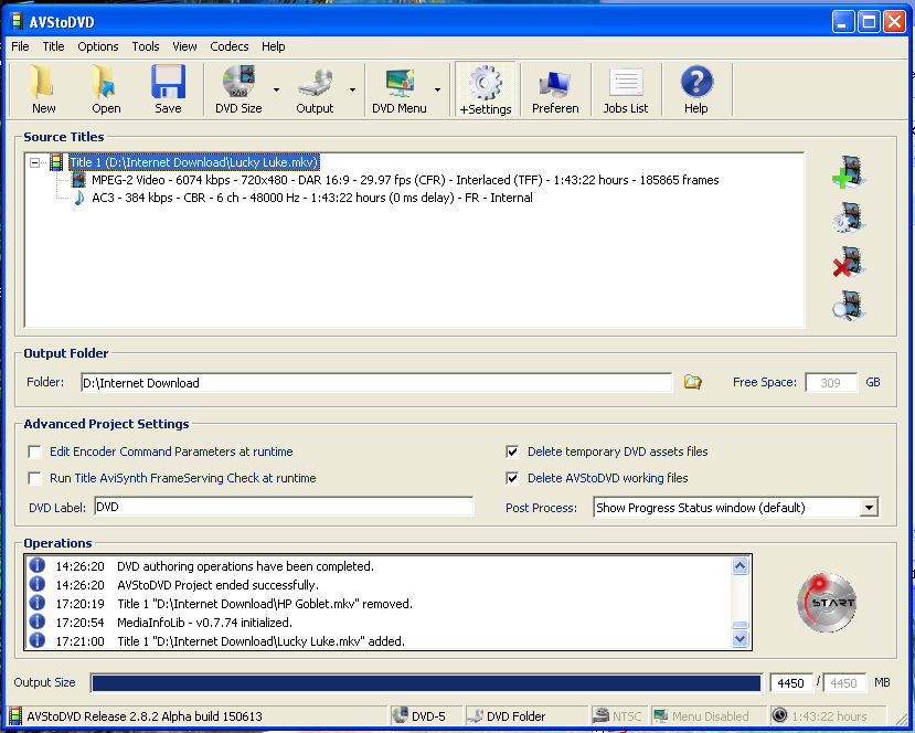

    Since I still have the iso and the (Video_TS unzip with winrar) I use MakeMkv with the Video_TS and the output
    as an MKV is OK for Minority and Lucky luke. Then I use AvsToDvd with this MKV as input and it give me that the
    output will be to big like : 6540 for Minority and 4887 for Lucky Luke. So I can't processed.
    If I use the .ifo instead, then both have an output of 4450 which is OK. (But still have the synchro problem)

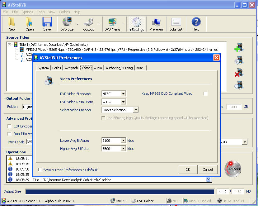

    This is because under "Preferences" you have checked "Keep DVD compliant Video" and probably the same for audio. This means that AVStoDVD makes no attempt to reencode your DVD compliant source. Uncheck these options both for audio and video and try again...
    That bugs me a lot !!!
    With the .ifo method DGDecode is used as the source filter, and in this case the input will always be reencoded (the setting under "Preferences" is ignored.

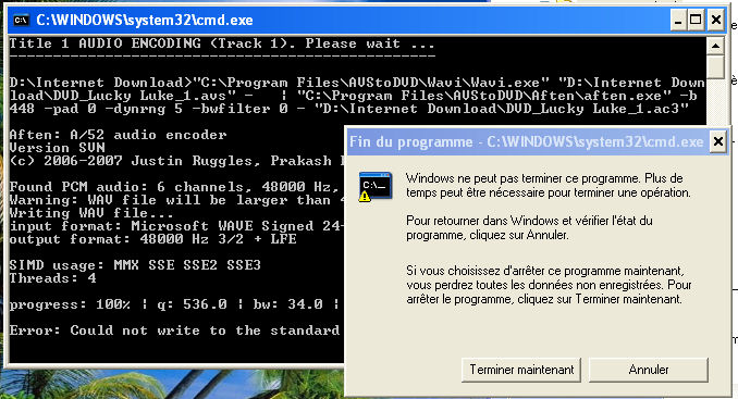

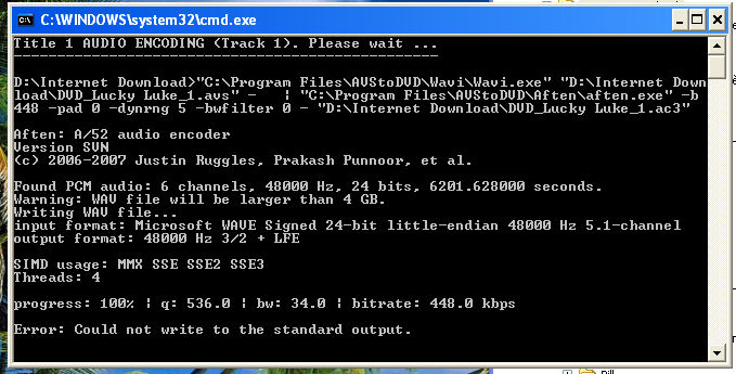

    Finally it work properly on both video .

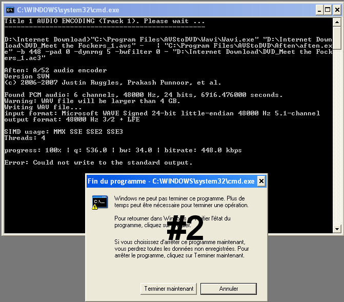

    But the Lucky Luke has an error "Could not write to the standard output ".
    I had to click the "X" to get out of it then another one windows for CMD.exe
    then another one from AvsToDvd for FFmpeg in safe mode. I click yes then
    everything is OK. If this is normal then many thanks to you.
    Hi Dan,
    no, this is not normal, but it seems to be unrelated to your previous sync issues. Could you post the log for this conversion?

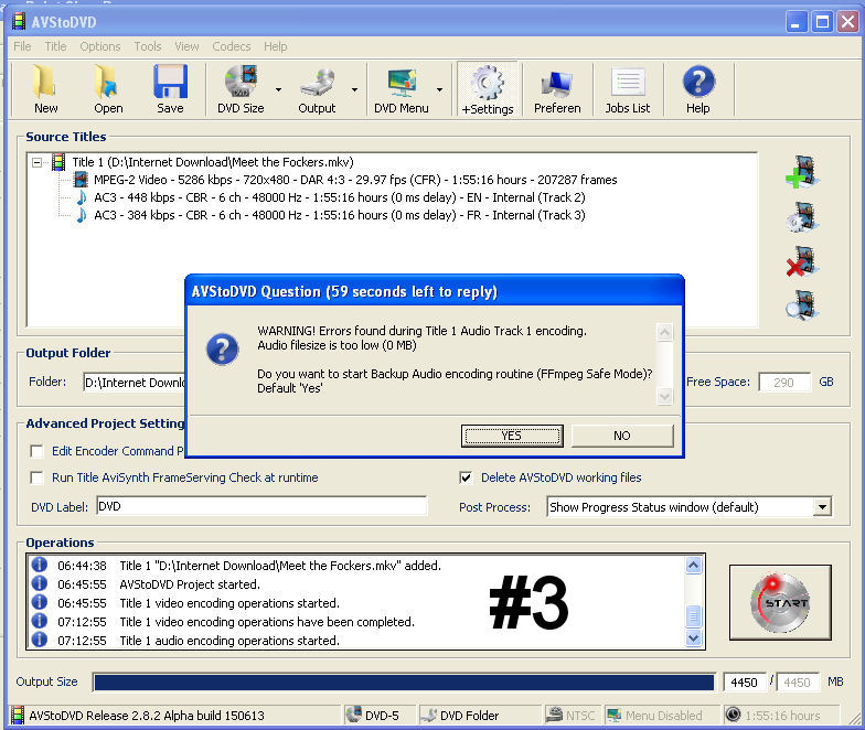

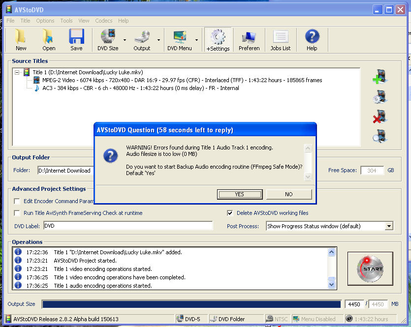

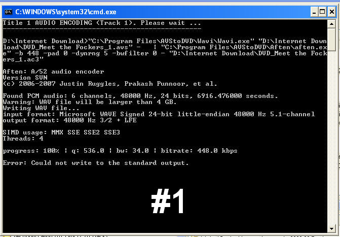

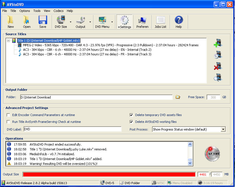

    I did redo the Lucky luck to be sure and I include the LOG plus photos of what I saw. I burned it and everything i OK.
    I have too "Harry Potter - Globlet of fire" that I have to lower "Lower Avg Bitrate" to 2100 in Preferences to be able to fit it to 4449Gb.
    It's a 2h36m long with 2 audio tracks. I thing that it has the same going as for Lucky Luke as for audio, but I was out so when
    I came back, it was done completely. I include the LOG too. But everything seems OK , I didn't check every minutes of it yet.

    I believe you discovered at least 1 serious bug for video conversion (it is the second file, it should have been encoded at 23.976 fps with pulldown, but the framerate was hard converted to 29.97 instead. And this confused the size calculation completely. Maybe because the source was detected as having variable frame rate which is impossible for DVD compliant MPEG2), and probably another one for audio. It's a little late for me now, I am too tired to write anything useful right now, but I'll get back to you tomorrow. And I think that MrC will have a good look at your log files, too.
    And thanks for your kind words, much appreciated...

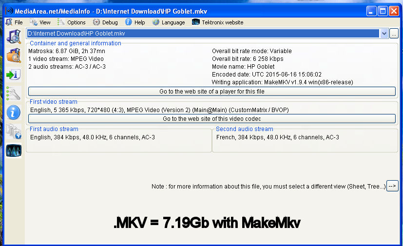

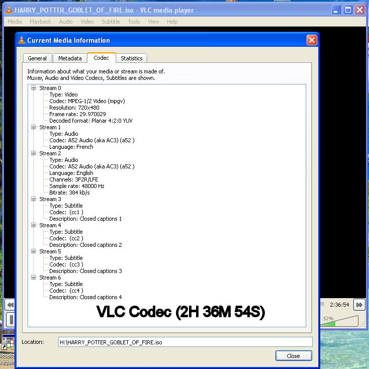

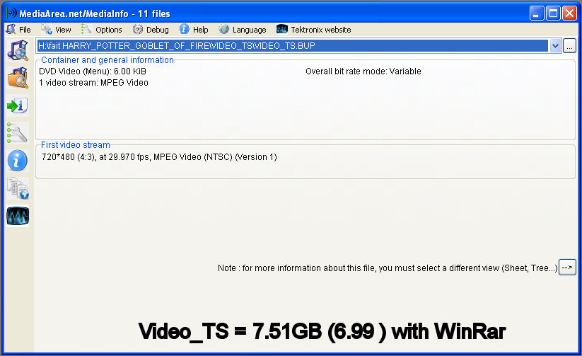

    Sorry for the order of the photos, I did send them in order.
    Here's another view of the same file. I wrote directly on it this time.
    What about for Lucky Luke and the 3 windows ?

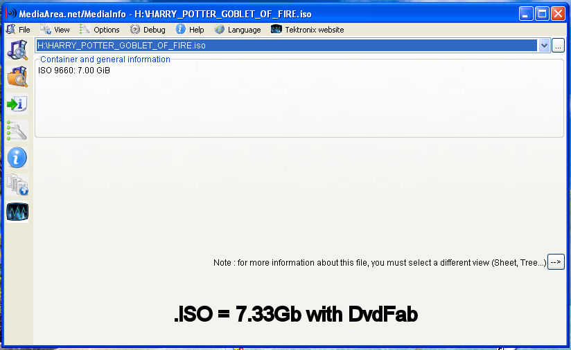

    I had a thought when I saw on MakeMkv the warning sign according to DvdFab doing damaged VOB files.
    I include the photo of it. And I all ripped them (10 DVD) with DvdFab 9.2.0.1. Could it be that all my problems
    came with it. So I'm using MakeMkv with the .iso or Video_ts made with DvdFab.

    OK, I did take the time to analyze the logs for your two conversions, and I believe I have a pretty good understanding of what happened...
    The MediaInfo information about your source files does not point to any problems. Sure you cannot rule out that DVDFab created some broken VOB files, but to me it does not look like DVDFab is the problem.
    I believe you discovered two bugs in AVStoDVD. The first bug lies in the audio conversion routine. In your settings you have selected to use ffmpeg instead of Wavi + Aften if the resulting WAV file is > 4 GB. For both of your source files this is the case (see the Wavi console window). So the Wavi + Aften routine should not have been used in the first place. AVStoDVD falls back to use ffmpeg if Wavi + Aften results in an error, so no real damage is done except wasting some time.
    For the first conversion (Lucky Luke) I can explain why AVStoDVD did not detect that the WAV file would be too big. The duration is under 2 hours, and a 16 bit 6-ch WAV file of this duration would be smaller than 4 GB. But for some reason the LAV audio source filter decided to output a 24 bit WAV file which is bigger. In the LAV audio filter setup all bit depths are enabled by default, and the "best" format will be used automatically.
    For the second file (HP Goblet) I have no explanation why A2D did not use ffmpeg immediately for audio conversion. At a duration of 2 and a half hours even a 16 bit 6-ch WAV file will be > 4GB.
    The second bug is much more serious, it only affects the second conversion (HP Goblet). The source file has these properties:
    Info: MPEG-2 Video - 5365 kbps - 720x480 - DAR 4:3 - 23.976 fps (VFR) - Progressive (2:3 Pulldown) - 2:37:04 hours - 282424 frames
    Detecting a variable frame rate is not correct for an MPEG2 video source.
    Quote from Mr. Donald Graft:
    MPEG2 video does not support VFR (other than small changes using repeat flags)
    I do not know if the VFR detection is just cosmetic or if it is the cause of the following error. For this source format AVStoDVD should have reencoded the video at the source framerate of 23.976 fps and then should have created pulldown flags.
    Instead it hard-converted the framerate to 29.97 fps, but then still applied pulldown. The pulldown routine had no effect at all because source fps and target fps were identical. But the target duration was recalculated to be 3 hours 16 minutes which of course is completely wrong.
    Title 1 output Video duration (02:37:03) is shorter than expected duration (03:16:19)
    So as a result you got a DVD structure where the bitrate was much lower than necessary, and the framerate conversion to 29.97 also wasted quality because more frames were encoded than necessary.
    Looks like some work for MrC. I do not know if this bug is a recent regression or if it has been there for some time. Whatever, I am again glad that I live in PAL country...
    Cheers
    manolito
  16. @djdan
    wow! the mkv containing Harry Potter has a DVD ripped mpeg2 stream apparently encoded in VFR (Variable Frame Rate)! You have found a new video gender! And the DAR (Display Aspect Ratio) is 4:3! Definitively there were something wrong during the DVDFab -> MakeMKV process.
    As suggested by manolito, you can skip the DVDFab step and rip the DVD directly with MakeMKV. At least you will remove one variable.
    About the audio warning, I suggest you to keep the audio as it is, without re-encoding it. Just leave the 'Preferences'/'Audio'/'Keep DVD compliant audio' option ON. Re-encoding the original DVD audio track can be useful only if you want to alter the volume, apply a delay or downgrade the original AC3 (e.g. lowering the bitrate or decreasing the channels).

  17. Originally Posted by manolito View Post
    Well, "bug" is probably a big word in these cases... I would say "how to improve the 3rd party software flaws handling"... BTW... semantics...
    Good finding. Now we have to understand what has triggered LAV Filters to output the WAV file with a 24 bit resolution. I would avoid to use ffmpeg any time there is a multichannel source track lasting more than 1 hour...
    Actually from that log file, the ffmpeg routine was immediately used. The warning message is related to the estimated output time not matching with the real output time.
    Yes, the VFR false reading is the culprit. Just a couple of code lines to correct the extimated output time routine and avoid the message about the wrong video and audio output duration. I agree that VFR pulled down mpeg2 source should not exist, but if they would ever exist, the framerate conversion would be "hard".
    Open to discussion, as always.
    Bye
    MrC

  18. Member
    Aug 2006
    Canada
    I have another one (Meet the Fockers) that have the sound "10 sec" after the video, really 10 sec.
    So I will go pick up again the 10 DVDs and use MakeMkv instead of DvdFab as source.
    And I will see if there's a difference. I did try to adjust the sound with the trick of Manolito but when
    I approach 0.0 sec, in the Preview title output the synch jump back elsewhere. At around "-.120" I'm close
    but as soon as I go lower, it goes very bad. It's a non sense since it should be around -10 Sec, not in MS.
    I even do a Video_ts with -11 (-11000) in avisynch and the sound is around +10 ahead anyway.
    Anyway I will redo everything with the MakeMkv instead of DvdFab, and see if it's help.
    I include some photos of it (Meet the Fockers) in case you'd like to look at it.
    P.S. If you like me to do some settings before I try again then let me know.
  19. Member manolito's Avatar
    Jun 2009
    Germany
    @djdan
    A 10 sec audio delay is just insane, I've never come across something llike this. You should really get rid of DVDFab, I had a lot of different issues with it some years ago. I then switched to AnyDVD and never looked back. And so far MakeMKV has also been very reliable for me.
    So I agree, discard all the rips you made using DVDFab and redo the ripping with MakeMKV. I am confident that your sync problems will disappear...
    Cheers

    @ MrC
    Looks like LAV always uses the highest bit depth which the hardware allows. AviSynth itself will automatically downconvert the bit depth if an AviSynth audio filter requires a lower bit depth. (Applying the SSRC filter to resample audio to 48 kHz is enough to trigger a conversion to 16 bit.)
    It should not have anything to do with the source properties, because compressed audio does not have a bit depth (I learned this from tebasuna).
    Possible remedies:
    Since you already adjust the LAV settings at runtime, you could disable 32 bit and 24 bit output dynamically (at a slight cost of quality).
    Or you could add the "-readtoeof 1" parameter to the Aften command line each and every time (makes the progress indicator inaccurate).
    (Or tell people to use my Wavi_Mod plugin... )
    BTW I recently had some problems with the plugin when LAV output was 24 bit and I was using DynamicAudioNormalizer. For some obscure reason DynamicAudioNormalizer does accept 24 bit input from a file, but not from STDIN. For STDIN the stream must be either 16 bit or 32 bit. So I had to modify the DynNorm routine to always convert the input to 16 bit.
    Just found an older post by Gavino which explains this behavior:
    SSRC() returns float audio.
    If Avisynth is being used through the VfW interface, this is converted to 16 bit as VfW does not support float.
    Add ConvertAudioTo24Bit() to the end of your script to force retention of 24 bits.
    So AVStoDVD uses AviSynth through the VfW interface?
    Tested it with a short Youtube clip with 44.1 kHz AAC audio. The LAV audio status window reports 32 bit float for input and output, Wavi detects 16 bit integer. This confirms Gavino's post.
    Cheers

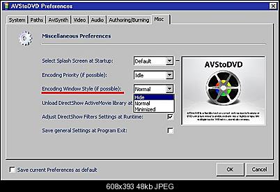

  22. Member
    Jun 2015
    Canada

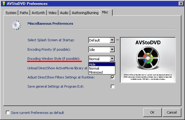

    I've been using AVStoDVD for years and am very happy with it.
    One issue I have is the way it keeps popping to the front every step of the process. If I start something encoding, and then pop on netflix to watch something while it runs, it won't stay in the background. Every time a new stage of the encoding starts, the program jumps up on top of everything and requires me to re-minimize it, interrupting my movie (or whatever else I happen to be doing.)
    Anything I can do to force it to stay minimized?
  23. Member manolito's Avatar
    Jun 2009
    Germany
    Hi EmileB,
    have you tried this setting (under "Preferences") ?
    Cheers
    manolito
  24. Originally Posted by manolito View Post
    Possible remedies:
    Well, my friend, you are doing the most "R" part of AVStoDVD "R&D" in these days...
    Since A2D is already using SSRC/ResampleAudio to make audio rate conversion, I would use the following rationale:
    - if SSRC is selected -> not a problem
    - if ResampleAudio is selected -> add in advance ConvertAudioTo16bit to make sure that ResampleAudio output a 16bit stream
    - if none (i.e. source track is already 48 kHz) -> force SSRC(48000)
    That scenario should work also when other audio source filters are selected instead of DSS.
