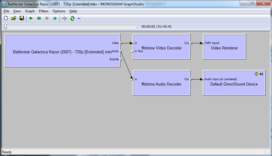

    I have been checking out my system and it seems I don't have haali installed. It's in the avchdcoder "Installation tools" folder, but I can't see it anywhere else. So I checked out ffdshow. The version that comes with avchdcoder is dated 2011. The version I have installed in 2014-06-28. Clearly not installed by avchdcoder.
    Hmm.. That raises another question.. If ffdshow requires a separate splitter, and haali is not installed, and since I can build a DVD successfully, then .... ???
    I built this system up from scratch a month ago, and 2.8.0 I think had already been released; at which point LAV filters were being used. So I'm not sure how ffdshow found it's way onto my system. (I use avchdcoder, winff, handbrake, avstodvd, mkvtoolnix, mediainfo, dvdfab9 and makemkv)
    Thanks for the tip about the graph. It appears to show that ffdshow is being used as the primary filter.
    I guess I'll just have to restore to one of my earlier images prior to installing all this stuff and build from that point on, so all of my progressive backups are without ffdshow... <sigh>

  4. Member manolito's Avatar
    Jun 2009
    Germany
    Just took a look at the avchdcoder installation guide, and it says that ffdshow, Haali and AviSynth are required. So chances are that you do have Haali installed.
    It is also very possible that avchdcoder will work correctly without ffdshow / Haali, because LAV Filters offer the same (and more) decoding formats. An example is BD-Rebuilder which also listed ffdshow as a requirement, but meanwhile recommends LAVFilters.
    But of course you can also do it the other way around: Get rid of LAV Filters and use ffdshow /Haali exclusively. AVStoDVD supports ffdshow without any restrictions. So use whatever floats your boat...
    Cheers
    manolito
    Yes, I read that too. However, AVStoDVD used to install ffdshow and Haali. AVCHDCOder requires that these be installed manually, via menu options provided in the program. Since AVStoDVD moved to LAV Filters Haali and FFDShow were not installed.
    As you noted, AVCHDCoder may well, and has indeed been working fine without Haali. I checked again and it is not installed where it should be (C:\programs file (x86)\haali\matroskasplitter), or anywhere else on my system.
    I don't recall installing a later version of ffdshow myself, but I must have. Middle age setting in I suppose
    I have uninstalled ffdshow and avstodvd is now using LAV filters.
    I am running tests with both programs and so far everything seems to be going ok. Just started a movie with avchdcoder. We'll see how that goes.
    thank you for your assistance.

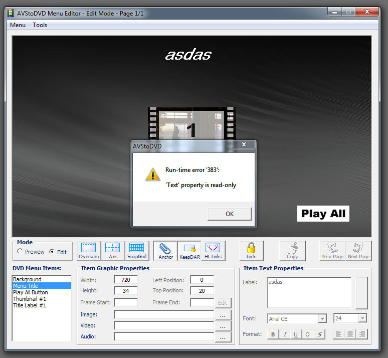

    Actually, I may have found a problem.
    If I go into menu editor, change the title text and change the font, then try to move or resize the title field I get an Error 383 "'Text' Property is read only!" and avstodvd subsequently exits.
    If I dont change the font I can move the title around. But if I then change the font and attempt to move it, the error occurs. I don't have to change the text either.
    However, if I change some other property like the font size, then move the title field it resets to Arial (The original font), and I can move the field around. If I then change the font again, then it will crash.
    Tried this with several different files, all MKV, and with multiple and single files and with mixed content (avi and mkv). I can replicate the error every time.
    I'm running 2.8.1 with the hotfix
    thanks

  7. Member manolito's Avatar
    Jun 2009
    Germany
    Hi Yanta,
    I tried to reproduce your problem, but I couldn't (WinXP)...
    The error message comes from Visual Basic, it can be caused by dozens of different issues. I did get this error message in the past on several occasions, and uninstalling AVStoDVD, deleting its reg key under HKCU/Software and reinstalling always took care of it.
    But probably MrC will have some better advice for you...
    Cheers
    manolito
  8. @Yanta
    Do you gey the error with every font you select, or only with a specific font? If a specific font, what is its name?
    Bye
    MrC
    AVStoDVD Homepage

    Originally Posted by _MrC_ View Post
    @Yanta
    Do you get the error with every font you select, or only with a specific font? If a specific font, what is its name?
    Bye
    1. Arial CE and Arial CYR crash the program.
    2. Arial Greek resets to Arial when moving text
    3. All others I sampled seem to work fine
    4. When selecting a font that works, then selecting Arial CE or CYR it will not crash, it resets the font to Arial.
    I have restored my system to an image prior to installing any authoring programs and installed AVStoDVD from scratch, with the hotfix.
    This time ffdshow has NOT been installed (Not related - but it refers back to an earlier thread).
    Edit: I'm using Windows 7 Ult x64 Technet, 32gb ram, GTX970 Video, I7-4790K @ 4.4ghz, with 256GB SSD Boot and 2TB spinner for data.

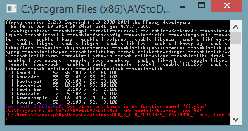

    I'm new here. I just downloaded and installed AVStoDVD, I changed nothing at all, I imported a video and I get an error message. If I import a different video I get the same error.
    During installation I ticked every option, then I also installed ImgBurn. I'm using Win 8.1 x64.
    I installed the alpha version after this, but same error remained.
    avisynth script error: there is no function named: "fity2uv"
    Image Attached Images
  18. Hi there phoenixy
    which AVStoDVD release are you using? Have you downloaded the Installer package or the NoInstall package?
    There is some simple troubleshooting in the FAQ (Help/FAQ/Video). Make sure you have already read and followed the suggestions in the FAQ section.
    Bye
    MrC

  19. Member steptoe's Avatar
    Originally Posted by phoenixy View Post
    Hi,
    Just looking via Google, that's a MaskTools related error (but probably will mean nothing to you)
    Did you install Avisynth, it IS needed by AVStoDVD ....
    This link is the latest Avisynth, that 'might' solve your problems. I use the NoInstall version of AVStoDVD out of choice. Simply copy the entire 'NoInstall' folder to anywhere you want to run it from and thats about it. Apart from installing [I]Avisynth[I] and [I]IMGBurn[I] (which you already have)
    This is the direct link to the NoInstall version of AVStoDVD ...... Extract the archive and either run it from there or rename the folder to anything you wish and copy anywhere you wish. It will happily run from your DeskTop if you want it to
    http://downloads.sourceforge.net/project/avstodvd/avstodvd/AVStoDVD%202.8.1/AVStoDVD_2..._mirror=heanet
    If you are still getting weird errors, copy and paste the entire script from the avisynth tab in AVStoDVD (you will have to turn off the auto avisynth script option so you can copy the contents of that window
    That should be able to tell us exactly what is being run in avisynth and why its flagging an error
    Also, are you using FFMPEG or HCEnc for the encoder. If the wrong version of FMPEG isn't installed that can cause problems as well (but shouldn't be if you used the AVstoDVD installer, and should also have installed LAVFilters - which are much better than Microsoft). All that is solved if you use the NoInstall AVStoDVD .... Which is another reason I use that. Less software to install, and less chance of conflicts

  20. Member manolito's Avatar
    Jun 2009
    Germany
    Hi phoenixy,
    your error indeed comes from MaskTools.
    The function "MotionProtectedFPS" needs masktools.dll, and it only works with exactly the version which comes with AVStoDVD. You can check it by going to the "AVStoDVD\lib" folder and make sure that the masktools.dll version is 1.5.1.0.
    If you have the correct version in the "lib" folder, then it is possible that you have a different version in your AviSynth\plugins folder. This version will autoload and might therefore have priority over the correct version which comes with AVStoDVD.
    Solution: Rename MaskTools.dll in the AviSynth\plugins folder or copy the version from the AVStoDVD\lib folder into the plugins folder. Please note that the newer mt_masktools-25.dll does not cause any conflict with AVStoDVD. Just do not rename it to masktools.dll.

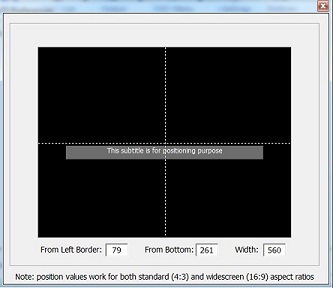

    Hi, I'm having problems when it comes to the "switchable" subtitles. I can't get them to change their position from the preference tab, and they end up not showing fully on the picture.
    The picture shows the the intended position of the subtitles, the one as attachment is the result in the DVD.
  24. Hi there Finnjavel,
    what AVStoDVD release are you using? Could you please upload the .log file of one project with this issue?
    Bye
    MrC
    AVStoDVD Homepage

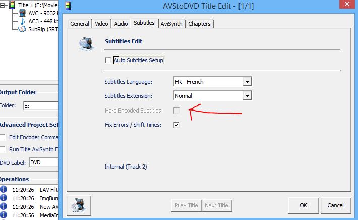

    hi why do i have to demux subtitles in order to hard encode them in my dvd ?
    I can't select hard encoded if subtitle is directly in the mkv.
    sorry for my english.
    thanks

  26. Because VSFilter TextSub() function requires that the SRT/SSA/ASS subtitle is a separate file.
    You can use the 'Tools'/'Demux File' section to extract the SRT subs from your MKV and then add the extracted file to the AVStoDVD project.
    Bye
