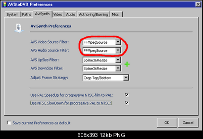

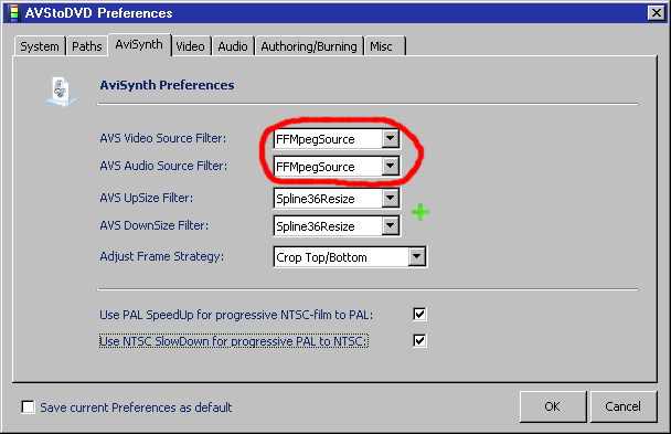

    Selecting 'FFMpegSource' in 'Preferences'/'AviSynth'/'AVS Audio Source Filter' and 'FFmpeg (Safe Mode)' as 'AC3 Audio Encoder' in 'Preferences'/'Audio' (I assume they are both supposed to be changed at once) didn't work, the delay is still there.
    I know I can adjust the delay manually, but it requires an extra encode to see what the delay is.

    Hi Ygramul,
    I tried to reproduce your problem, but my MKV came out without any audio delay problems. What puzzles me is that AVStoDVD refuses to treat your audio as "DVD compatible". It stumbles over the bitrate of 640 kbps, but this bitrate is compatible to the best of my knowledge. Also Muxman has no problem muxing such an audio file, so you might have discovered a bug...
    Using FFMPEGSource as your source filter and using ffmpeg safe mode for audio are two completely unrelated things. FFMPEGSource is an alternative to DirectShowSource, it indexes the source files before decoding which makes it a little slower. But this method makes it frame accurate while seeking. Whenever you get problems with DirectShowSource, there is a good chance that FFMPEGSource does a better job.
    ffmpeg safe mode for audio bypasses AviSynth for audio processing. You cannot do any AviSynth based processing any longer (like compensating delays or normalizing), but by eliminating some possibly problematic steps you can sometimes save a conversion.
    Could you cut out a part of your problematic MKV (use the split function of MKVMergeGUI) and upload it somewhere like ZippyShare?

  24. Member manolito's Avatar
    Jun 2009
    Germany
    IMO you should try two things:
    1. To rule out that your source MKV is broken, load it into MKVMergeGUI and remux it to a different file.
    2. To rule out problems with your DirectShow filters, specify FFMPEGSource for audio and video:
    The reason that ConvertXToDVD creates juddery pans is that it does not use soft pulldown like AVStoDVD. Instead it hard-converts the frame rate to 29.97 by repeating whole frames (as opposed to repeating fields which is done by pulldown).
    Good luck
    manolito

  27. Member Ygramul's Avatar
    Jan 2007
    Parts Unknown
    [Attachment 31328 - Click to enlarge]
    It worked perfectly with one file, but not so well with another one (desync changed from -360 to +130).
    So I unchecked "auto delay audio" in the title settings for the second file and everything's fine now. Thanks!
    Also I noticed that the whole encoding process is significantly shorter with video source filter set to FFMpegSource (down to 10 minutes from about 16). Does that have any impact on the video quality?
