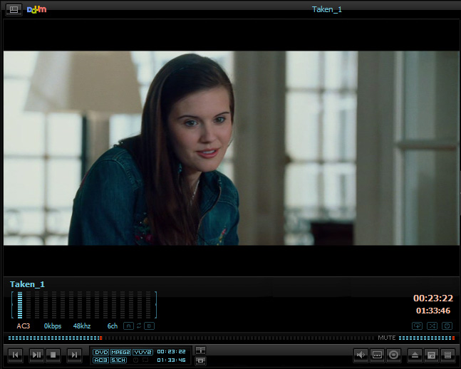

    I'm starting with a MKV file with named chapters (See example.txt).
    After conversion the DVD has no working chapters, though according to example2.txt there are chapters in the DVD (although the names are lost).
    sample.jpg shows the file played with Duam Pot Player. No chapters.
    Tried changing custom chapters in AVStoDVD but just can't get chapters to work.
    What am I doing wrong?
    thanks
    Tanya
    10940x with Creator X299 Motherboard, 32GB DRR4-3733, RTX 3080 Ti GPU

    This is strange, because your created DVD obviously does contain chapters. AFAIK the DVD standard does not support named chapters, so this information will be lost.
    Did you try to play this DVD on different software players (MPC-HC and VLC) ? And what about hardware players?
    Cheers
    Just installed VLC. I shows there are chapters in the DVD and I can use them.
    I tried the "Browse chapter/Bookmark" option in Pot Player and it says there are no chapters/bookmarks.
    I hadn't burned the folder to disk, as I didn't want to waste a disk if the DVD had no chapters.
    This looks like it is a pot player problem. I will go to their support.
    thanks for your assistance.
