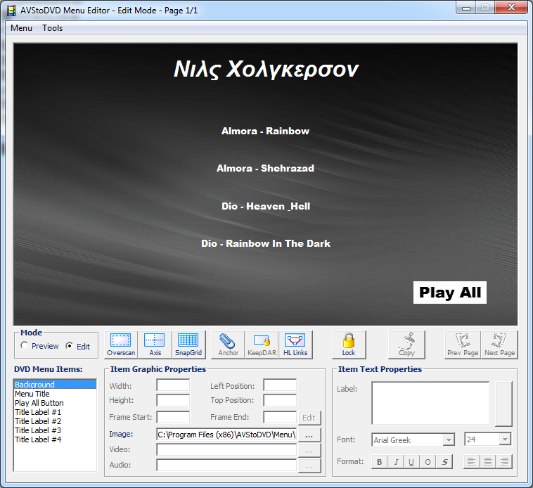

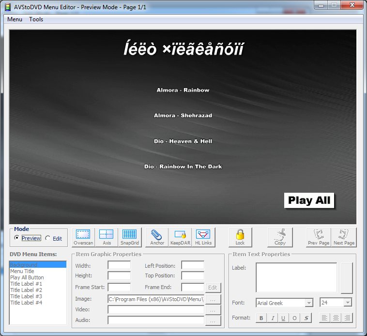

    Great piece of software, simple and to the point.
    I have 2 questions?
    Question 1:
    I want to convert some TV-series episodes to DVD.
    I have done couple of test and when the DVD menu creation was disable then I couldn't skip from episode to episode. Seams like it didn't put in any chapters at all. One test video I put in was over 5 minutes and the skip chapter still didn't work.
    When the menu was enabled everything worked ok.
    And this brings me to my 2nd question:
    How can I put some Greek text in the "Menu Title"?
    I changed the font to "Arial Greek" (both of them).
    When in "Edit" mode it show just fine (in the preview window, in the label I get some funny accented letters).
    When I change back to "Preview" mode the letters in the preview window are all garbled up. The same happens after the DVD creation.
    (see attached screenshots)
    I am using AVStoDVD v2.8.0 portable, AviSynth v2.5.8 and ImgBurn v2.5.8.0
    on a Win7 64bit machine and I am rendering to .ISO

  4. Hi basile,
    first of all welcome there and thanks for the kind words.
    Answer 1: I'm quite puzzled, if you enabled chapters (as by default), then you should be able to move forward and backward with your DVD remote controller. If that does not work, could you post here the project log file?
    Answer 2: Help > FAQ > Authoring > Q6.3 (apologize)

    I understand why in the textbox can't be shown the Greek letters, but why not in the generated bmp?
    As to my original 2nd question maybe these links can be of some assistance?
    http://www.example-code.com/vb/vbUnicode1.asp
    http://www.vbforums.com/showthread.php?p=3261531#post3261531
    Found both of them referenced here: http://stackoverflow.com/a/541801 and http://stackoverflow.com/a/14081257
    basile

    P.S.: it would be great though if non-English fonts would be supported in the Menu.

    Your other problem that you cannot access the help section sounds interesting to me (because I had a similar problem recently). Do you get any error message, or is there simply no response? Are there other menu entries which do not work?
    The reason I ask is that just recently I suddenly lost the language selection entries (only English was available, Italian and German had disappeared). And I could not access the Quick Startup Tutorial from the "Tools" menu.
    Cheers
    manolito
    Cheers Manolito, will experiment with those filters.
    The other issue with menu would show up but the body of the menu would be blank, I went back to 2.7.5 and its working ok, now 2.8.1 is out might give that a go.
    My CDROM error message comes up using 2.8.1 but program starts after I close.

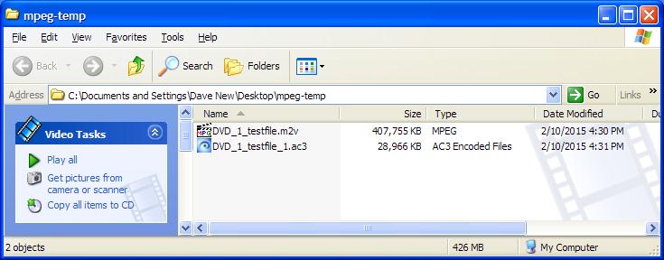

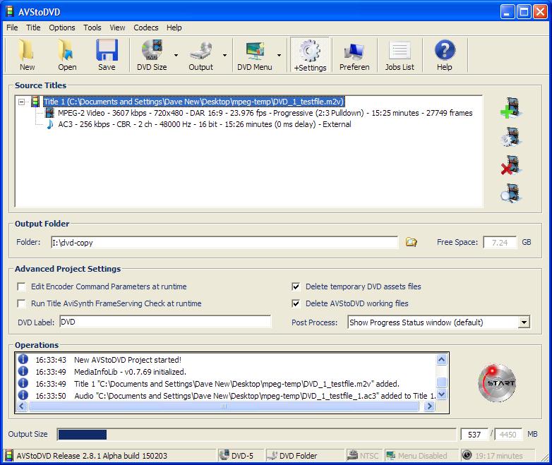

  27. Member
    Mar 2008
    I'm trying to figure out the size discrepancy when adding two dvd compliant files to the project.
    The source file was originally 23.976 frame rate, encoded to mpeg-2 with pulldown applied.
    As can be seen from the explorer window, the video is 407MB, and the audio is 28MB.
    However, as can be seen from the A2D window, it calculates a size of 537/4450.
    Indeed when you start the project, it gets an error related to size.
    Any idea what's happening ?
  28. Member manolito's Avatar
    Jun 2009
    Germany
    Are you sure that you have selected "Keep DVD Compliant Video" and "Keep Compliant Audio"? Because if you haven't then AVStoDVD will reencode the streams instead of just muxing them, and this of course will result in a different output size.
    Cheers
    manolito

  30. Member
    Mar 2008
    Originally Posted by _MrC_ View Post
    @dave
    nice to see you back on this thread!
    There's a discrepancy between the time reported in the source titles section (15:25) and the total project time in the status bar (19:17). The factor is exactly 29.97/23.976. Very likely a fresh bug... Thanks for report.
    Bye
    Thanks MrC - look forward to the next alpha.
    The source file was actually 29.97. But it was created incorrectly, it should really be 23.976.
    Out of every group of 5 frames, one was a duplicate. Much better to resolve this in the avisynth script,
    before encoding to re-create the proper 23.976 frames and encode with pulldown.
