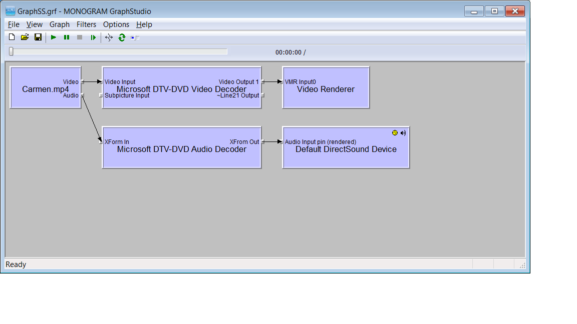

    Here is first 200MB of mp4 file:
    http://www66.zippyshare.com/v/OC0s0ctK/file.html
    I certainly appreciate your help!

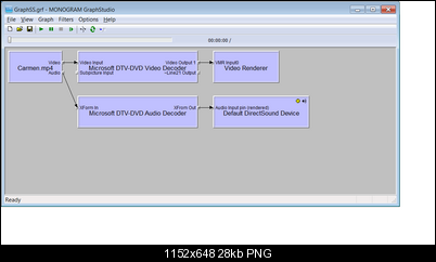

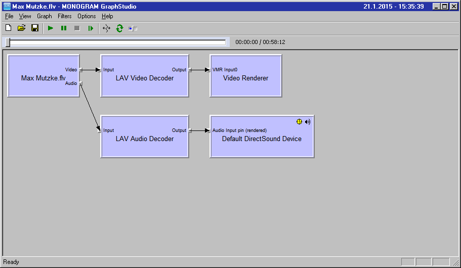

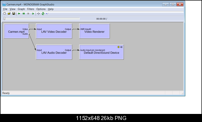

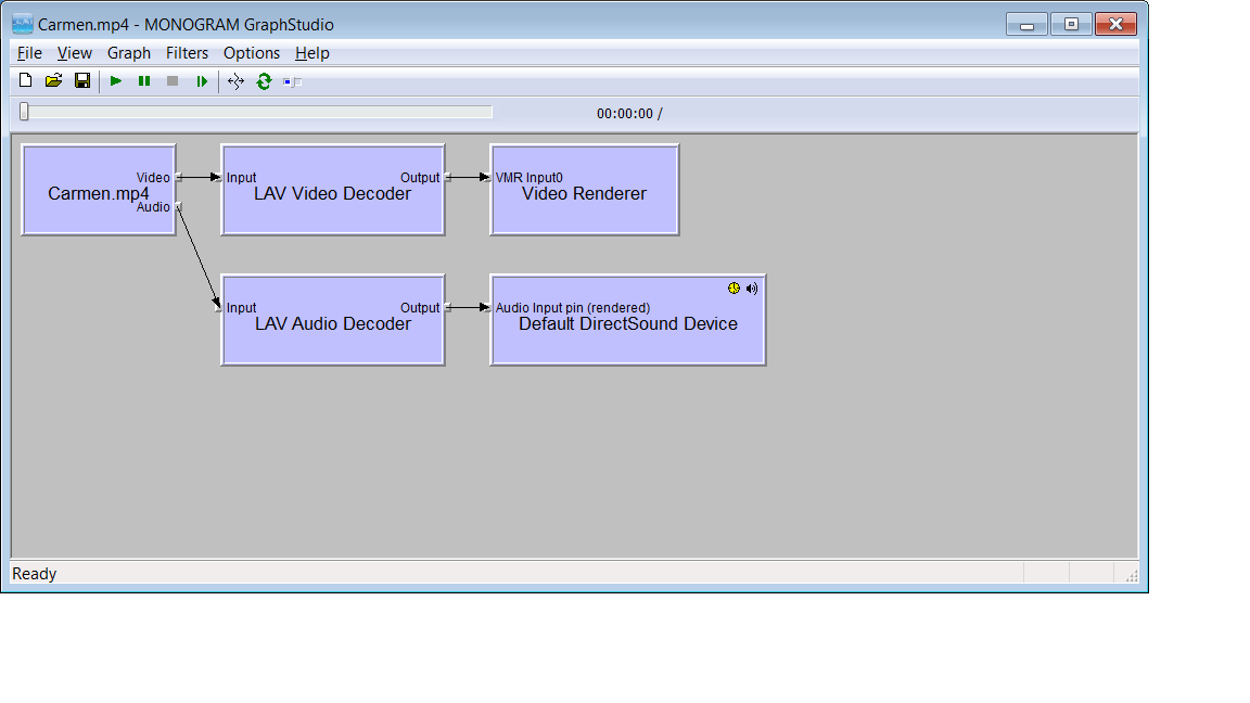

  4. Member manolito's Avatar
    Jun 2009
    Germany
    Alright, first of all a part of a file which was split using an archiver like WinZip or WinRar cannot be opened by any software. This only works if all the parts are available. For splitting an MP4 file use AVIDemux.
    Whatever, your filter graph shows that your computer does not use LAVFilters at all, the Microsoft filters take over. A typical Win7 and Win8 problem, because M$ think that they own your computer.
    Start AVStoDVD as an administrator, click on "Codecs" and select "Preferred DirectShow Filters Setup". For all filters deselect Microsoft and select LAVFilters instead. If this does not work for you, download the Win7 DSFilterTweaker tool (link on the bottom left of the AVStoDVD window) and tweak your DirectShow filters this way.
    Once you have set up your filters correctly, the graph should look like this:
    Good luck
    manolito
    Jul 2011
    Hurley, NY
    Used DSFilterTweaker to set all filters to LAV (wouldn't allow me to change them in AVStoDVD).
    But got same incompatibility result.
    I will work on AVIDemux.

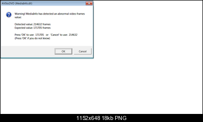

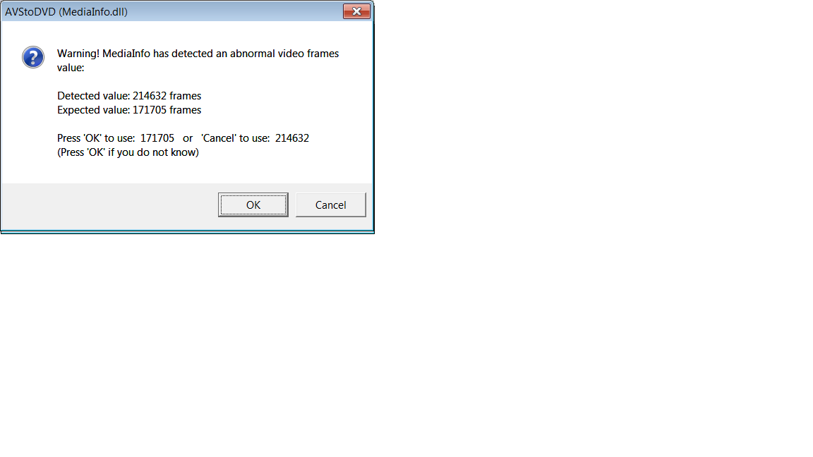

    Jul 2011
    Hurley, NY
    Success!
    I had used Handbrake to rip both MP4 and MKV files, both of which encountered the Incompatibility error in AVStoDVD. When I used AVIDemux to cut the 1st 100MB of the MP4, I wasn't aware that I could change the output from AVI. You suggested that I remux the MP4 to MKV, but I tried remuxing the MKV to MKV to fix what ever problem was causing the Incompatibility.
    The new MKV was acceptable to AVStoDVD (with a MediaInfo Audio sync warning which I answered OK to). The resulting DVD has good quality, and the Audio is perfectly sync'd. I had selected HCenc 1-pass, but it seemed to do 2 passes, which was OK by me.
    PS: I was doing this project for a friend who happens to be the lead actor (Don Jose) in the movie Carmen. He wanted to give out a few copies to classmates at his 50th college reunion, and only had a VHS tape which someone had transferred to his DVD media along with other files. ImgBurn would only allow me to make an ISO of the entire disk. There's no way I could have made this DVD without your help. Thank you!

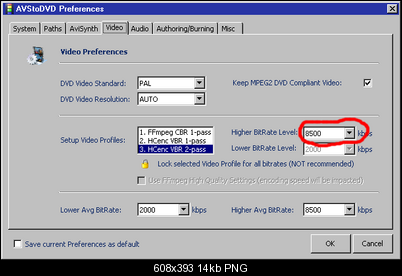

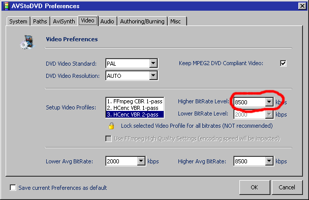

  14. ...C O P Y L E F T JohnnyBob's Avatar
    Feb 2007
    Earth
    My video encoding profile is stuck on Hcenc 2-pass. Changing it in preferences to Hcenc 1-pass has no effect. I've tried several times with short .avi clips. Yes, I check the box at bottom to save current preferences as default, then click OK - which doesn't work.
    Maybe the reason is that I've clicked the little lock icon occasionally while experimenting, but it always stays locked. How do I unlock it?
    Do I have to edit an .ini file somewhere, or what?
    P.S.
    It's definitely stuck on Hcenc 2-pass. I also tried changing to FFmpeg CBR 1-pass which won't work either.
    There was a dropdown list when I first installed AVStoDVD which allowed selecting that preference. Looks like it can't be changed subsequently unless there's some trick of which I'm unaware. I seem to recall that being the case with former versions of AVStoDVD too, but didn't mind because I always wanted to use Hcenc 2-pass anyway. But now I'd like to try Hcenc 1-pass to see how the quality compares.
    Do I have to uninstall/reinstall AVStoDVD just to perform that simple preferences setting change?
    Please respond.
  15. I think you are lock-it in.
    (I still on v. 2.7.5)
    1.- Probably you are double lock it on video too.
    Preferent > Video > Lock selected Video Profile for all bitrates (NOT recomended)
    2.- Preferent > Uncheck: Save current Preferences as default
    3.- Options > Restore Defaults Preferences.
    4.- Exit & restart AVStoDVD
    5.- Apply new settings.

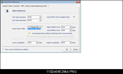

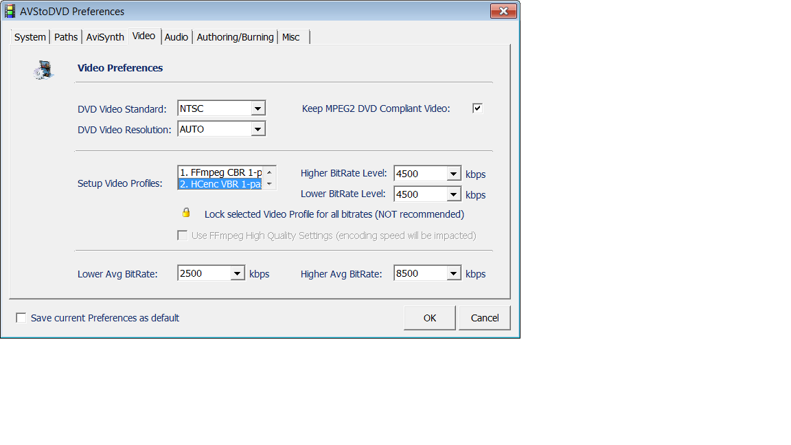

  16. ...C O P Y L E F T JohnnyBob's Avatar
    Feb 2007
    Earth
    4.- Start again your new settings.
    @DJ_ValBec
    Thanks!
    Mystery solved!
    Yes, that worked...and offhand I can't see any difference between 1-pass and 2-pass Hcenc encodings with a short video clip. So I'll probably use 1-pass in future.
    I have no idea of the purpose for the lock icon, nor how it works. The image doesn't change to unlocked when it is clicked. And it isn't explained in Help, that I can find. So I'm probably better off to leave it untouched.
    In your outlined procedure, best is probably to change your current step 4 to read as follows:
    4.- Exit then restart AVStoDVD, then you are offered the same beginner's setup screen as just after installing AVStoDVD new.
    @MrC
    None of this is explained in Help, that I could find...
    Of course this is a very non-intuitive, unusual and difficult procedure, requiring that folder paths and all other preference settings be re-entered too. Hopefully the GUI can be improved to allow easy individual preference changes for Video. I haven't noticed a problem with other preference changes, just Video.
    Part of the problem is that there is no positive indication of which Video encoding option is selected. My suggestion is to change the GUI design to a dropdown list, similar to the beginner's setup screen, with the active selected option being displayed. Or a series of exclusive checkboxes would work too. Also it would be helpful if it is indicated in the popup list when pressing the Start button to begin a project.

    Jul 2011
    Hurley, NY
    I'm still getting the MediaInfo warning no matter what source I'm using:
    AVStoDVD waits until I answer OK, then ac3fix executes, then I get a 2nd MediaInfo.dll warning, which also causes AVStoDVD to wait until I answer. Then MuxMan starts. The resulting DVD is perfectly sync'd, but the whole process hangs until the warnings are answered. I wish there was a default to OK after a certain time passes.
    I read and understood your explanation of the HCenc 1-pass execution, but the log sure seems to think it's executing a 2-pass, even though I selected the 1-pass:

  21. Member manolito's Avatar
    Jun 2009
    Germany
    @ bilvihur
    For the MediaInfo warning have you installed the hotfix from this post?
    https://forum.videohelp.com/threads/277852-AVStoDVD-Support-Thread?p=2366977&viewfull=1#post2366977
    Please do so if you haven't yet.
    Still MediaInfo is not perfect when it comes to detecting the correct number of frames in the source. AVStoDVD checks for a discrepancy between the detected length and the detected number of frames, and if they do not match it displays this warning.
    Since in my experience the number of frames calculated by AVStoDV is always correct, I agree that the OK button should be pressed automatically after a timeout. Until this gets implemented, you can use a small tool which can automatically click away such popup windows. I use a tool called "ClickOff" for this, it's free and easy to use.
    As for the forced HCenc 2-pass mode I think you also locked the 2-pass mode while playing around with the settings. In your previous log file I found these entries:
    Video BitRate Min: 2500
    Video BitRate Level 1: 8500
    Video Profile Level 2: 8500
    Video BitRate Max: 8500
    Your preference window probably looks like this:
    This means that HCenc 2-pass is used for all bitrates. To change this setting back to the defaults it is absolutely not necessary to reset all the AVStoDVD settings and then reenter all settings (like DJ_ValBec suggested). Just edit the value "Higher Bitrate Level" to something like 4500 (the default). Then check or edit the bitrate ranges for the other two encoding modes. When done don't forget to check "Save current Preferences as default" and exit the "Preferences".
    It is important that you understand how this bitrate range setting works. You do not just set one encoding mode as your standard, you set three encoding modes which are selected depending on the video bitrate. As MrC already suggested, make sure to read Help > FAQ > Video > Q3.5.
    Now what the hell is this mysterious "Lock" button? It was not always there, I remember when MrC added this button very reluctantly after some user requests. Just assume for a moment that this button does not exist. If you decide that you want to use the HCenc 2-pass mode for each and every encode no matter what, then you would edit this video preference window and enter the bitrate range just like the screen shot above shows. This would "lock" HCenc 2-pass for all bitrates. And the "Lock" button is nothing but a shortcut for this. It does exactly the same thing as manually entering the bitrate range.
    Alright, end of lecture...
    Cheers
    manolito

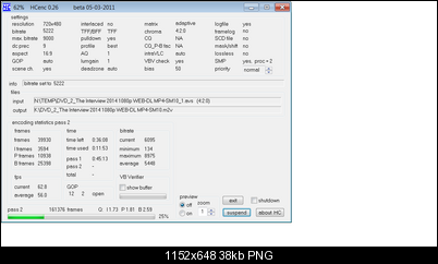

  26. Member
    Jul 2011
    Hurley, NY
    Well - partial success
    I downloaded the hotfix and the MediaInfo warning disappeared.
    I set up the HCenc 1-pass "Higher Bitrate Level" to 4500, and saved the preferences:

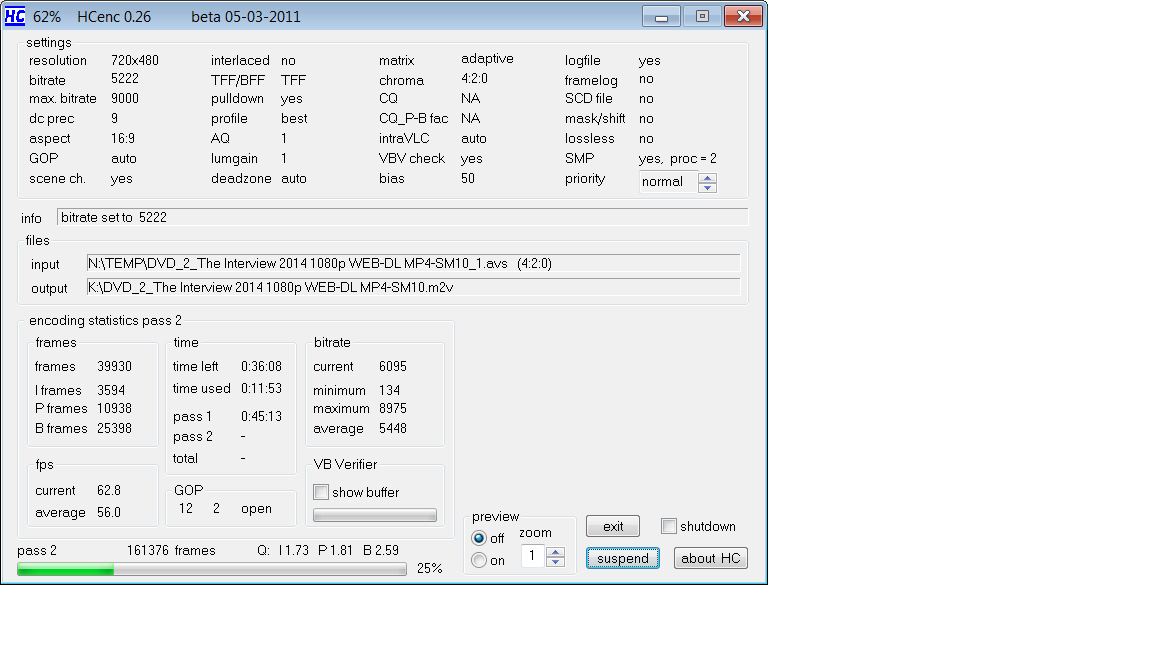

    I made sure to select HCenc 1-pass, then started program. 45 minutes later I checked and saw that it was started on the 2nd pass:
    Sure enough, the log indicates that it executed HCenc 2-pass:
    <1/25/2015 10:28:27 AM>
    START VIDEO ENCODING OPERATIONS
    Encoding Profile: HCenc VBR 2-pass
    Target Video FileSize: 4190.1 MB
    Encoding Parameters: -ini "N:\TEMP\DVD_2_The Interview 2014 1080p WEB-DL MP4-SM10.HCenc.ini"
    HCenc ini file:
    *INFILE N:\TEMP\DVD_2_The Interview 2014 1080p WEB-DL MP4-SM10_1.avs
    *AVSRELOAD
    *OUTFILE K:\DVD_2_The Interview 2014 1080p WEB-DL MP4-SM10.m2v
    *LOGFILE N:\TEMP\DVD_2_The Interview 2014 1080p WEB-DL MP4-SM10.HCenc.log
    *MAXBITRATE 9000
    *BITRATE 5222
    *PROFILE BEST
    *ASPECT 16:9
    *PROGRESSIVE
    *TFF
    *PULLDOWN
    *BIAS 50
    *DC_PREC 9
    *MATRIX MPEG
    *AQ 1
    *LUMGAIN 1
    *SMP
    *PRIORITY NORMAL
    *DBPATH N:\TEMP
    *WAIT 2
    I'm open to any suggestions. Thanks.
  27. Member
    Mar 2008
    Where did you select 1-pass HCenc ? It should be on the edit title/video tab
    once the project is loaded, NOT the preferences tab.

    and for the little lock icon/button, if you decide to keep it(?), perhaps something like these graphics (or simply a checkbox)...
    Image Attached Images
