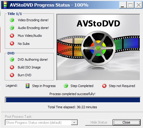

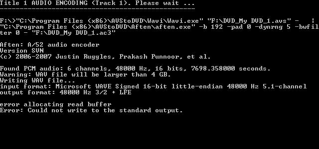

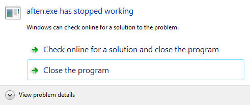

  6. Errors
Name:	aften error.jpg

  7. And more. There was the Mediainfo error about framerate but I think the fix is above. And that's it.
Name:	2nd Cmd prompt error.jpg
Name:	Final error.jpg
  8. Member manolito's Avatar
    Jun 2009
    Germany
    Hi mistycat,
    going over your log files the main difference is that version 2.75 uses FFMpegSource for audio decoding while version 2.80 uses DirectShowSource and fails miserably.
    When AVStoDVD is set to use A2DSource for audio, it will try DirectShowSource first. If this results in an error, it will switch to FFMpegSource.
    I suppose in version 2.75 you had ffdshow installed as your DirectShow filter package. And obviously ffdshow cannot handle your audio at all, so switching to FFMpegSource solved it.
    With version 2.80 you had LAV Filters installed, and the LAV audio decoder thought that it could handle the audio. So there was no error and no switching to FFMpegSource. But obviously the LAV audio decoder failed.
    A possible workaround for version 2.80 would be to force FFMpegSource for audio (under Preferences / AVISynth).
    Another thing which I find puzzling is that with version 2.80 Wavi thinks that your audio has 6 channels. Is your LAV audio mixer enabled and set to 6-ch? Normally AVStoDVD should adjust the audio mixer setting automatically at runtime and set the mixer to stereo in your case. No idea why this does not work with your source file...
    Cheers
    manolito

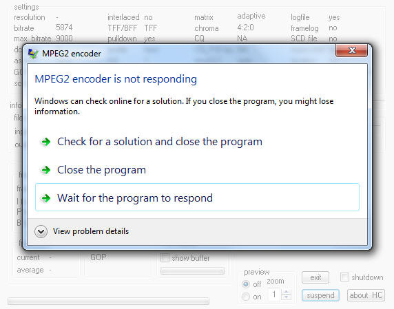

  15. What I see if I don't ignore Henc for 10 minutes or so, won't see this and will eventually work if I don't try to close it
