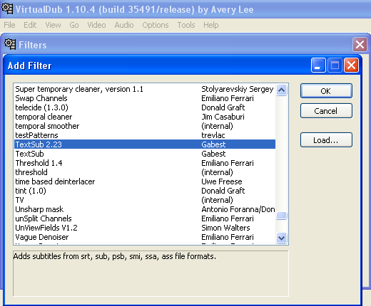

    Originally Posted by _MrC_ View Post
    kodec, could you elaborate better your request? What TextSub options are you referring to? A screenshot or a ste-by-step description can help a lot.
    Sure, gladly, here goes for everyone; as said, I have tried all the other plugins and to my liking this is the AVStoDVD of subtitling: simple, effective, enough detailed, fast and flawless in what it aims to be, similar options that I'd like to see in AVStoDVD more than anything, if at least partially possible:

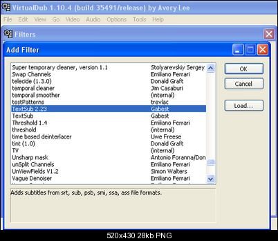

    1. After installing VobSub 2.23 there is a textsub.vdf plugin in the VobSub directory, which you can copy into the VDub plugin directory and there it looks something like this:

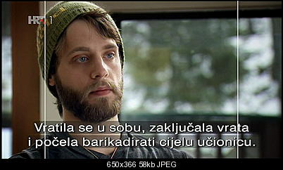

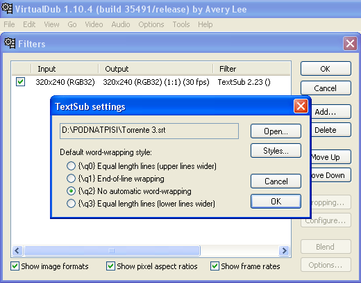

    2. First line of flawless TextSub options during selecting subtitles look like this (the resolution settings in the window underneath are irrelevant now of course):

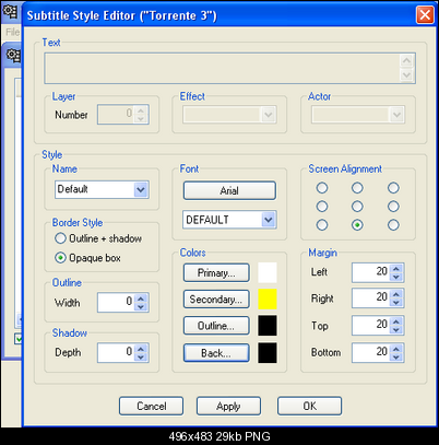

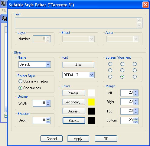

    3. Then there is the second line of options activated by "Styles" button, the most important for me being the flawless, brilliant, fantastic opaque box:

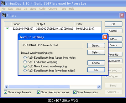

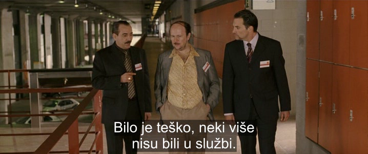

    4. The resulting .avi would look like this:

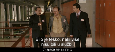

    5. Which is almost identical to the public TV in my country, probably easiest subs on the eyes (the following last pic); I'd say that for my liking pic 4 I have created are even better, because they are not streched.
