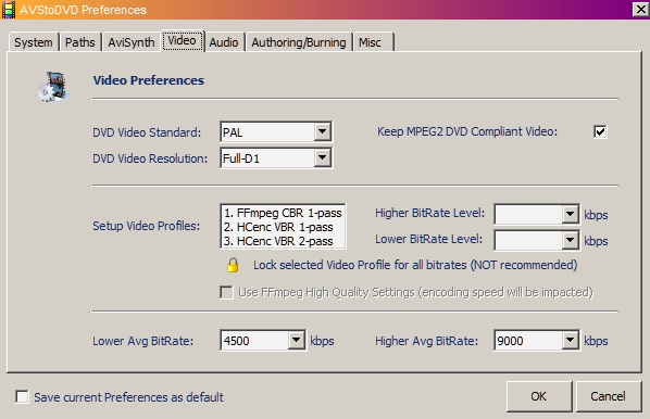

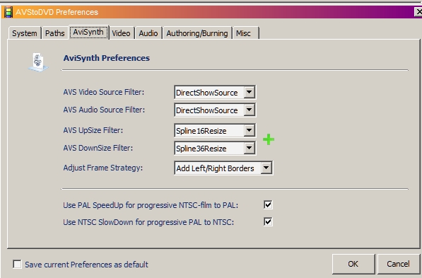

    Thanks. I've tried the FFMpeg setting in the Avi Synth section of AVSTODVD without luck, but how do you enable Safe Mode? I don't see a setting for Safe Mode in AVStoDVD

    The option is under "View/Edit Title Settings". You have to disable auto mode first.
    Cheers
    manolito

  20. Please ignore the above. i figured out what you meant, but.......... when I set it to safe mode it automatically resets itself to FFMpgeg 1 pass & won't read the video.
    Sep 2005
    Darkest Peru
    Click the "Save current Preferences as default" (at the bottom) before clicking OK. It'll save those settings.
