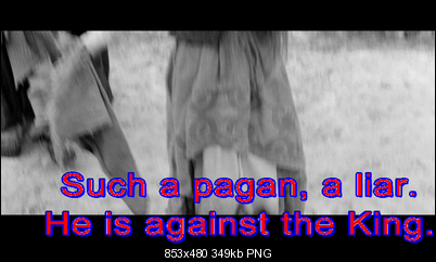

  6. Member Seeker47's Avatar
    Jul 2005
    Originally Posted by _MrC_ View Post
    AVStoDVD is a 32 bit application and requires 32 bit ffdshow (or other 32 bit directshow codecs) to work properly, as explained in Help/FAQ/General/Q1.2. It is not so complicated, if you read the documentation.
    Hi _MrC_,
    I finally replaced the installed 2.7.3 with 2.7.5. Hopefully everything I would need is there, incl. Haali & ffdshow. 2.7.3 had been working pretty well, with quite a few jobs processed. I may have previously done some config. you had suggested on ffdshow settings (?), and may now have to revisit this, to make sure that is still in effect.
    My 2nd.-time-around question stems from the prior posts # 1186 - 1187. Just had this happen again, once more with AVC inside of MKV. (That's why I mentioned the ffdshow settings.) However, I apparently cured the audio problem by temporarily changing the AVS audio settings from FFMPEG back to Wavi+Aften, and Channels from 1.0 to 2.0. The rapid-speed issue on dialog and music seem to have gone away, upon the next job processing pass. However, something else unwanted also crept in. The AR may have changed, to a rather squeezed, overly letterboxed one. I'll have to take another look at the original source (*) in order to confirm this. Another bad side effect was that formerly normal-sized, white subs turned purple, and ballooned up in size. (Check out the snapshot image.)
    * Let me back this account up a bit. In a previous VH query that was never adequately answered, I had inquired about how to go about splitting a very large source with subs into 2 or more parts, because multiple DVD-9s would be required, in order to retain the best PQ. (My otherwise preferred dividing tool had been the Re-Author mode in DVDSHRINK, but when you try to feed in something larger than around 9 or 10 Gb., this older program just chokes and dies. Ditto for dividing with DVDFab. I'm referring to the DVD-format results here -- obviously not the raw source-file.) In this particular case, where the MKV carries its own subs inside, the solution I found is VideoSplitter, and this works fine. But where there is only a separate .SRT file, this would not be useful, because the subs would have to be divided and totally redone separately, with new and adjusted timecodes, per the divided video files. That's why I can't just suppress the internal EN subs in AVS and use an external .SRT. Anyway, I'd clearly prefer to get back to the look of the original source subs, as they appeared when this was played in VLC.
    Enjoy your vacation !

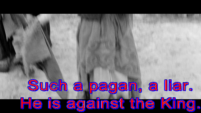

  28. Member Seeker47's Avatar
    Jul 2005
    Hi Seeker47,
    as usual you deliver a "wall of questions" as well as Deep Purple delivers their famous "wall of sounds"...
    Let's try to address issues one by one: do you prefer to start with the audio speed up or the video DAR or the subs? About subs, start taking a look at Help/FAQ/Subtitles/Q5.6
    Hi _MrC_
    (I thought it was the record producer Phil Spector who originated the "wall of sound".)
    On the subs, it was the overblown size -- as in that snapshot -- which was much more objectionable than the color, and this FAQ item did not address that.
    Yes, I still want to gain a better understanding of ALL the factors that may lead to that audio speedup, and if the AR is inadvertently changing on me in the course of running a job, I want to be able to better control that also.
