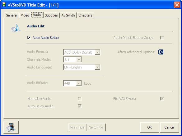

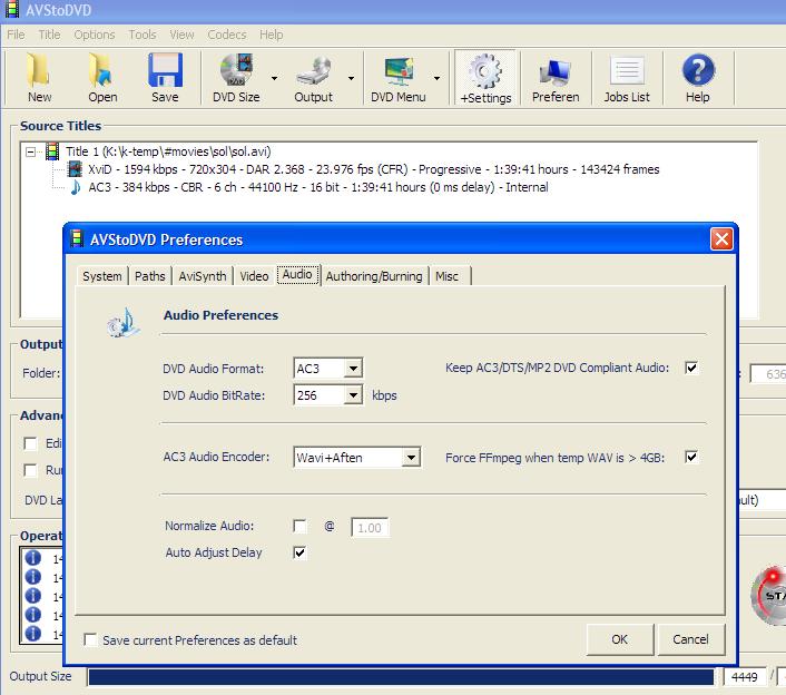

    Hi MrC,
    the program want's to re-encode my audio - 6-channel @ 384 kbps not valid spec?

    @davexnet
    Your audio is not compliant because the sample rate is 44100 Hz. DVD needs 48000 Hz,

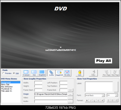

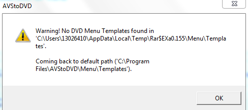

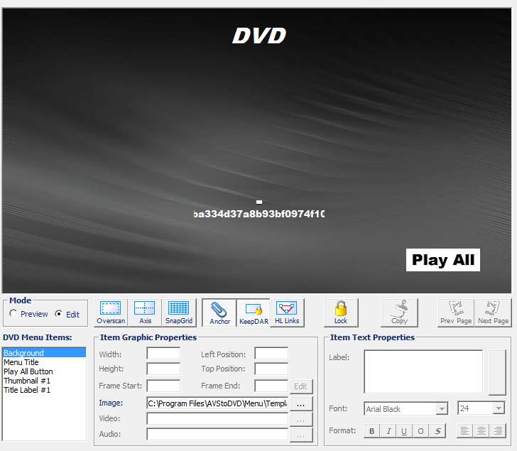

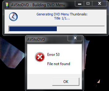

    Ok I am getting this errors while using AVStoDVD. When I click on the menu, it gives me this message.
    [Attachment 26519 - Click to enlarge]
    Then I got this error,
    [Attachment 26520 - Click to enlarge]
    and it hangs when loading the menu editor.
    [Attachment 26521 - Click to enlarge]
    What's wrong with the software?
    PS: This error pop out with both the installed version and the portable version.

  18. @wildsharks
    - open AVStoDVD
    - go to 'Preferences'/'Path'
    - select a valid 'Menu Templates Path'
    - save current Preferences as default
    - start again your project
    if it does not work, reset AVStoDVD settings with 'Options'/'Restore Default Preferences'

    Looks like I have to reset the preference every time I reinstall the software. Anyway, how do I delete "DVD menu items" and add my own items?
    You don't. You can edit the properties of the different menu items, but you cannot delete them and add your own items.
    If you need more menu creation power, use DVDStyler or other advanced authoring packages.
    Cheers

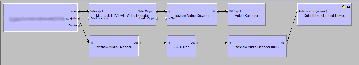

    @wildsharks
    use the 'Codecs'/'Build DirectShow Filters Graph' to see if the video decoding path is ok or messed up. Post here the screenshot you get.
    Bye
    MrC

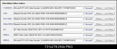

    Originally Posted by _MrC_ View Post
    @wildsharks
    Here's the graph.

  28. Originally Posted by wildsharks View Post
    OK, both the video and audio paths show directshow filters redundancy.
    Go to 'Codecs'/'Preferred DirectShow Codecs Setup' and select ffdshow for video H.264/AVC and for audio AC3. Then verify with the filters graph tool that only ffdshow is used.
    For system cleanliness, I suggest you to uninstall AC3Filter as well, that is totally unnecessary if ffdshow is installed.
    See Help/FAQ/General Q1.5
    Bye
    MrC
    AVStoDVD Homepage

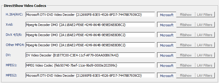

  29. Member
    Nov 2013
    Planet Earth
    I can't select the ffdshow. When I select that option, it tells me that my ffdshow is outdated. So I installed the latest version and now, it does not even give the option to select it.
    PS: Ok I don't know what's wrong with the software. I had to uninstall everything, install the ffdshow (64bit)(latest version) FIRST, and then install AVStoDVD with a built in ffdshow(32bit)(older version). Only then I can select my ffdshow. Seems very complicated here.
    PPS: I don't know why the selection always goes back to 'Microsoft'. There was no 'OK' button to save my settings so I just close the setup window. When I click the codecs set up again, it automatically goes back 'Microsoft'. What's wrong here?
