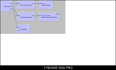

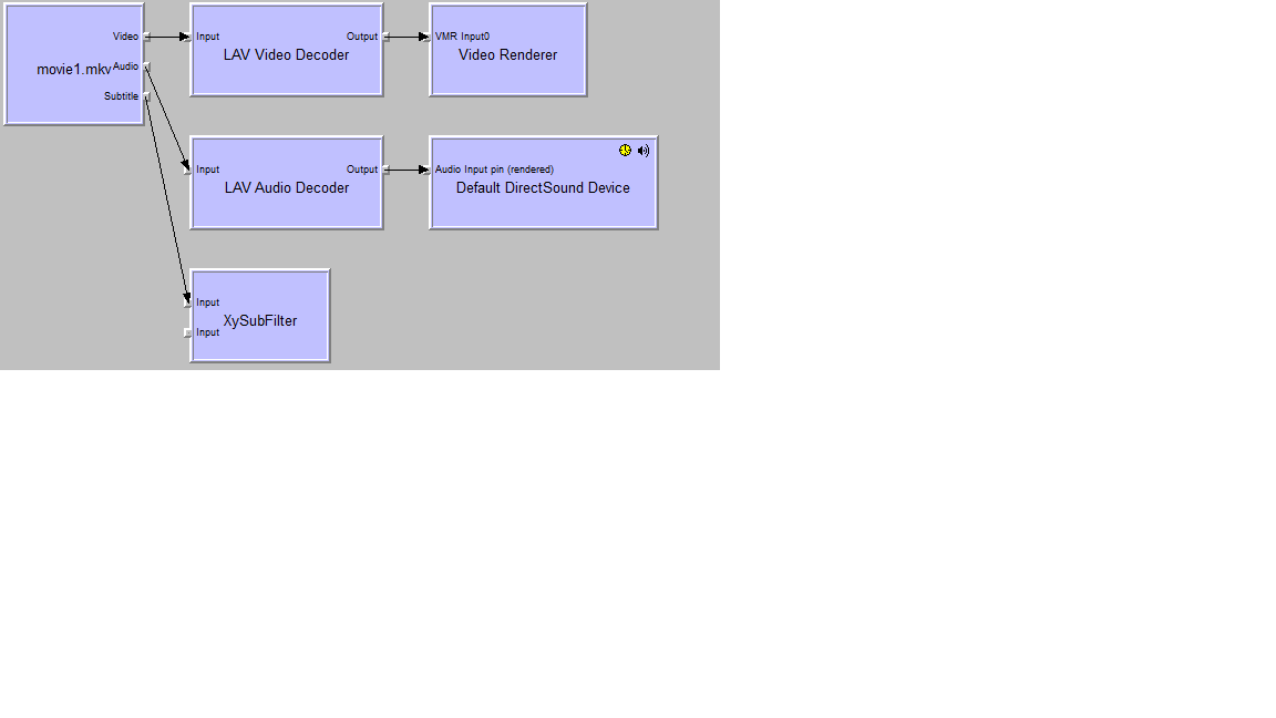

    Hi, MrC. I've just belatedly uninstalled 2.7.3 and installed 2.7.4, and that reminded me of a request I've been wanting to make. Would it be simple to add the ability to keep your settings when uninstalling and/or the ability to export settings to a file so they can be imported into a new installation?

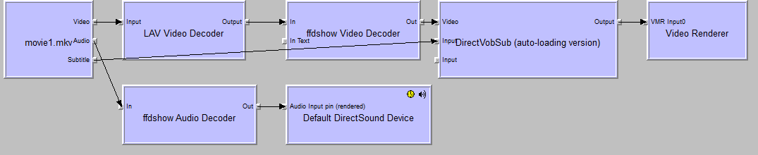

    Managed to get this hope there is enough info MrC thank you.
  3. @Calidore
    actually when you uninstall (using the uninstaller) AVStoDVD, you are asked to keep or to delete your Preferences in the Registry.
    @mike252
    well, it's a mess... uninstall either LAVFilters or ffdshow, it is not necessary to keep both of them... I would suggest also to deactivate (or uninstall) DirectVobSub, because otherwise you will get the subs hard-encoded in the output DVD.

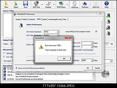

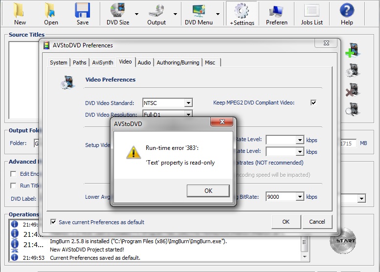

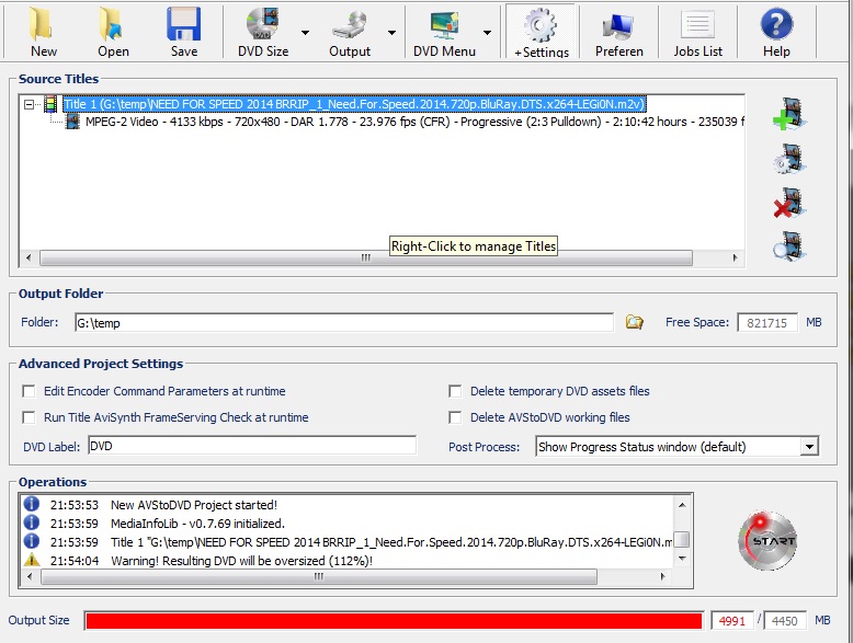

    @MrC
    coming up with some issues in the latest stable version and 2.7.5 alpha version. here are some screenshots. Click image for larger version
ID:	26488Click image for larger version
    the run-time error comes when i try to change hcenc settings by clicking on 2pass option. that error pops up as soon as i click on 2pass. i have avstodvd.exe set as winxp compatible and it runs as administrator by default. the other screen shot shows the wrong file size at the bottom. this is a m2v file made by avstodvd. when i load it in avstodvd it says it is too big. but the resulting dvd that got made with this m2v file the first time was not too big. also at the bottom it says it is longer than the movie actually is. at the top where you see the file it shows it's right run time. my pc is windows 7 64bit ultimate. have all the dependent codecs updated.

  27. @tebugg
    about the runtime error 383, when you select one of the Video Profiles in 'Preferences'/'Video', AVStoDVD load the bitrates levels from the AVStoDVD Windows Registry Key. It may be that the AVStoDVD regkey in your system is messed up. Just use the menu command 'Option'/'Restore Default Preferences' to reset the AVStoDVD regkey. You should not get the error 383 anymore.
    About the m2v filesize misreading, just ignore the warning message. It is not a show stopper. Meanwhile I will deepen why it may happen (MediaInfo reading wrong m2v video bitrate?).

  29. Member
    Feb 2011
    kalamazoo, michigan
    Originally Posted by _MrC_ View Post
    @tebugg
    Bye
    thanks MrC, the default reset did indeed stop the runtime error.
