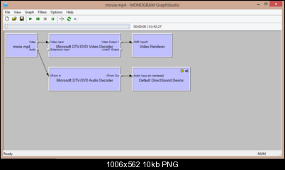

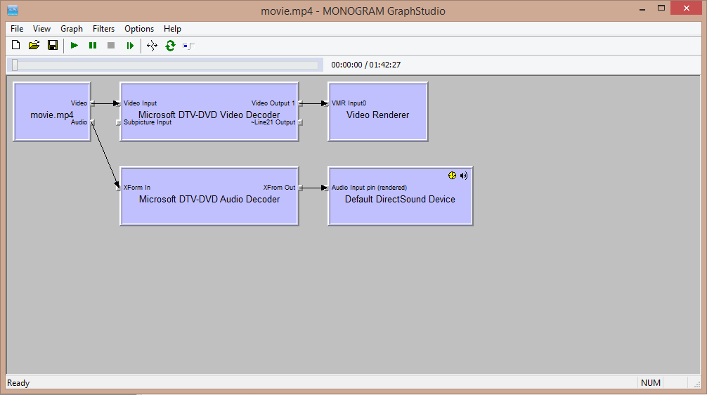

  21. @KevinSartori
    does the issue happen with specific input formats or with every sources?
    What about the directshow decoding chain? Post here a screenshot of one graph sample ('Codecs'/'Build DirectShow Filters Graph').
    Bye
    MrC
    AVStoDVD Homepage
  22. Member KevinSartori's Avatar
    Feb 2009
    It happens with every video file I've tried, including MKV and MP4 files. I clicked on Make Graft Screenshot, but I couldn't figure out where it put the file! I ended up doing a screen capture.
    I know that Microsoft DTV-DVD Decoder isn't right, but it never caused problems before. When I tried using ADVANCED Codecs for Windows 7 and 8 to fix the issue, there were options that let me disable the Microsoft Decoder and then choose either FFDShow or LAV instead, which I confirmed with GraphEdit. Unfortunately, this didn't fix the problem either. Since it didn't make a difference either way, I uninstalled ADVANCED Codecs and went back to using the FFDShow that installs with the AVStoDVD 2.7.3 installer.

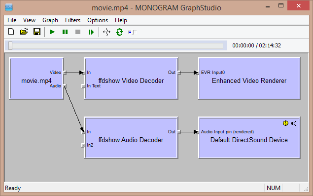

  23. Originally Posted by KevinSartori View Post
    [Attachment 23393 - Click to enlarge]
    Just another try to double check it is not a codecs issue: go to 'Codecs'/'Preferred DirectShow Codecs Setup' and select ffdshow for all video and audio codecs. Then go back to 'Codecs'/'Build DirectShow Filters Graph' to verify the change is effective. If everything is ok, restart the project.
    Bye
    MrC
    AVStoDVD Homepage

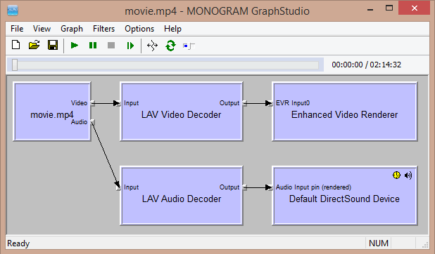

  24. Member KevinSartori's Avatar
    Feb 2009
    I uninstalled FFDShow and Haali, rebooted and ran CCleaner. Then I installed ADVANCED Codecs for Windows 7 and 8. Using that, I was able to disable Windows Media Foundation and Microsoft's Audio Decoder. I set the merit on FFDShow to default:
    The problem persists. I also tried lowering the merit on FFDShow and enabling the LAV filters, but unfortunately had the same result.
    When I first start HCenc on this particular file, it's running at close to 150fps. By the time it hits 25% done, it's dropped to 90fps. With the LAV filters enabled, it actually completed the first pass, but then crashed at the start of the second pass.
    It seems like the codecs are fine and AviSynth just slows down and fails, but I'm just guessing. Are there any logs generated that would be useful? Thanks again for all the help!
