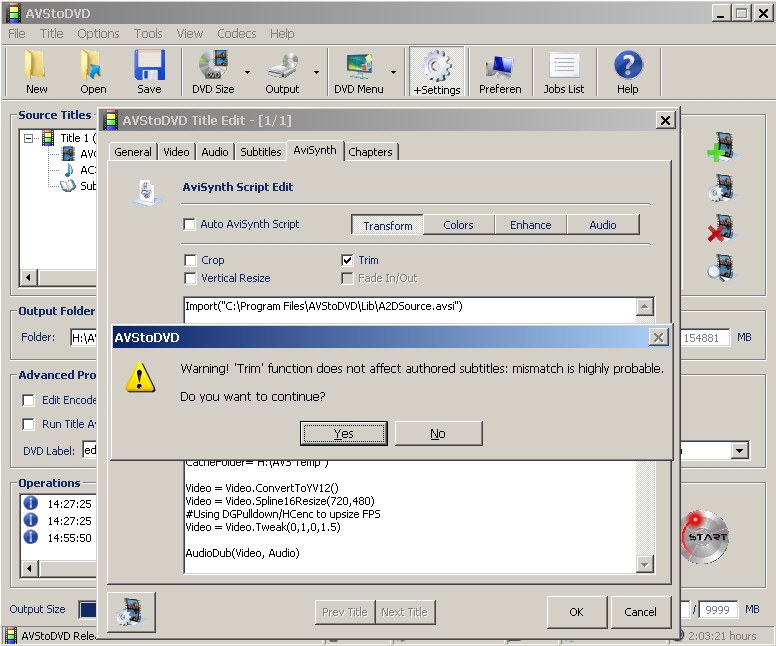

I would suggest you to play with the contrast.
- Go to 'Edit Title'/'AviSynth'
- Toggle off 'Auto AviSynth Script'
- Select 'Colors'
- Toggle on 'Tweak'
- Use default values for Hue, Saturation, Brightness. Start with 1.5 for Contrast (default is 1, but scale is logaritmic).
To speed up testing, encode a small difficult portion, using the 'Transform'/'Trim' option to select it.
Bye -
I staggered my way thru it "OK"...
One problem is that the preview video cannot keep up. I only get 1 new frame every 1-2 minutes. But that's enough to see that changing the Avisynth contrast setting to 1.5 helps a lot! So I'm pretty sure that will fix it.
So I decided to try to solve the subtitle font size problem at the same time but get a popup which indicates that Transform-Trim won't work correctly with subtitles (graphic below). So I'm not sure how to proceed.
What I probably need to do is take a 2-3 minute clip from the original .mkv, but I don't know how...
