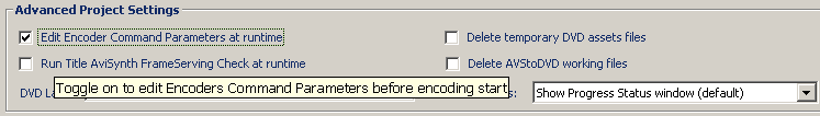

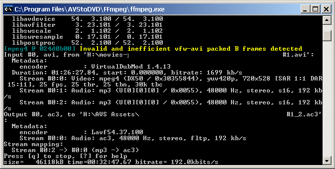

    I'd also like to report (again) about a spontaneous change in the Advance Project Settings which happened during a conversion run with the prior AVStoDVD 2.7.1 version. I know that I definitely did not do this with an accidental mouse click nor a keyboard mishap. I didn't even have access to the main AVStoDVD window during the conversion, but then when it appeared afterwards this box was checked. Something must have done it automatically during the conversion process. I wasn't doing anything unusual, just converting an .avi as I've done many times before, which usually doesn't cause this to happen. My only clue is that it reported some kind of error during the audio conversion and asked me if I wanted to use a different backup process/program (or some such), to which I agreed (because I had no idea what was correct). Graphics below: AVS-settings, AVS-audioerror

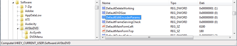

  6. @JohnnyBob
    very very strange. Make sure that the Windows registry key HKEY_CURRENT_USER\Software\AVStoDVD\DefaultEditEncoderParams is set to 0.
    Then open again AVStoDVD and verify that the option is unchecked.
    Bye
    MrC
    AVStoDVD Homepage

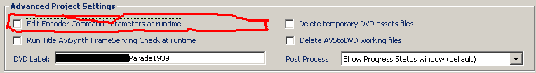

  7. ...C O P Y L E F T JohnnyBob's Avatar
    Feb 2007
    Earth
    Yes, that registry key is set to 0, but the box is still checked in the AVStoDVD window. Note that I still retain the original AVDtoDVD window from that conversion run, haven't closed/reopened it, etc.
    P.S. Then... I closed the AVStoDVD window, reopened it, and that box remains checked. The registry key changed itself in the process, was then set to 1.

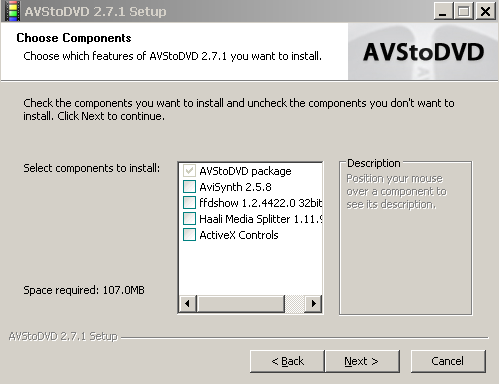

    I'm still hesitating because the AVStoDVD 2.7.2 installer provides a later version of ffdshow, but doesn't detect/offer to update the older version from my prior installation. So I'm wondering if I should uninstall the older ffdshow first, or check the box and install the new version on top of the old(?). I'll also need to do some research first to try to find any special settings which I might have made (but can't remember)...
    P.S. researched and found my references/notes to the special settings required in ffdshow, so will uninstall it first as the cleanest way...

  16. 1.3.4500 ffdshow release note from official download page:
    This is a small update to the 1.2.4422 release. The Intel QuickSync decoder has been updated and a few subtitle bugs have been fixed.
    No big impacts on AVStoDVD.

  17. ...C O P Y L E F T JohnnyBob's Avatar
    Feb 2007
    Earth
    I've only run 1 conversion with the new AVStoDVD v2.7.2 so far, a .mkv conversion, and the "Edit Encoder Command Parameters at runtime" checkbox was *not* checked afterwards. That anomaly has only happened about 1 time per 10 conversions in the past so might be difficult to troubleshoot.
    My only hunch comes from playing around with the main AVStoDVD window and clicking various places with the mouse, I notice a possible GUI graphics involvement. That checkbox can be selected by clicking anywhere along that line to the right, within the area approximately enclosed in the red rectangle (see picture below). It would be more precise to limit the active clickable area to be within the checkbox's xy coordinate perimeters, a much smaller area.

  27. Member Seeker47's Avatar
    Jul 2005
    Portable means the program runs right out of its folder, no Windows installation necessary.
    This is not possible for everything, some programs (such as the four you mention) need to be installed
    since Windows sets the files in their correct locations, and creates the necessary registry entries
    so they work, etc,etc. Because of this "setup" dependency, they can never be "portable".
    This is more Windows 101 than anything to do with those specific programs.
    I've seen some portable programs that make use of "pseudo" Registry entries (within the portable app's own tree structure) that engage at runtime and seem to fake out the requirement for this. And they run just fine -- from a thumbdrive, etc. Even where the thumbdrive boots up a Bart PE type of environment.
    When in Las Vegas, don't miss the Pinball Hall of Fame Museum http://www.pinballmuseum.org/ -- with over 150 tables from 6+ decades of this quintessentially American art form.
  28. Member
    Mar 2008
    You may be right - but then wouldn't you have to contact the authors of FFDshow, Haali, etc,etc in order
    for them to create, let alone consider such a version? MrC certainly has control over his own access to the registry,
    but in respect to his program only.
