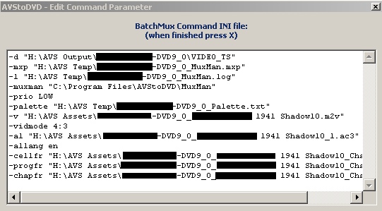

  12. ...C O P Y L E F T JohnnyBob's Avatar
    Feb 2007
    Earth
    unwanted popup to edit command index, press x when finished
    This just started the last couple of conversions. I never saw it over the prior 20+ conversions. Sorry I don't have an image to post but it appears to be a copy of an .ini file. I press x then the conversion proceeds normally but I get another of these unwanted popups towards the end. I haven't changed any settings or software. How do I get rid of it?
    P.S. The disadvantage is that the conversion is no longer an automatic process. Previously when I clicked the Start button, it proceeded to the final result without requiring any input from me. Now it stalls with these popups and won't proceed til I click the x. Very inconvenient...

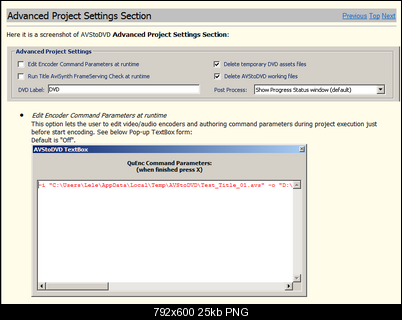

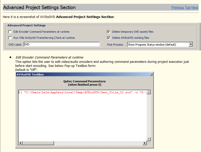

  13. Originally Posted by JohnnyBob View Post
    You had. But the solution is easy: toggle off 'Edit Encoder Command Parameters at runtime' from Advanced Project Settings of main AVStoDVD window.
    Bye
    MrC
    AVStoDVD Homepage
  14. ...C O P Y L E F T JohnnyBob's Avatar
    Feb 2007
    Earth
    Bye
    I had "what"? I repeat that I did NOT change any settings, so whatever happened was some kind of instability of the software. I woke up this morning after leaving a long conversion running only to be greeted with yet another of these unwanted popups...then after I clicked the x, muxman started its run to complete the job. Of course after it's finished for this run, I'll go in and edit the advanced settings as you suggest. The question then becomes - how do I prevent this problem from happening again in future?

  15. Originally Posted by JohnnyBob View Post
    And I have already given you the answer: toggle off 'Edit Encoder Command Parameters at runtime' from Advanced Project Settings of main AVStoDVD window.
    A comment of mine: you can save a lot of time by reading in advance the AVStoDVD Help section. It explains a lot of the software features, e.g. the option you have activated, with a random mouse left-click, I guess.
    Bye
    MrC
    AVStoDVD Homepage

  17. It would do you a lot of good.
    Bye
    MrC
    AVStoDVD Homepage

    Jan 2007
    he gave you the answer
    just look at advance settings
    and change the 'edit command line parameters'
    av2dvd is behaving as this comd has been checked marked/turned on
    turn it off, and you will be fixed
