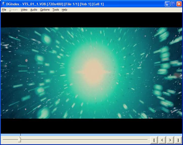

    MrC is the definitive source, but in his absence , I'll attempt to help.
    I believe the DVD aspect ratio should be either 1.778 or 1.333. I don't know how this came about,
    possibly a result of how you re-authored the files.
    In the AVStoDVD project window, override the A/R by right clicking the title,
    edit source title info/video display aspect ratio
    and set it to 1.778
    Before you do this you can check to make sure the source title set is good.
    Open DGindex.exe manually, (it's in the AVStodvd program folder subfolder DGindex)
    and open one of the source VOB's in the title set. You should see a window simliar to the following,
    note the large letterboxing.

    The original PAL main movie plays with an aspect ratio of approximately 2.37 as verified by applying my trusty cm ruler to the monitor screen and measuring the actual height & width. That's without any editing by me. So that's the true aspect ratio of the main movie. After conversion from PAL to NTSC with AVStoDVD, the aspect ratio was changed to approximately 3.0 which makes all the people/objects appear fat. Things were squished together vertically.
    So I don't understand why you say the aspect ratio is 1.778 or 1.333, which is not the case. It's 2.37 for sure, or close to that number. The error of my measurement with a cm ruler is probably plus or minus 0.1 aspect ratio.
    However possibly 1.778 would be a "magic number" to enter as the aspect ratio to make the conversion come out correctly. I don't know, and it would take 11+ hours to run another conversion and find out. Or maybe I can extract a short video clip from the original for faster experimentation(?).
    I followed your instructions and opened some .vob files with DGIndex in the original PAL (unedited) movie and here's a sample image of what I get. It does not appear the same as the image you posted. It obviously has an incorrect aspect ratio, the people appear too tall and skinny. Is this helpful in solving the riddle?
    If it matters, I'm using an old 4x3 CRT computer monitor at 1280x768 resolution.
    Jan 2007
    my memory says you can't set that resolution 1280*768 on a 4:3 crt
    800*600, or maybe 1080*xx
    but IF you graphics card will let you do that, that is the reason it looks quished, because you HAVE squished it by putting too many pixels across the width of the screen
    try setting your display to 1080*800

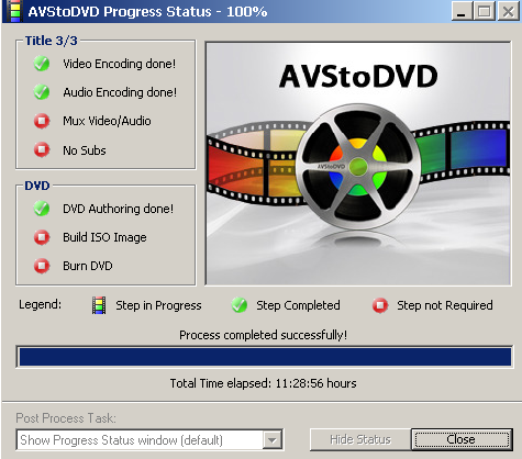

  17. ...C O P Y L E F T JohnnyBob's Avatar
    Feb 2007
    Earth
    My eyeballs tell me the aspect ratio is OK now for the abovementioned PAL to NTSC conversion after resetting it to the magic number 1.778. People look neither tall and skinny like a 7' Zulu tribesman nor squat and fat like a 3' gnome, but somewhere in the middle where most of us reside (i.e. fairly normal).
    The result is a 2.37 picture as confirmed by measuring with my trusty cm ruler on the monitor screen:
    24 cm wide / 10 cm high = 2.4
    31.75 cm wide / 13.5 cm high = 2.35
    The quality seems OK. It remains only to burn a DVD so I can watch this 98 min movie on my regular TV with a DVD player and a box of popcorn.
    But was it worth several days of effort and 24+ hours total computer run time to finally get it done right? I'm not sure. My main complaints are:
    Why didn't AVStoDVD do this AR juggling act correctly in the first place? (this isn't the 1st time)
    How can I avoid this sort of AR problem in future?
    Why does it take so long to convert?

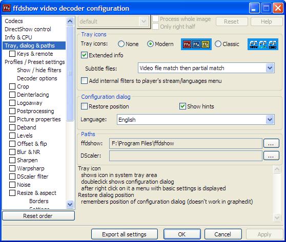

    Why so many icons on taskbar? Is this necessary? It makes it more difficult to use my computer when AVStoDVD is running...
  27. Member
    Mar 2008
    You can disable the FFdshow icons if you wish. You may have to disable for video and audio.
    using the appropriate FFDshow decoder config (found in the the FFDshow program group).
    Haali spliter can be turned off as shown, using the "media splitter settings " in the Haali program group.
    Those things appear when ever separate instances of them are used.
    Here's some screen shots.
  28. Member Seeker47's Avatar
    Jul 2005
    That's odd. I don't recall ever seeing anywhere near that many icons up at once from AVS, in a few years of using the program. And I never took any steps to eliminate some.

  29. ...C O P Y L E F T JohnnyBob's Avatar
    Feb 2007
    Earth
    davexnet's advice worked, down from a dozen to just 2...
