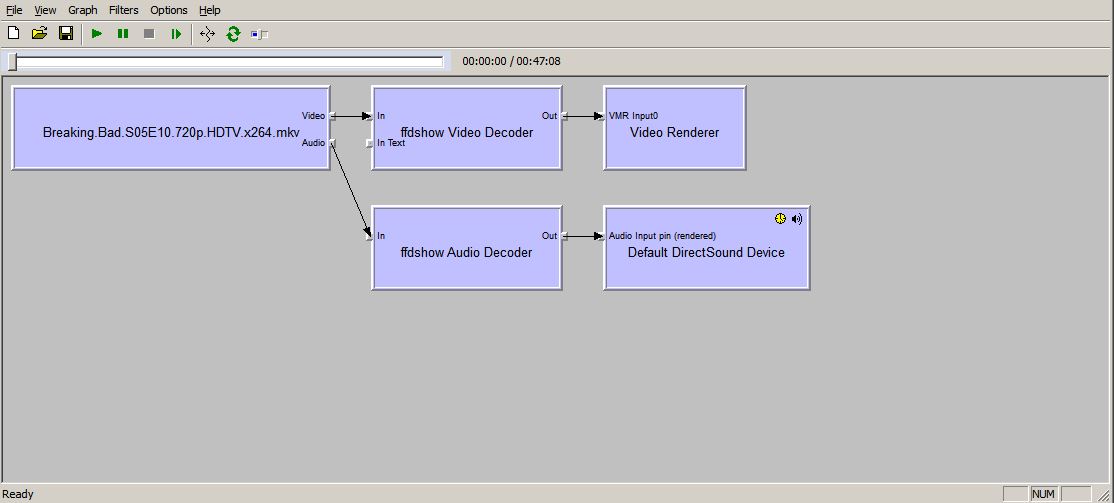

    Hi again.
    This is how my graph looks:
    LINK
    Will try your suggestion about Avisynth setting and get back.

    PS your graph is bad, the Microsoft DTV - DVD codec should not be present.
    (as you can see from the link I posted previously). retry the codec tweaker.
    IS this Windows 7?

  9. @FireWire
    your system is using Windows standard codecs (Microsoft DTV-DVD Video) to decode the video AVC/H264 track included in your MKV file, instead of using ffdshow. If you are using Windows7, you should download Preferred Filter Tweaker and select ffdshow as H264 decoder in the 32bit section. After that, try again with 'Codecs'/'Build Directshow Filters Graph' to verify that now AVC/H264 is properly decoded by ffdshow. If yes, retry again with the project.
    FFMpegSource is another option (thanks to Dave for the support aid ). But it would not solve the redundancy in the directshow video chain.
    Bye
    MrC

    Hi.
    I have set all available options in that tweaker to ffdshow. But not all codecs are possible to change to ffdshow. H.264 have options Microsoft, ffdshow, ffdshow(DXVA) and USE MERIT. I set that to ffdshow, is that right or should I set ffdshow(DXVA)?
    Do I need to reboot after changing these settings?
    EDIT:
    This is how my graph is looking now:
    LINK
    Everything looks ok now, doesn't it? But sadly it doesn't do anything about my problem. Still the same problem with tilted video. BUT I managed to make a DVD by using davexnet suggestion about changing the avisynth setting to ffmpegsource. Both DVD and the thumbnail video seems ok now.
    So I will live with that.

  12. @FireWire
    the directshow graph is ok now, with ffdshow decoding both the video and audio streams. I am a bit surprised that you still get the "oblique style" output. Go with FFMpegSource. FFMS uses libavcodec library (the one used by FFmpeg) to decode the video and audio streams. A2DSource is actually a mix of the available AviSynth source functions, including FFMS, but try to use DirectShowSource as first option, that's why I usually insist that the directshow decoding chain must be "clear".

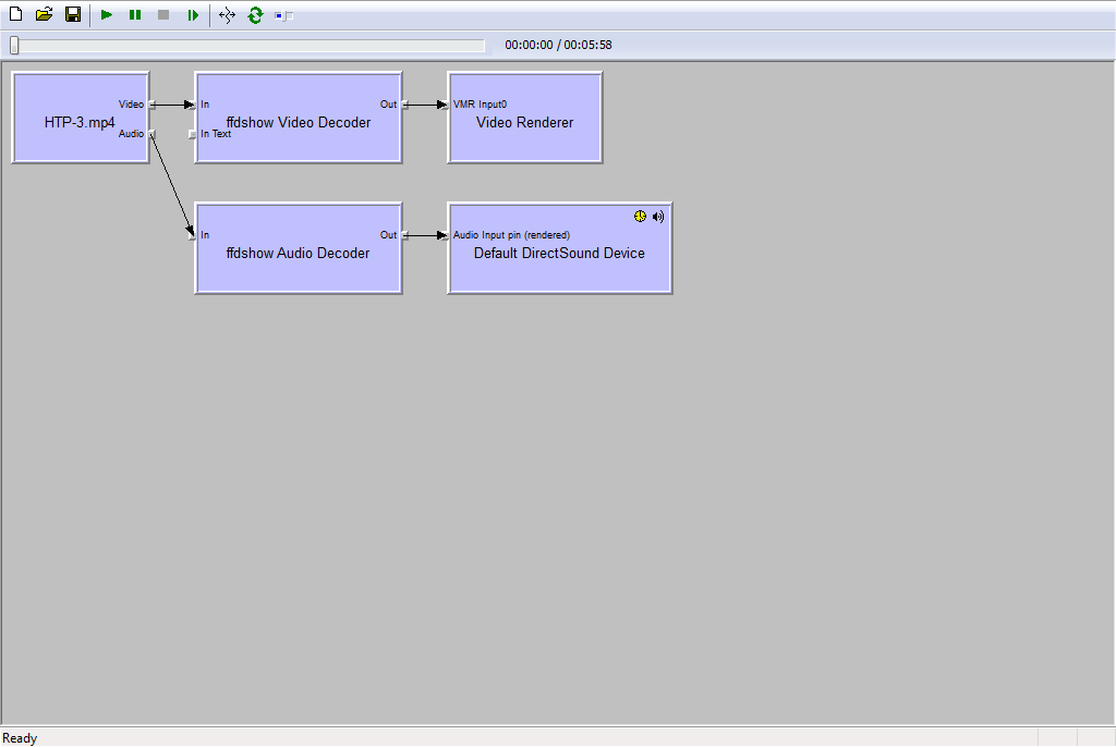

  16. Member Seeker47's Avatar
    Jul 2005
    Third try is the charm ?
    One more snapshot.
    I have now set just about everything in the 32-bit section to 'ffdshow.' Was that the right way to go ? What is meant by the choice "Use Merit" ? If / when I get the other system operational again (may have to resort to restoring a boot partition image from a few months back), will I be finding a comparable 64-bit config section in there ? I thought this had all been corrected before on at least one system, probably that one.
Name:	Vid-file Graph-3.png
    When in Las Vegas, don't miss the Pinball Hall of Fame Museum http://www.pinballmuseum.org/ -- with over 150 tables from 6+ decades of this quintessentially American art form.
    One more snapshot.
    Merit is a system of priority within the dshow mechanism. Whenever more than one filter can play a certain mediatype,
    the one with the higher merit is normally used. I would suspect (but I'm not 100% certain) that "use merit" would
    enable this priority system.
    It's not necessary for this purpose, just set it to ffdshow.
