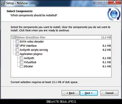

    Check these settings in FFDshow audio config :

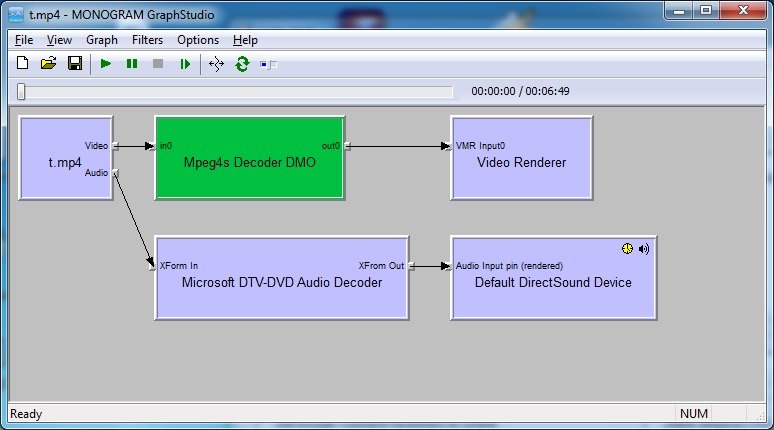

    Hi MrC,
    I tried to recreate this on my own Windows 7 PC, using an input file with 2-channel aac audio.
    I do have Haali splitter and avisynth installed, but not FFDshow. I ran the file through AVStoDVd and in my case,
    it finished without problems. So in what situation is FFDshow really required?
    He's the graph.

  8. When using a directshow-based approach, the encoder (i.e. Wavi) outputs a number of channels taken from the current filter output mixer setup. In case of Heathsideboy the output mixer is setup to 6 channels. We still do not know what directshow filter is being used by Heathsideboy system. Surely not ffdshow, because AVStoDVD adjusts its output mixer at runtime. We have 2 paths:
    1. understand what directshow filter is being used by Heathsideboy, hence instruct it to use a 2 channels ouptut
    or
    2. force Heathsideboy system to use ffdshow as directshow audio (AAC) filter
    I prefer the latter, because once that ffdshow is correctly configured, the system becomes (amost) rock solid.
    Bye
    P.S. A ffmpeg-based approach (the backup routine used by AVStoDVD) is instead independent on the directshow output mixer, BUT the audio quality is IMO a little worse.
    MrC
    AVStoDVD Homepage

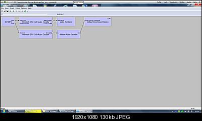

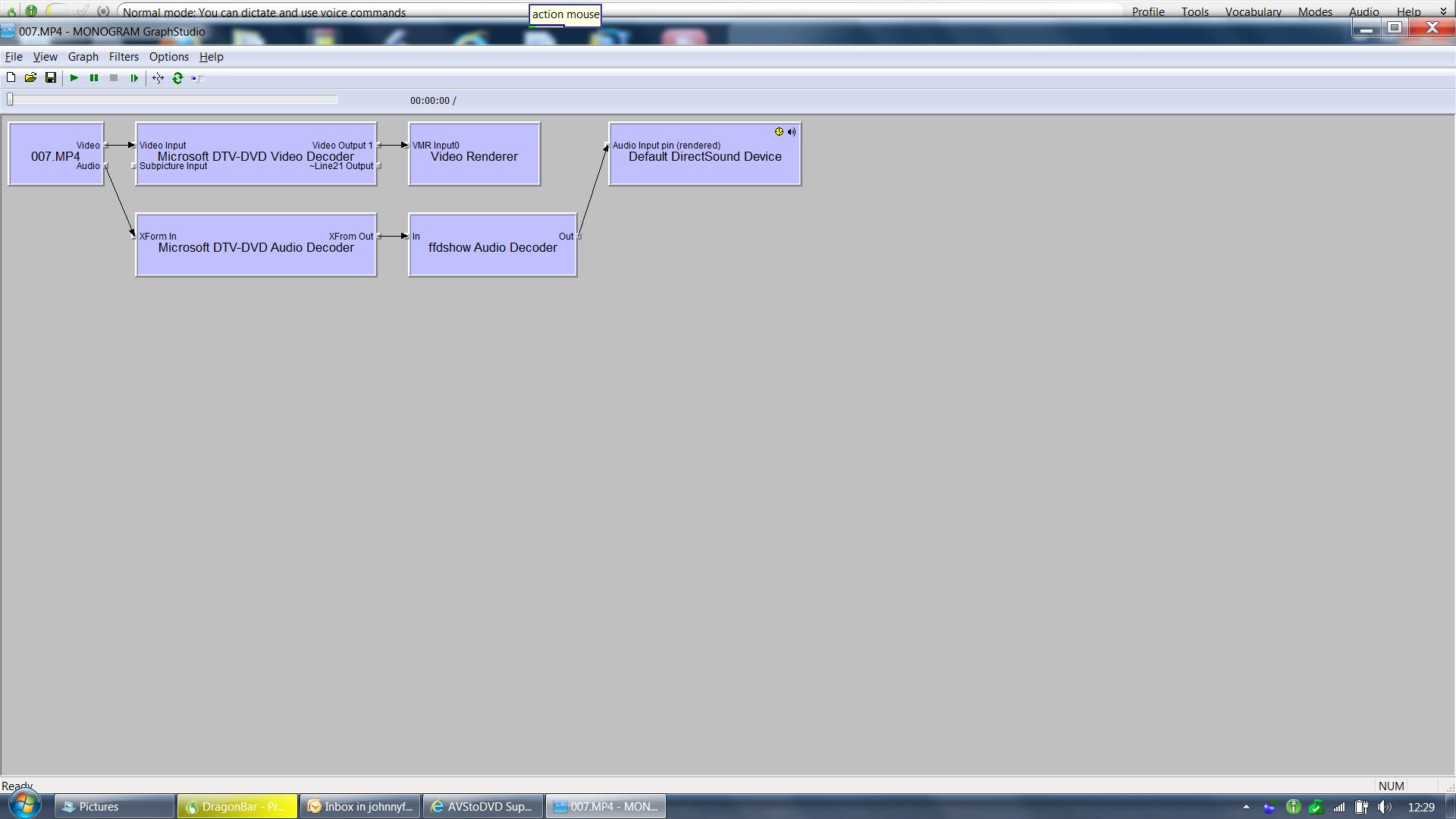

    Thanks for all your input and trying to help sort my situation out. I have posted the graph you requested, I notice that it is slightly different to the first graph I posted in one of my earlier posts. Hopefully you can tell me what to try next from the graph. I really want to get this to work and see decent pictures from the MP4's converted when burnt to disk.

  10. @HB
    see the audio path, there is a redundancy in the decoding chain: both Microsoft Audio Decoder and ffdshow are processing your audio track. Have you used Preferred Filter Tweaker to force Windows to use ffdshow instead of Microsoft?
    Bye

    MrC/ Heathsideboy,
    I noticed if you set the FFdshow audio configuration,
    codecs/uncompressed/all supported, you get the above graph.
    FFdshow is active, even though it didn't decode the audio. Is the FFdshow mixer available at that point?
    I tried to find out myself, but my internal setup is only 2-channel, and was unable to recreate the problem.

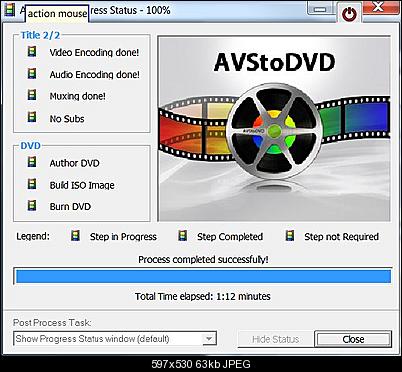

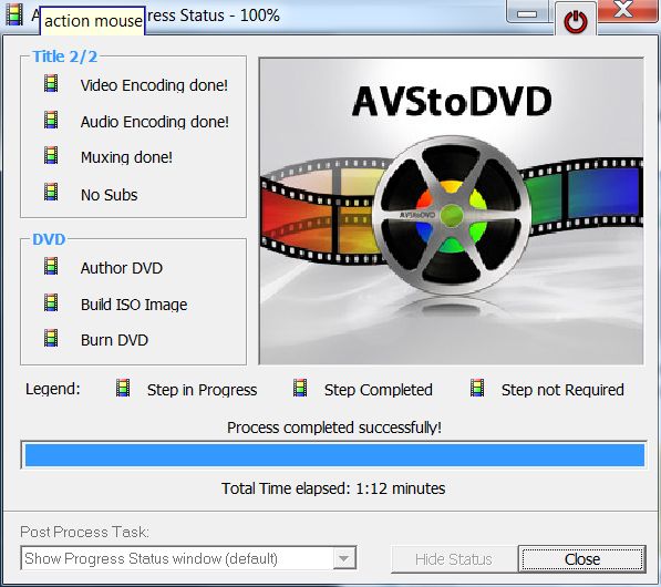

    I did what you suggested and put two MP4 titles into AVStoDVD as a test. I chose "Muxed MPEG2" as the output file and this time, after the first title had finished, I did not see the error as I did before the start of a new title being converted originally. It then brought up the screen as shown below telling me everything was a success.
Name:	Converted video and audio.jpg
    The only thing was, the converted MPEGs that were showing in my video library, when I clicked on one of them to see if it would play, the message came up "Media Player encountered a problem while playing the file" and the MPEG did not play. Any suggestions on this or is it meant to be like that?
    What do I do next in this situation? I have also attached my log for the conversion.
    HB
