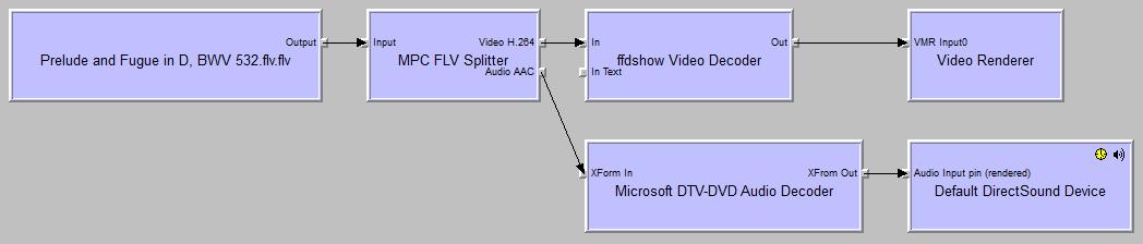

    I Converted a 600+ MB video file last night from .flv to MPEG 2. Something obviously went wrong during the encoding as the video came out very strange and distorted with everything shifted about 45 degrees to the right. I got an error message indicating that there was a problem with the audio (See log file below.) but no mention of a video problem. I viewed the 10 minute file and the audio is fine but as mentioned, the video was quite strange. I looked through the log file and saw nothing to indicate that there was a problem with the video, but maybe I just didn't recognize what I was looking at. In addition to the log file, I've posted a shot of what the video looks like. Any suggestions as to how to fix this problem would be very much appreciated.
    <8/19/2013 10:04:00 PM>

  18. @theewizard
    Do you have the possibility to replicate the issue on another PC? And remember, there's no need to go thru the whole encoding process, with release 2.7.1 you can easily test the DVD Menu output with the 'Full Preview' option.
    @crackerbear
    Thanks for the kind words. About the icons issue, take a look at Help/FAQ/GUI/Q2.6.
    @ganymede
    Could you please take a screenshot of 'Codecs'/'Build DirectShow Filters Graph' on the flv title?
    Bye

    ffdshow is not used, instead the standard Microsoft codecs (not the best...) are in use in your system. Have a look at: Help/FAQ/General/Q1.5
    Hi MrC,
    I downloaded what you suggested, chose ffdshow where necessary and tried again. Still I had the problem of no sound. What I have done is uninstalled AVDtoDVD and all the necessary components that go with it. Once I have reinstalled from your homepage, I will try it again and let you know the outcome. I'm hoping that this will sort it out.
    On another note, I believe I chose 'ActiveX' when downloading, I may be wrong here. With ActiveX live, I am finding on some programs, error messages are coming up saying do you really want to use 'ActiveX' controls? The computer then goes on a go slow until I get rid of these security warnings. Do I really need ActiveX? How can I rid my computer of this?
    HB

    MrC,
    I've attached a picture of the graph that you requested. For whatever it may be worth, I encoded that same .flv file with Mediacoder and it worked just fine. No problem. But I wanted to normalize the audio, so I decided to use AVStoDVD instead since Mediacoder has no ability to normalize the audio.
Name:	Codecs_Build Directshow_html_6ff93112.jpg
    ganymede

    @ganymede
    the audio section is being decoded by Microsoft Audio Decoder and not by ffdshow. Take a look at Help/FAQ/General/Q1.5. Moreover I would suggest to install flvsplitter.
    Bye
    MrC
    AVStoDVD Homepage
  29. Member
    Jan 2003
    Massachusetts
    MrC,
    I went to the page you mentioned and read the information there but I'm afraid I wasn't able to really make use of it. I looked at the ffdshow configuration page but I wasn't able to figure out how to tell it to decode the AAC audio from the .flv file. Secondly, I did download the flv splitter there but couldn't figure out how to use it since Windows says it can not open the file. If you could help me with either one (or both) of those, it would be much appreciated.
    ganymede
