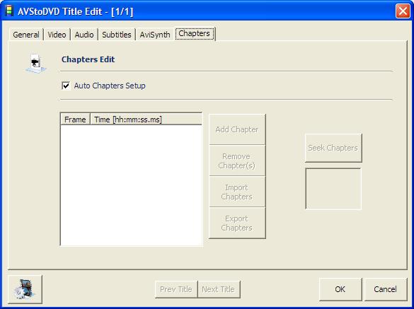

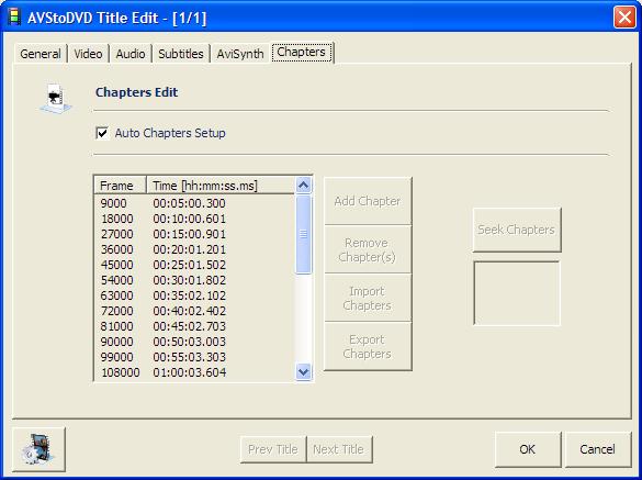

    Hi MrC,
    even with your latest 2.70 release, using trim and/or saving the project and reusing,
    the chapters disappear. Same as I mentioned earlier - To get the chapters to appear, I deselected and re-selected
    "auto chapters setup"
    thanks,
    Dave

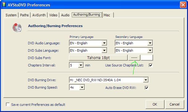

    Jun 2013
    Canada
    Hi
    I am new at this, but I really wanted to convert some of my mkvs into dvd so I could watch it on my tv. I already tried using the program for a video with no subs, and it worked really great. But my main problem right now is the subtitles.
    I did my first try: They look great when I played them on the computer, but when I played them for my tv, the subs go under the screen, I cannot read them. I did this three times, but they all go into failure. Can someone help me with this? I tried searching for solutions online and here, but the results don't match my problem.
    Mar 2008
    I have the same problem with my rear projection TV.
    Use this button in the AVStoDVD preferences to set the height of the subs:
    Then save the preferences (lower left).
  12. Originally Posted by davexnet View Post
    Hi MrC,
    thanks,
    Dave
    You are right! Try this hotfix.
    Bye
    MrC
    AVStoDVD Homepage
    Jun 2013
    Canada
    [Attachment 18318 - Click to enlarge]
    Ah, I just looked, and they are at the very bottom! Thanks, I'll try it now.
    EDIT: I just tested this twice. There's an improvement from the first batches, but they're still buried down. I used 145 below and 175. Both produce same results.

    Originally Posted by _MrC_ View Post
    Hi MrC,
    thanks,
    Dave
    Bye
    Thanks MrC,
    I'm trying it now, let you know if I find anything -
    Dave
    EDIT - the problem still occurs!

  16. Originally Posted by davexnet View Post
    Dave
    Probably I am missing something. These are my steps.
    Let me know what are the differences with your procedure.
    Bye
    MrC
    AVStoDVD Homepage

  18. Member
    Mar 2008
    Dave
    Bye
    Perhaps it something to do with the saved project then. I'll see if I can recreate and send you the project file.
    thanks -
    Dave
    Here's a project file. When this file is opened, no chapters show up in the title/edit/chapters tab,
    but the chapters can clearly be seen at the bottom of the project file.

  20. @davexnet
    ok, bug catched! It was in the project load routine. Try this hotfix.

    Mar 2008
    @davexnet
    Bye
    MrC,
    Hotfix good!
    thanks,
    Dave
