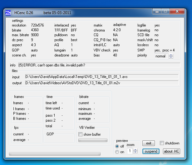

  6. Hi There,
    Fairly new to video but have had great success with AVStoDVD previously.
    Recently I have stumbled into a problem and wonder if anyone can help?
    I have been capturing my old VHSs and now plan to put them on DVD.
    Problem
    I am having trouble encoding anything longer than about 2hours 5mins. When I try to HCenc opens and an error appears in the info panel - "ERROR, can't open dbs file, invalid path?"
    I have tried different combinations of avi files but the only pattern I can see is when the total run time goes over abot 2hours 5 mins the error occurs.
    Example
    Single avi file 2 hours - OK
    Single avi file 2 hours 30 mins - ERROR
    Multiple avi files (total length) 2 hours 2 mins OK
    Multiple avi files (total length) 2 hours 10 mins ERROR
    I have attached the log file and a screen dump of the error.
    Any help is much appreciated.
    Thank you

  8. @stalkishi
    do you have the possibility to set the output destination in a different hard drive than "D:" ?
    Bye
    MrC
    AVStoDVD Homepage
  9. Sure... I will give it a try on my C: (system) drive when I get home and see if that helps.
    (I take it there is no maximum length that AVStoDVD/HCenc supports then?)
    Thanks for your help.

  11. Originally Posted by _MrC_ View Post
    @stalkishi
    Bye
    MrC,
    As suggested I tried putting the output folder onto a different drive but I still had the same problem.
    I fiddled around with a few things, did a new clean install and still got the same error. I then discovered everything works fine if I run AVStoDVD as an administrator. No Error, everything works perfectly now when I run as administrator (except I cannot drag and drop files into AVStoDVD only use the 'Add Title button').
    If I don't run as an administrator I still get the aforementioned "ERROR, can't open dbs file, invalid path?" error.
    As far as I am concerned the issue is fully resolved for me but I thought I'd share this FYI and for anyone else who may run into the problem.
    Again thanks for an excellent program and reply.
    Cheers.
