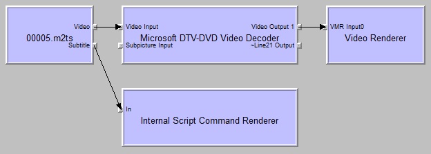

  20. I keep getting this error:
    avstodvd avisynth open failure: ffaudiosource: no audio track found
    and it references a specific line in the .avs file
    I'm confused, because the video track I selected did have an attached audio track???
    Any help/advice is appreciated
    log:
    '18:41:47' AVStoDVD Release 2.6.0 loaded!
    '18:41:47' AviSynth 2.5.8 is installed ("C:\Program Files (x86)\AviSynth 2.5").
    '18:41:47' ffdshow 1.2.4422 32bit is installed ("C:\Program Files (x86)\ffdshow\ffdshow.ax").
    '18:41:47' ImgBurn 2.5.7 is installed ("C:\Program Files (x86)\ImgBurn\ImgBurn.exe").
    '18:41:47' New AVStoDVD Project started!
    '18:42:17' MediaInfoLib - v0.7.61 initialized.
    '18:42:17' Title 1 "D:\DELICACY\BDMV\STREAM\00005.m2ts" added.
    '18:42:32' Subs "D:\DELICACY\2_4_subtitle.sup" added to Title 1.
    '18:42:40' DVD Output Setup changed from 'DVD Folder' to 'ISO UDF Image'
    '18:42:58' AVStoDVD Project started.
    '18:42:58' Title 1 video encoding operations started.
    '18:59:07' Process aborted during Title 1 VIDEO encoding operations.
    '18:59:07' Check log file <C:\Users\ASUS\Videos\DVD_0.log> for more info.

    i'm confused
    were you trying to keep the PCm audio to use in the DVD

  26. @sieve
    it seems you have some issues in either splitting M2TS and/or decoding the PCM audio stream. Be sure you have installed Haali Media Splitter and a good directshow codecs suite like ffdshow.
    If you still have problems, then use the 'Codecs'/'Build DirectShow Filters Graph' option and post here the resulting screenshot of GraphStudio.

  27. Do these m2TS files play back in WMP? Not sure why AVStoDVD would be using ffmpegsource2,
    unless directshowsource was not available.
    1. Not sure. I can check.
    2. I know these are different, but to be honest, I don't know much about them beyond that.
    @seeker47
    I don't have a region unlocked player and it won't play PAL
    I use BD rebuilder all the time and have the latest versions of Haali and ffdshow.
    I'll give that a try

  29. graph attached
  30. again...
