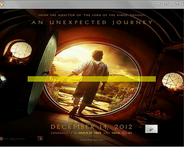

    I'm not sure to have understood what is your request, but, if you want to have the 'Play All' button highlighted by default, you can use the 'DVD Menu Wizard'/'Template'/'Force Play All button selection' option. Otherwise please elaborate better the request.
ID:	16193I tried to make the force play button feature work, but the middle of the screen still is highlighted when you mouse over it. The play button will still light up when you mouse over it. I'll try to burn it to disc to see if this occurs on a tv. Not a huge issue, just curious.
    Thanks!
