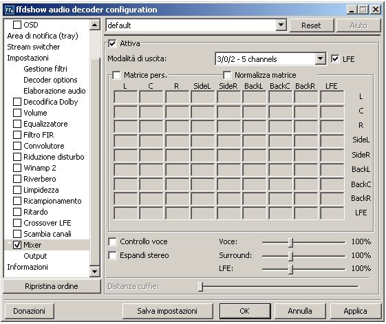

  8. DirectShow AC3 output mixer setting issue. You have to properly configure the output mixer: see Help/FAQ/Audio/Q4.1
    Bye
    MrC
    AVStoDVD Homepage

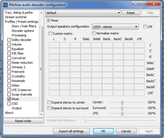

  9. Originally Posted by _MrC_ View Post
    Bye
    That didn't do anything because my setup is set to what it should be (stereo) as shown in the compassion between the FAQ pic and my config pic.
    An important note; ffdshow was installed AFTER AVStoDVD.
    The AVStoDVD installer must NOT have this program with it as I made sure that every box was checked during the installation of AVStoDVD.
    Is it that the program does not recognize the ffdshow program that it recommended itself?
    Under the software info at preferences, I do not see ffdshow listed at all.
    Do I need to configure the codecs at all?
    I currently have AVIS set to AviSynth and uncompressed set to all supported. Everything else is set to disabled.

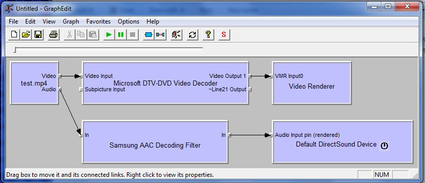

  10. Do you have installed AC3Filter or any other directshow AC3 decoders that may interfer with ffdshow?
    You can verify if ffdshow (or any other codec) is processing your file using GraphEdit or GraphStudio (render media file).
    Bye
    MrC
    AVStoDVD Homepage
  11. I opened the test file with GraphEdit and used the 'Render Media File..' command from the file menu.
    This is what I got.
    P.S.
    When I uninstalled and reinstalled the AVStoDVD and ffdshow programs, the audio encoded but now it is too fast.
    As usual, the backup audio works and the audio channel is the same wrong value as before.
    P.P.S.
    I just happened to look at my system tray and I saw a ffdshow logo for the audio and video.
    This does not appear when I run AVStoDVD!!!
  12. The decoding chain is too long: it is better to avoid the MS decoders bridges.
    Are you running Windows 7? Have you installed and setup Windows 7 Preferred Filters Tweaker as shown in Help/FAQ/General/Q1.5 ?
    Bye

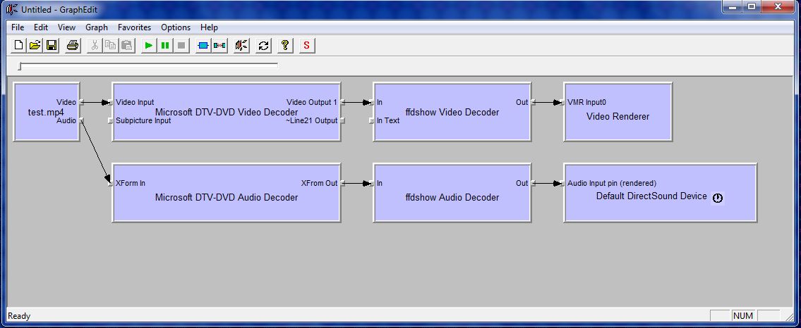

  17. Originally Posted by _MrC_ View Post
    Bye
    I found the solution to the problem and you were half right.
    I didn't look at the log but the video comes out correctly.
    I disabled the audio decoder and another one took its place.
    This one makes sense because I am using a camcorder from the same company.
    I've posted my final graph below.
    Thank You

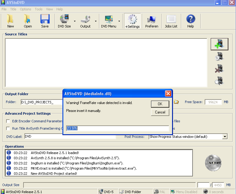

  26. Hello!
    I'm using the version 2.5.1.
    When I open a media file I get the following message:
    Only the cancel button is accepted.
  27. Member Seeker47's Avatar
    Jul 2005
    Originally Posted by knownothing View Post
    Hello!
    When I open a media file a get the following message:
    Yup, I saw one of those recently also. Probably a first for me with this particular message, and I can only assume there was something wrong with the video source file. Since I also had no idea what to do about it for AVS, and I was able to get by on that particular job with less-than-AVS-level results, I just ran it through CX2D, which is generally less particular about various flaws in your sources.
    If _MrC_ posts a step-by-step solution for this, I'll try it if and when I might ever encounter this issue again.
    Looking for Rare / Obscure / Hard-to-Find Films ? Check out http://rarefilmm.com/ , and also its Requests & Discussion forum http://rarefilmm.chatango.com
  28. There is an issue with MediaInfo 0.7.59 and fps reading with comma. To fix:
    - overwrite MediaInfo.dll in AVStoDVD\Lib folder with latest release (0.7.61)
    or
    - install latest AVStoDVD 2.6.0 Alpha release
    Bye
    MrC
    AVStoDVD Homepage

  30. Originally Posted by _MrC_ View Post
    or
    Bye
    I overwrote the MediaInfo.dll in the folder mentioned above, but it gave the same error message. So I uninstalled the version 2.5.1 and installed the 2.6.0 alpha, but it gives the same error...
