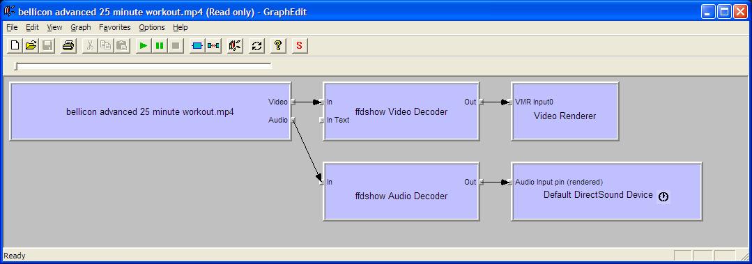

  2. @jagreenfield
    I'm using latest AVStoDVD release (2.5.1), as reported in the last line of the log files, with all and only the default included progs.
    I fear that you have a codec issue. Have you installed only ffdshow as directshow filters suite, or do you have installed other codecs that can conflict with ffdshow? Does the filters graph (render the mp4 file with GraphEdit) reports only haali and ffdshow or other filters?

  3. Originally Posted by _MrC_ View Post
    @jagreenfield
    MrC
    You're probably correct about the codecs. My initial attempt to encode these videos started with FreemakeVideoConverter, which I decided was a very bad approach. I'll work later on removing this. For now, I'd like to see what I have using GraphEdit.
    I've never used GraphEdit and can't seem to figure out how to get the type of graph you show in your link. When I open an MPG file, I see a sequence of filters. When I open an MP4 file, I get a pop-up asking about installing necessary filters.
    Could you please provide some brief guidance on how to get the the filter graph you show?

  5. Originally Posted by davexnet View Post
    File/render media file
    That's what I've been trying with my MP4 files. I get an alert with:
    Could not construct a graph from this file.
    - Have you installed all necessary filters?
    No such interface supported (Return code: 0x80004002)
    Doing the same with an MPG file generates a graph without any error alert.
    My problem seems to be related to making GraphEdit aware of additional filters needed for MP4.

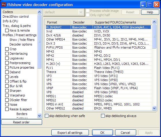

    This is how it should look, also, you can see it is using FFDShow for video;
    you have to make sure it is set properly in the FFDShow decoder config.
  8. MrC, davexnet
    Thanks so much for helping me resolve the problem encoding my MP4 file. It was not a codec issue. It was resolved by installing ffdshow. Once that was done:
    GraphEdit showed the filter sequence for the MP4 file
    the ffdshow and Haalie icons appear in the Task Bar for the entire encode
    Ithe HCenc encode done in 11 minutes
    Your suggestions regarding use of GraphEdit and the recurring references to ffdshow sent me back to the AVStoDVD docs to realize that ffdshow doesn't get installed as part of the AVStoDVD install. Obviously, this is something that you more experienced users probably always have installed. Any reason not to make it part of the AVStoDVD install?

    What does GraphEdit say if you render the source file?
    Bye
    MrC
    AVStoDVD Homepage
  13. Sorry, I've not used GraphEdit before and don't see what that will tell me. GraphEdit is not intuitive to me.
  14. @jedison
    1. download GraphEdit
    2. open GraphEdit
    3. click on 'File'/'Render Media File'
    4. select the file you want to convert with AVStoDVD
    5. take a screenshot of the resulting graph
    6. post the screenshot here
    Bye
    MrC
    AVStoDVD Homepage
