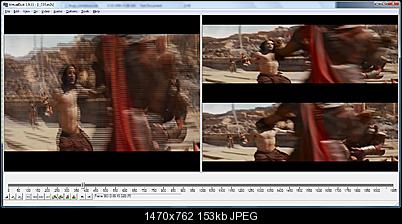

  3. Thanks davexnet , I didn't know I could upload small video files here like an .m2v.
    I hope you can see the lines or bars well enough . They are much larger on a wide screen TV.
    If you need them a larger file size I can do that . I didn't see the need to make them too large.
    J_C01.m2v
    J_C02.m2v
    Mar 2008
    [Attachment 13193 - Click to enlarge]
    [Attachment 13194 - Click to enlarge]
    This file shows evidence of being resized while interlaced. Is this the PAL John Carter DVD you tried to convert to
    NTSC using AVStoDVD ? I see from your A2D log that the file is identified as progressive;
    I think you're going to have to look carefully at the frames in the file. Perhaps you could post a small m2v of the source?
    (30 seconds or so)
  5. @cholla
    where did you get (or how have you produced) that m2v? It is obviously a badly encoded interlaced source to NTSC progressive. The horizontal ghost effect is due to the fact the field have been uncorrectly blended.
    Can you retrive the *real* original source?
    Bye
    Edit: dave, definitively your fingers are quicker than mine...
    MrC
    AVStoDVD Homepage

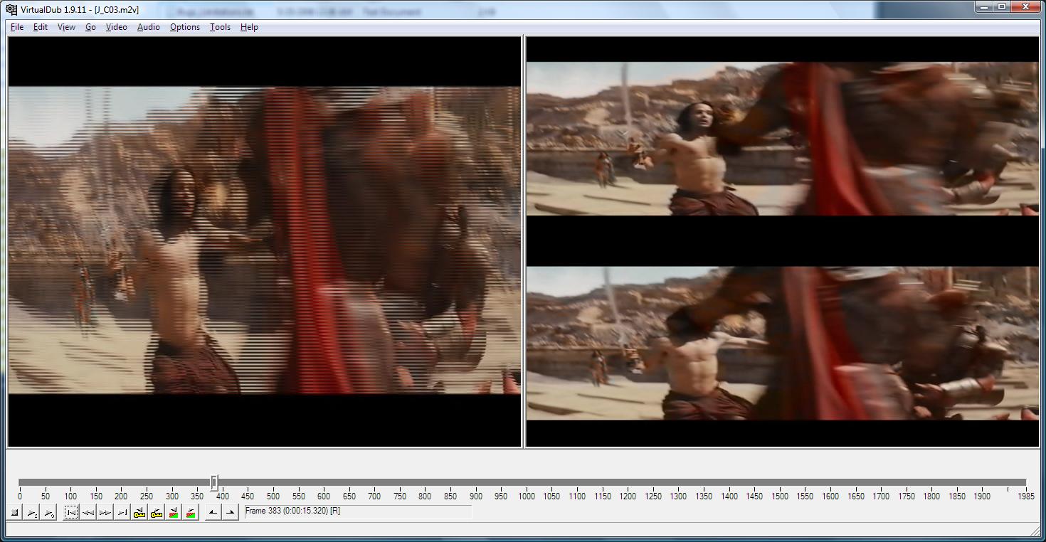

  7. This is a .m2v from the "Source" as requested . It looks fine to me.
    J_C03.m2v
    Mar 2008
    [Attachment 13196 - Click to enlarge]
    This source is bad, showing evidence of some strange blends that shouldn't be there.
    *usually*, these PAL movie DVD's have a progressive look, it's just the 24 fps sped up to 25 fps -
    I can only think something in your procedure has gone wrong.
    Why don't you re-rip the original dvd-9 DVD and use that as your source without any further processing?
    Just open the main title set IFO in AVStoDVD and it will index the proper VOB files.
  9. I'll give it a try & see where it goes . I think I tried that at first but I've done so much I can't remember.
    I was thinking of just starting over anyway.
    If you would elaborate on "showing evidence of some strange blends that shouldn't be there".
    That might help know what to look for.
    Mar 2008
    This source you attempted to use is flagged as progressive, so AVStoDVD doesn't anything special to it. Some of the frames appear
    progressive, while some are clearly interlaced. Even the interlaced frames don't look particularly clean, when you look
    at the fields one on top of the other. You will never be able to do a decent encode using this source. You have to start from the beginning.
