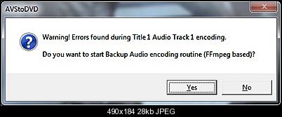

    Jun 2012
    Los Angeles, California
    First I want to say thank you for creating this wonderful free gift! I am grateful for your generosity and I hope your good karma returns to you a thousand fold. The video quality is excellent! I am having an issue with the audio, however. I am getting an error “Warning! Errors found during Title 1 Audio Track 1 encoding. Do you want to start Backup Audio encoding routine (FFmpeg based)?" I have tried 8 different MP4 files and they all result in the same error. I am grateful the new version no longer stops and waits for me to answer the question and automatically proceeds. Before I would go to sleep for 8 hours and awake with the program waiting to be answered. I have tried QuEnc CBR 1 pass, HCenc VBR 2-pass, Audio AC3 Wavi+Aften, FFmeg+Aften. I’m not sure what to try next. I suspect when it has audio problems it takes longer because it has to do the work twice? Thank you for any advice! Here is my log file:

    @ _MrC_, did you notice that I had amended my post #850, after you posted that workaround ? I suspect the workaround no longer applies . . . .
    @Adamtrons, re post #852, I have run into that very same error a number of times, and I'm not sure what's up with that. (Not limited to MP4 files, btw.) In a majority of cases, the alternate audio processing did proceed to completion, but not always.

  14. @Adamtrons
    thanks for the kind words. Probably the issue is to be found in the splitting/decoding the AAC audio track containded in your mp4. Have you installed Haali Media Splitter and a good directshow codecs suite, like ffdshow?
