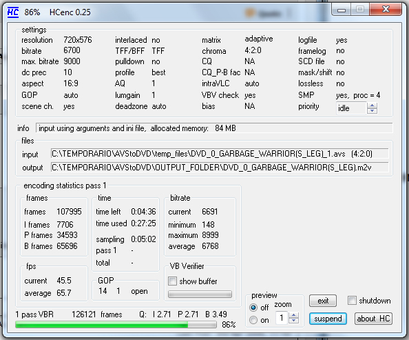

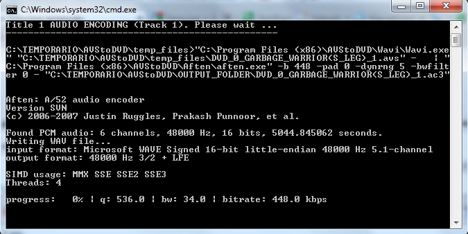

  23. I reset the experiences to zero as I wasn't sure the audio encoding would result right (as previously didn't), before the subtitle problem would occur (i though the audio problem was consequence of uncoordinated subtitling).
    So I started simply by converting the avi file without subtitles to a DVD structure.
    The video prcessing went perfectly right - check
    When audio processing started, the screen image keept the same from the begining to the end without showing changes in the processing percentage. At the first times I thought the prgram was jammed (you can see the linking image of the screen)
    The final result was the same, perfect image but without audio.
    I wonder what's the cause...
    annexes:
    garbage_warrior_(0...2).jpg show a sequence of the process of converting
    dvd_0.log is the correspondent AVStoDVD log file
    video_info.txt is the analysis of the avi video (garbage_warrior)
    Thanks in advance

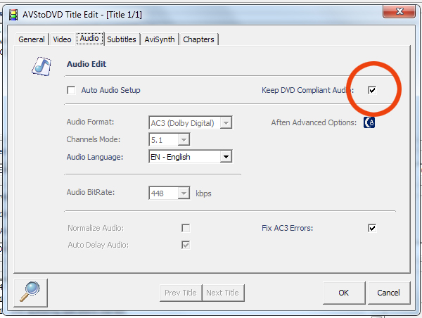

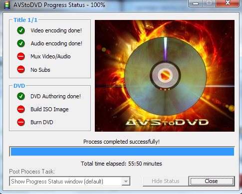

  24. The next experience was exactly the same as the previous, except I unckecked the option <auto audio setup> and checked the option <keep DVD compliant audio> at audio properties. The result was better. There was sound, but no synchronization.

  25. The following experience was quite effective. I didn't notice this hypothesis of yours on another thread and it resulted quite good. I turned back again auto edit with the installed encoder (ffdshow_rev3814_20110411_clsid) downloaded at FFDShow site. Perfect video and perfect audio synchronization. I think not havig installed FFDShow encoders caused the flaws of no audio and visible subtitles. Now I'll try to resolve the subitle question.
    Thank you MrC!
