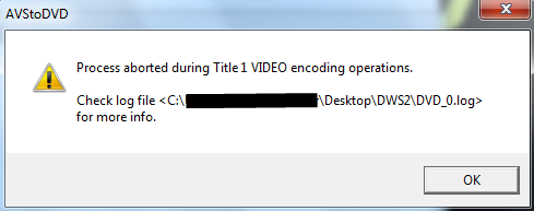

    i've tried 3 different .ts files and i can't get one of them to encode successfully..it starts, scans the .ts and within a minute this box pops up and it fails

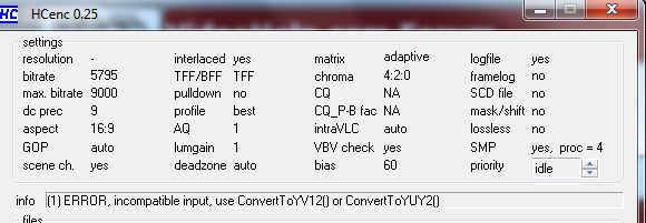

    HC Encoder gives an error in the encode before it disappears

    these .ts files are from 3 different sources and are not in any way related. All sizes are diferent. All bitrates. Tried PAL and NTSC, no luck. I wonder what it could be.

    please post the full DVD_0.log file
    @dylz
    yes, it can surely be. If the 2 MediaInfo tags ('Delay' and 'Video Delay') are equal, then the auto delay adjust routine works properly. But if they are not, then the routine fails because it uses 'Delay' value instead of 'Video Delay'. In short, the routine is not 100% reliable.
    Bye
    MrC
    AVStoDVD Homepage

  15. I suggest you to demux the secondary audio track (AC3): add the .ts file, then when AVStoDVD asks you to select the audio track, select it and toggle on the 'Demux selected Audio Track' option box.
    Bye
    MrC
    AVStoDVD Homepage

    <11/04/2011 23:26:41>
    TITLE 1 SOURCE FILES
    Video: H:\Justified S02E04 For Blood or Money 720p WEB DL DD5 1 H 264 RANDi\Justified.S02E04.For.Blood.or.Money.720p.WEB-DL.DD5.1.H.264-RANDi.mkv
    Info: AVC - 3953 kbps - 1280x720 - DAR 1.778 - 23.976 fps (CFR) - Progressive - 40:39 minutes - 58491 frames
    Audio 1: H:\Justified S02E04 For Blood or Money 720p WEB DL DD5 1 H 264 RANDi\Justified.S02E04.For.Blood.or.Money.720p.WEB-DL.DD5.1.H.264-RANDi.mkv
    Info: AC3 - 384 kbps - CBR - 6ch - 48000Hz - 16bit - 40:39 minutes - Internal
    Subs:
    [MediaInfoLib - v0.7.41]
    AVISYNTH SCRIPT
    Import("C:\Program Files\AVStoDVD\Lib\A2DSource.avsi")
    Video = A2DVideoSource("H:\Justified S02E04 For Blood or Money 720p WEB DL DD5 1 H 264 RANDi\Justified.S02E04.For.Blood.or.Money.720p.WEB-DL.DD5.1.H.264-RANDi.mkv", CacheFolder="C:\DOCUME~1\blood\LOCALS~1\Temp", FrameRate=23.976, VFR=false)
    # Audio is frameserved by AviSynth just for Preview and Edit purposes.
    Audio = A2DAudioSource("H:\Justified S02E04 For Blood or Money 720p WEB DL DD5 1 H 264 RANDi\Justified.S02E04.For.Blood.or.Money.720p.WEB-DL.DD5.1.H.264-RANDi.mkv", CacheFolder="C:\DOCUME~1\blood\LOCALS~1\Temp")
    Video = Video.ConvertToYV12
    #Using DGPulldown/HCenc to upsize FPS
    Video = Video.Spline64Resize(720,576)
    AudioDub(Video, Audio)
    START VIDEO ENCODING OPERATIONS
    Encoding Profile: HCenc VBR 1-pass
    Target Video FileSize: 1349.1 MB
    HCenc Parameters: -ini "C:\DOCUME~1\blood\LOCALS~1\Temp\DVD_0_Title_01_Ju stified.S02E04.For.Blood.or.Money.720p.WEB-DL.DD5.1.H.264-RANDi.HCenc.ini"
    HCenc ini file:
    *INFILE C:\DOCUME~1\blood\LOCALS~1\Temp\DVD_0_Title_01_Jus tified.S02E04.For.Blood.or.Money.720p.WEB-DL.DD5.1.H.264-RANDi_1.avs
    *AVSRELOAD
    *OUTFILE C:\Documents and Settings\blood\My Documents\My Videos\DVD_0_Title_01_Justified.S02E04.For.Blood.o r.Money.720p.WEB-DL.DD5.1.H.264-RANDi.m2v
    *LOGFILE C:\DOCUME~1\blood\LOCALS~1\Temp\DVD_0_Title_01_Jus tified.S02E04.For.Blood.or.Money.720p.WEB-DL.DD5.1.H.264-RANDi.HCenc.log
    *MAXBITRATE 9000
    *1PASS
    *BITRATE 4638
    *PROFILE BEST
    *ASPECT 16:9
    *PROGRESSIVE
    *TFF
    *BIAS 50
    *DC_PREC 9
    *MATRIX MPEG
    *AQ 1
    *LUMGAIN 1
    *SMP
    *PRIORITY IDLE
    *WAIT 2
    <11/04/2011 23:26:53>
    PROCESS ABORTED DURING TITLE 1 VIDEO ENCODING OPERATIONS.
    CHECK LOG FILE <C:\DOCUMENTS AND SETTINGS\BLOOD\MY DOCUMENTS\MY VIDEOS\DVD_0.LOG> FOR MORE INFO.
    Log file created by AVStoDVD Release 2.3.4
    help urgently needed to get this sorted thanks
  29. @tyson25
    have you installed Haali Media Splitter (included in AVStoDVD installer package) and ffdshow (not included)?
    If you are running Windows7, have a look at Help\FAQ\General\Q1.5
    Bye
