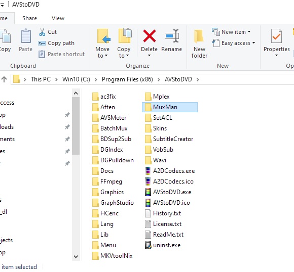

  11. Someone recently posted about a dll issue. I have a similar Active X issue on Win 10:
    I've got a similar issue on my Win 10 install (still works fine on XP!), "Windows Common Controls Active X Library (mscomctl.ocx) is not installed or is not configured properly.
    This file is mandatory for AVStoDVD.
    Any suggestions?
    Geff
    Mar 2008
    Any suggestions?
    Geff
    Did you run the install setup or are you using the portable version?
    Within the AVStoDVD folder structure there is folder called "Lib" and in there is a file called mscomctl_reg.bat - right click this and choose "run as adminstrator"
    and it should fix this problem

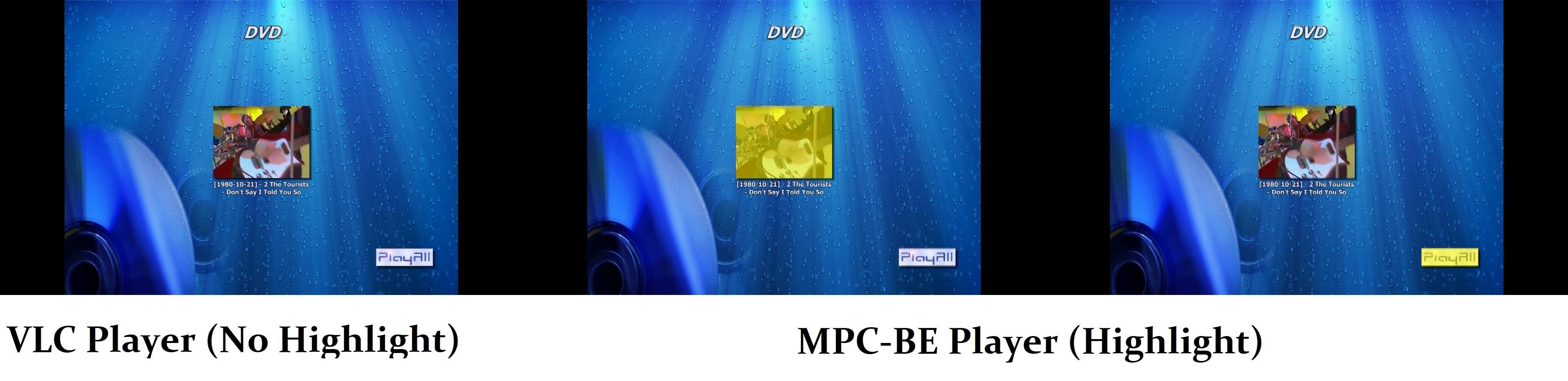

  13. When I make a menu (with default settings), VLC player won’t “highlight” the chapters in the menu. MPC-BE player does. What can I change so that VLC does the same?
    Mar 2008
    Can you post some screen shots of how they look?
  15. Originally Posted by davexnet View Post
    The buttons still function on VLC, but I don’t get the yellow highlight when I hover over the button with my mouse.
    [Attachment 77720 - Click to enlarge]
    Mar 2008
    Ok, that's the thumbnail to the title. I don't think you can do anything from within AVStoDVD,
    this is more likely something in VLC.
    The program would be reacting or interpreting something set by the authoring program,
    Muxman.exe

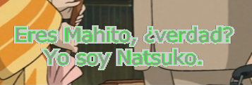

  17. Hi everyone! I was trying to convert a MKV file to DVD5, everything works perfect except for the subtitles, I get this error "WARNING! Process aborted during 'Title 1 SUBS encoding operations start' Section"
    I have read in the forum a possible solution was opening the subtitles in SubtitleCreator and see if the program needs to fix something, but everything loads fine, I also see AVStoDVD converts it to ANSI format that is fine with the conversion, but I donīt know why is it failing. Here is one srt file obtained from windows temp folder and the log if that helps.
    Thanks!
  18. Member
    Mar 2008
    Thanks!
    Extract the two original subtitles from the mkv file using mkvcleaver and post them here
  19. Originally Posted by davexnet View Post
    Thanks!
    Here you have:
    Mar 2008
    Unfortunately I'm unable to recreate the problem using a suitable video, 2 audio tracks and your two subtitles.
    I thought that perhaps it might be the long name of your video, sometimes too long a name with all those "."
    can cause problems. I ran my test again using your same exact name and it still worked fine.
    You should probably give it a try rename the video to "el_chico_y_la_garza.mkv" and try that

    Thanks for your help, I tried renaming it to "el_chico_y_la_garza.mkv" but it still fails converting the srt files. I see the program tries to save the converted srt file as an IFO file in the route of the main program installation "C:\Program Files (x86)\AVStoDVD\SubtitleCreator\Examples\VTS_01_0.I FO", and that route needs admin privileges to copy files, does AVStoDVD need admin access before starting it?
  22. Member steptoe's Avatar
    Muxman.exe
    If subtitles are being silly for me, extracting the subtitles and adding it back as an external subtitle track works. Even for blu-ray subtitles
    Add your video file as normal, when prompted to choose what subtitles to add click the "demux selected subtitles track" then click the small red "x" in the corner and it will ask where to save the .srt file(s) and then extract it from the video. You can also edit this file as its now an .srt text file
    Make sure there are no subtitles in the source video
    Now go to the menu bar, choose "Titles/Subtitle/Add Subtitle" and choose the subtitle file(s) you've just extracted and add it as an external subtitle
    Go to the menu bar again, and choose "Title/Edit Title/Subtitles" and turn OFF "auto subtitles setup" by unticking the box option
    That usually fixes any subtitle issues and also allows me to hardcode subtitle if needed
    You could also just try turning OFF "auto subtitles setup" without extracting the subtitles and load your video file with subtitles as normal
    No idea why, but if I use "Auto subtitles" option it frequently doesn't recognise subtitles but with the option OFF subtitles are added and work as they should

    Finally I got it!!! I discovered subtilecreator .exe wasnīt launching in AVStoDVD installation folder, so I installed it appart and replaced the folder, then I launched AVStoDVD with admin privileges and everything went ok, thanks you all.
    Now I have to deal with the subtitles color, itīs horrible, mixed green with brown I donīt know why

  26. @ Nacheras,
    Give this a try:
    Image Attached Thumbnails IfoRdit_Subtitle_color.pdf
