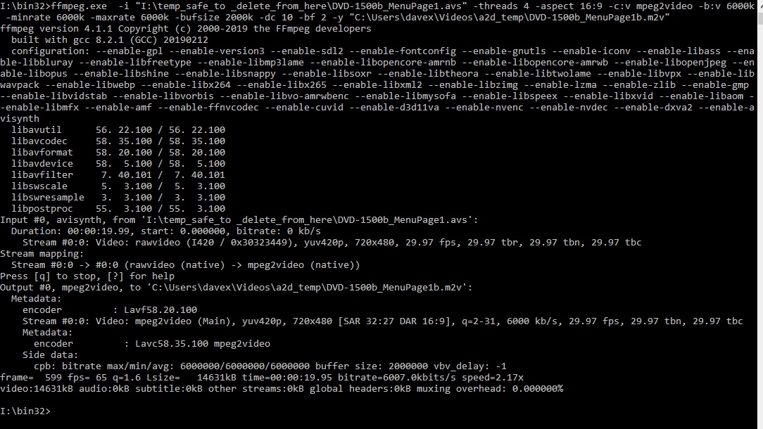

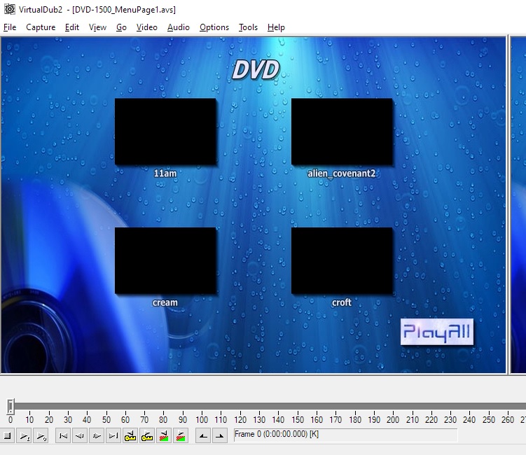

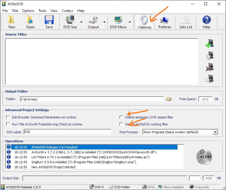

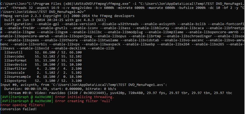

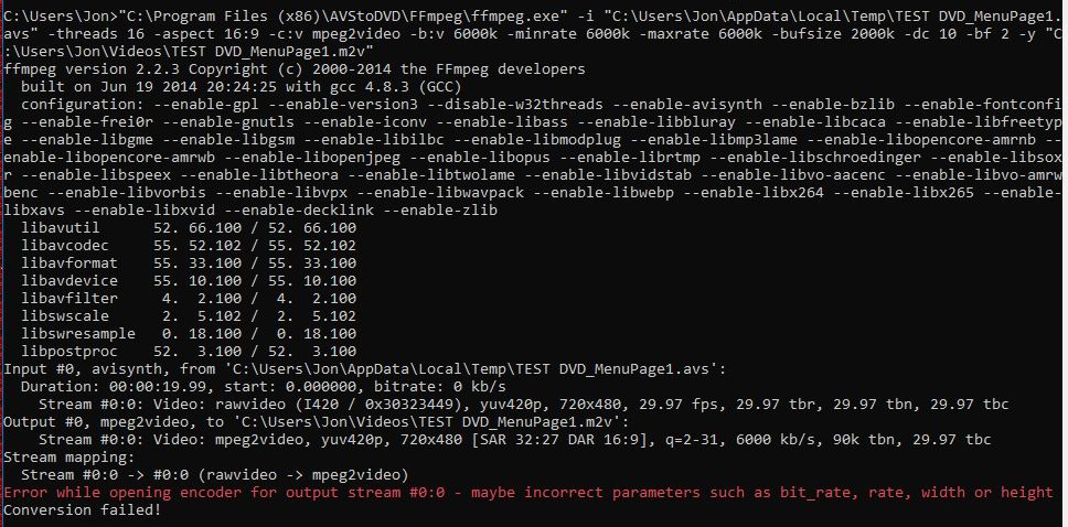

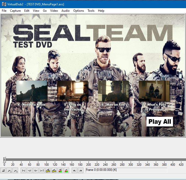

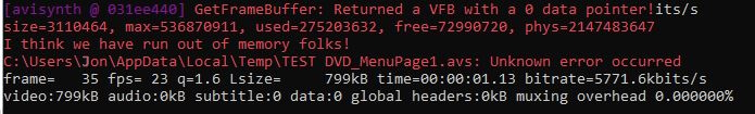

  6. I am having a problem creating motion thumbnails from time to time. It seems to occur more often with four titles.
    When I watch the tools operate, I see that menu creation fails immediately, and muxman fails soon afterwards.
    The problem is that there is no useful data in the log files and there are no scripts lying around for me to try it manually.
    I have also tried the DVD creation process on the files one at a time (thinking there was something bad in the video stream) and they are all successful.
    Any advise on how to debug / resolve?

    Mar 2008
    Regards,
    Jon
    Please post the complete log

    EDIT - this is the command that creates the menu m2v file
    ffmpeg.exe -i "C:\Users\Jon\AppData\Local\Temp\TheTitle - SEASON 5, DISC 2_1_MenuPage1.avs" -threads 32 -aspect 16:9 -c:v mpeg2video -b:v 6000k -minrate 6000k -maxrate 6000k -bufsize 2000k -dc 10 -bf 2 -y "C:\Users\Jon\Videos\TheTitle - SEASON 5, DISC 2_1_MenuPage1.m2v"
    I wonder if that -threads 32 is an issue?

  14. I will try to run the command stand-alone, but I have had no problems with 3 titles (and other 4 title projects.)
    Hopefully the .avs script will hang around after unchecking those boxes...

  20. You may be on to something regarding the number of threads. I was able to run the ffmpeg command (sort of) and got the following:
    [AVFilterGraph @ 4a39e100] Error initializing threading.
    [AVFilterGraph @ 4a39e100] Error creating filter 'null'
    Error opening filters!
    Conversion failed!
    I ran it again with -threads 16 (instead of 32) and got the following:
    Error while opening encoder for output stream #0:0 - maybe incorrect parameters such as bit_rate, rate, width or height
    Conversion failed!
    I suspect the error message from the second run is because I messed up a cut/paste somewhere.

    If you want a second set of eyes to look at it, show the CMD box session
    including the command issued and full response
    This source script (the "-i" from the command) can be dropped into 32-bit virtualdub2, you may see further error messages.
    Otherwise, if working, you see an image of the menu

  23. Here's the ffmpeg -threads 32 dialog:
    [Attachment 69108 - Click to enlarge]
    Here's the ffmpeg -threads 16 dialog:
    [Attachment 69116 - Click to enlarge]

  24. I dropped the TEST DVD avs source file into VirtualDub2 and got the menu:
    [Attachment 69114 - Click to enlarge]
    Thumbs animate correctly when the avs script is played via VirtualDub2.
  25. Looking at your updated post #4072, I see your cmd dialog shows -threads 4. Was that generated via AVStoDVD or did you enter it manually?

  27. Member
    Mar 2008
    NO it's automatic - I have an old CPU. Did you try threads 4?
    I tried threads 16 and it worked without issue.
    Threads 32 gave me warning it was too high and was reducing to 30, but it ended normally
  28. Interesting! I tried it with threads 4 and it actually ran for a few frames. Then I got:
    [Attachment 69118 - Click to enlarge]
    Very strange behavior...
    I will update the tool chain per your recommendation and try again.
    Just as a side note: I have success with menus with 4+ motion thumbs in the past but I have also had failures like this one. I'd sure like to get to the root cause.
    UPDATE UPDATE UPDATE UPDATE UPDATE
    I just did another test with threads 1 and it completed successfully. The result played perfectly, so it is definitely related to the number of threads and/or the memory they consume...
