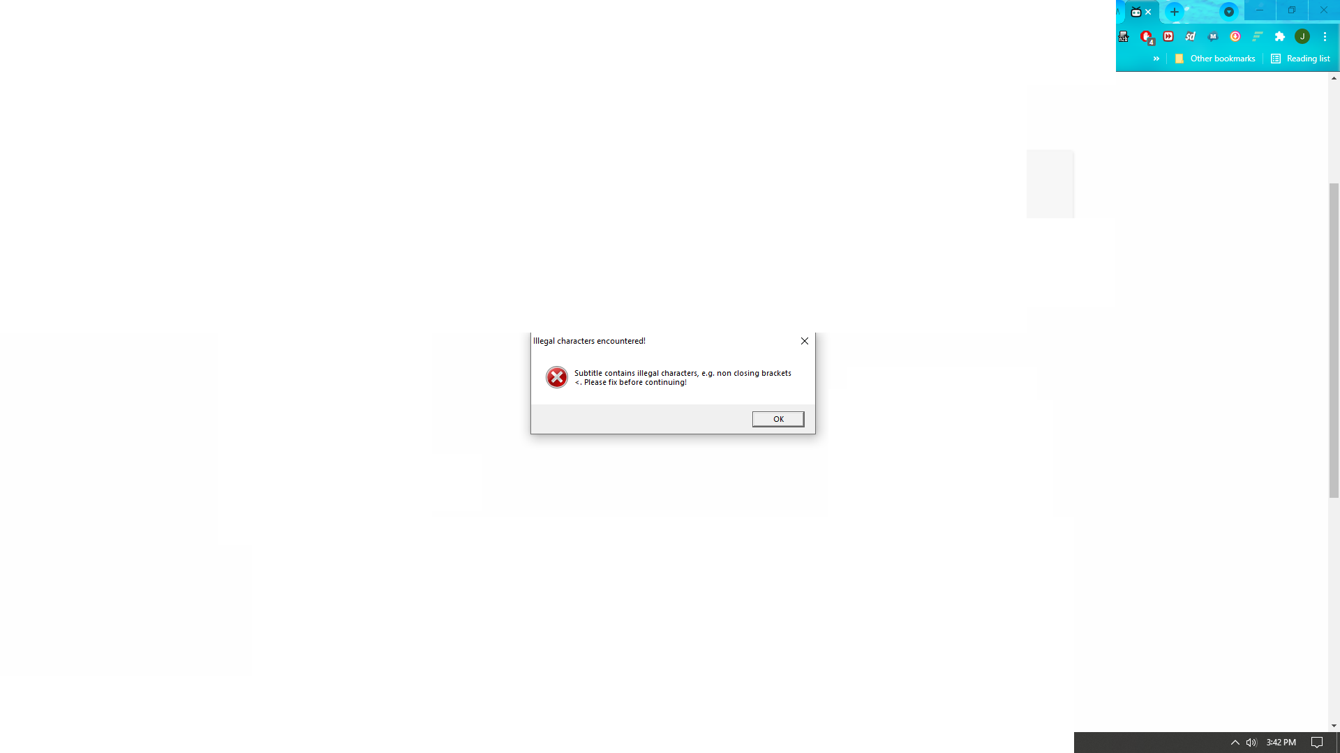

    Hi i was trying to make a dvd out of some old stuff i downloaded and the video converts fine but when it gets to subtitles part i get a error its. Image
    [Attachment 61077 - Click to enlarge]
    I thought it was how the title is named so i renamed it and this error keeps coming up. These was mp4s with srt seprate subs so i muxed the sub into mkv. I cannot add srt with the mp4. into the program comes up error. How can i fix or bypass the error?

    SRT is probably bad. It should be just clear text. Open it in Notepad and take a look
    Dec 2006
    Looks ok to me i do see , and music notes in the subtites will that stuff throw off sub workshop or whatever avstodvd uses?
    Mar 2008
    Load the SRT in Subtitle Edit and see what it says
    Tools/Fix common errors
