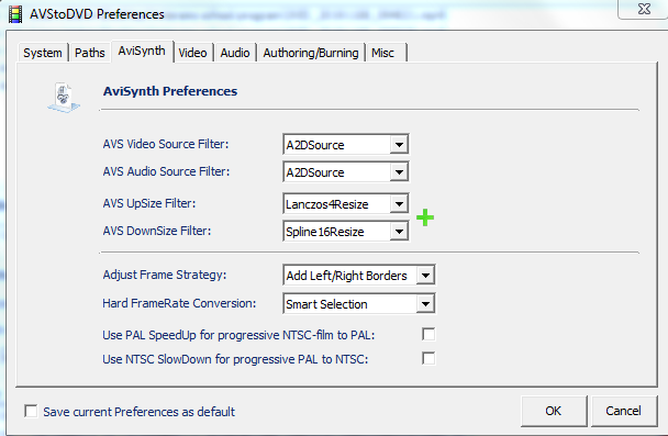

  26. Hello!
    I have a problem with AVStoDVD and true 24 fps files: Since the DVD spec is 23.976 fps, 1 frame at every 1000 gets dropped in the encode. This behavior is to be expected, however, I would want my 24 fps files to be automatically slowed down to 23.976 fps so that no frame gets dropped in the DVD encode.
    There is already an option that is similar in function: "Use PAL SpeedUp for progressive NTSC-film to PAL" and "Use NTSC SpeedDown for progressive PAL to NTSC".
    Could you add a "Use NTSC-film SpeedDown for true 24p to NTSC" option that does the proper speed down?
    Thanks alot!
  27. Member manolito's Avatar
    Jun 2009
    Germany
    Hi elcoyote,
    I believe that this is a non-issue...
    The DVD standard for NTSC video is NOT 23.976, it is 29.97 instead. A frame rate of 23.976 or 24 is only compliant if pulldown flags (RFF flags, aka soft telecine) are added to the encoded video stream. AVStoDVD does this automatically using DGPulldown (or HCenc pulldown).
    For a 24 fps source AVStoDVD does not drop any frames, it just uses a different pattern of RFF flags to bring the presentation frame rate up to 29.97. This is different from the "regular" 3:2 pulldown, but nobody will ever be able to see the difference.
    If you really think that only the standard 3:2 pulldown will do it for you, there is an easy workaround in AVStoDVD which allows you to slow down your 24 fps source to 23.976 fps first and then apply the standard 3:2 pulldown:
    In the AVStoDVD settings make sure that NTSC slowdown is checked. Load your 24 fps source into AVStoDVD, then right-click on the input title and click "Edit Source Title Info -> Video FrameRate". Change the fps from 24 to 25.
    This will slow down your source from 24 to 23.976 and apply the standard 3:2 pulldown to the encoded video stream. I do not believe that it makes any sense, though...

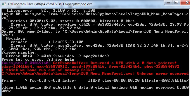

  28. Hello Everyone,
    I have AVStoDVD 2.8.8 installed as well as all of the required software such as AVIsynth etc. I have created a DVD with a menu that has 3 video files as well as background music that plays. I have the menu set to run for the default 15 seconds with motion thumbnails. When trying to do a full preview of the DVD menu or create the end ISO to burn, I keep getting an error like so:
    [avisynth @ 040651a0] GetFrameBuffer: Retruned a VFB with a 0 data pointer!
    size=12441664, max=536870912, used=199508416, free=81342464, phys=3205844992
    I think ywe have run out of memory folks!
    C:\Users\Admin\AppData\Local\Temp\DVD_Menu_PanuPages1.avs: Unknown error occurred
    I have tried uninstalling and reinstalled the latest version of ffdshow as well as avisynth and still get the same error. I have tried doing everything I can to no avail. Please someone help me so I can finish my Veterans day dvd for my kids and friends.
    Processor Intel(R) Core(TM) i7-4790K CPU @ 4.00GHz, 4001 Mhz, 4 Core(s), 8 Logical Processor(s)
    Installed Physical Memory (RAM)	8.00 GB
    Windows 7 Pro 64 bit
    EDIT: I have tried uninstalling ffdshow and installing lavfilters and I still get errors. I even set the preferred DirectShow codec settings like in the help file.
  29. Member steptoe's Avatar
    Originally Posted by RejectedManiac View Post
    Hello Everyone,
    Post the log file, it should show where the encode stops
    Did you use HCEnc or FFMPEG as the encoder
    Having a look, somebody else had the exact problem and the suggestion was avisynth was running out of memory after the encode worked fine on their previous computer and this only happened after moving to a more powerful system
    Try adding SetMemoryMax(2048) in your AviSynth script as the very first line. Its far more thyan avisynth can handle bu some filters are very memory intensive (assuming you're using filters via avisynth). Click on the avisynth tab in your prject and untick the auto avisynth script option to enable manual editing

  30. Originally Posted by steptoe View Post
    Hello Everyone,
    Also, if this still doesn't work, have a look at avisynth+. Its come a long way and is multi-threaded and now works perfectly with AvstoDVD and might have a few fixes
    https://github.com/AviSynth/AviSynthPlus/releases/download/v3.4.0/AviSynthPlus_3.4.0_20191020.exe
    Just double-click the installer and install to defaults. It should work perfectly as avisynth
    I used FFMPEG as the encoder.
    It doesn't show where the encoding error is in the log unfortunately. When creating the ISO I see the error in my CMD prompt and goes to the next task. It still creates the ISO successfully, but when I watch the ISO it's all messed up. I see the menu for a split second, skips it and plays the first video. It shouldn't do that because I didn't force the 'Play All' button. If I hit next to go to the 2nd video it stops and says cannot render file. Is there an avisynth log I can include? I happened to get a screenshot of the error right when it errors out and moves on to the next tasks that I will include.
    I did see the guy with the same problem with me yesterday and I haven't made any changes to my system. I saw that post was from like 2012 and he was only running 2 gigs of ram. I would think 8 gigs of ram would be quite good compared to then. I've actually used AVStoDVD on this system for about 3 years with no hardware changes perfectly fine. A year passed and now I need it again and here we are not working. The only thing that would have changed about my system is OS updates and a newer version of AVStoDVD.
    Under the avisynth settings for my project I don't see the option to untick auto avisynth script. I've included a screenshot.
    I actually have the latest avisynth+ installed with default settings in the default location (C:\Program Files (x86)\AviSynth+) and that's what I'm using avisynth+ 0.1 (r1576). I tried it with avisynth and got the error so I upgraded to avisynth+ and get the same error.
    PS. I even tried uninstalling ffdshow and installing the LAV filters with the suggested settings. When encoding that I get another error that I'm not able to see and also fails. I've included a screen shot at the very bottom exactly where it fails and says "Warning! Errors during DVD Menu generation"

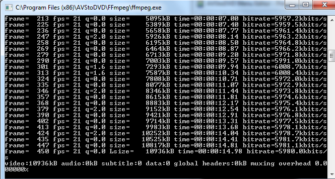

    I tried setting the encoder to HCenc VBR 2-pass. I tried to do a full menu preview and it gets to the part in the 3rd screen shot and fails. I also uninstalled the version of avisynth+ and installed the one you gave me and still fails when trying to see the full menu repview. Will give it a shot creating the ISO anyways and will report back.
    Back: It ended up creating the DVD perfectly fine with the avisynth+ you gave me with HCenc. I notice that the text in the menu and the menu itself is very pixelated/grainy. I understand it's 720x480, but a retail DVD with the same aspect ratio is much better quality/clear. Any idea how to sharpen the menu and the video up? The source video files are 4k.
    Thanks!
