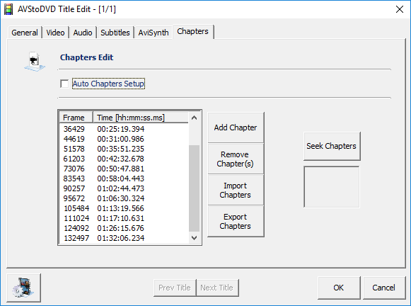

    The program supports built in chapters in MKV files automatically, see these two images.
    What was the frame rate of your source? Can you provide the AVStoDVD log ?

    As davexnet already pointed out, AVStoDVD does honor MKV source chapters without problems. You need to check the "Use Source Chapters" option in the preferences.
    And for adding chapter points manually it is true that AVStoDVD only supports the IFOEdit format which means frame numbers. If AVStoDVD is set to change the frame rate for the output then you will need to recalculate the frame numbers for your chapters. But there are chapter editors out there which will do this calculation for you (like ChapterGen or chapterEditor).
    Cheers

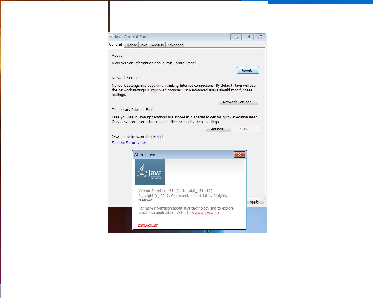

    Perhaps this has been discussed here before (in sections of this very long thread that I have not seen), but recently I've had to convert increasingly more HEVC / X265 material using AVS. So far, decent results using the default FFMPeg choice. I'm wondering if the (latest ?) version of HCenc being used would be up to the task ? What about 2-pass ? And are there any other AVS settings I should be using ?
    When I installed 2.8.7 on this rig, I did set everything to LAV filters. (Not sure how to get from mere Admin status to "Elevated", but this seems to have taken. Still using W7U x64.) Occasionally I still see the warning about having both FFDshow & LAV installed at the same time. This does not seem to have hampered anything thus far though. There was that issue with the missing icons, but the instructions in FAQ GUI 2.6 took care of that.
    Oh, one other issue. I just got an error that no subs could be created because Java Runtime Environment could not be found on the system. But it most certainly is installed.

  18. Member
    Mar 2008
    Why do you doubt HCenc it usually works very well. I usually use it with AQ=2, LUM=1 and the Fox 2 matrix
    Might be better off using ffmpegsource instead of direct show for you video and audio source filters

    Have you installed the 32 bit version of the Java RTE ?

    I cannot reproduce your issue that A2D does not detect an installed JRE. Are you sure that you have installed the 32-bit JRE version?
    No, it was the 64-bit, I believe. Will check on that. So, I need to have the 32-bit JRE also ?

  25. Member
    Mar 2008
    I'm not sure what you mean by also. If you have some other program(s) that needs it that's your business.
    AVStoDVD/BDSup2Sub almost certainly needs the 32 bit version. They two versions should be able to live together without issue.
    I'm guessing that when I sought out the JRE, there was some auto-detect and it fed me the 64-bit as being applicable for this system. I'll have to see if I can get around that and isolate to the 32-bit version for installation.
