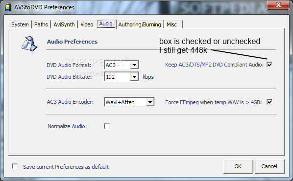

    video conversion with this app works perfectly. However, the last 2 mkv's I've tried, i haven't been able to get the audio I want. All I want is ac3 192k and the last 4 tries it keeps giving me 448k....way bigger than I need. I'd rather have the xtra 200mb's to give to the video quality than the audio. My settings in the audio are like this below
    I'm stumped

  4. @Moontrash
    what is the audio format in your last 2 mkv?
    @helidriver
    glad to hear you have found a workaround. As a suggestion of mine, do not use 'HCenc VBR 1-pass' for such high avg bitrate (8500 kbps), do prefer 'QuEnc CBR 1-pass', since it is not convenient to force HCenc to work almost as a constant bitrate encoder (avg 8500, max 9000).
    Bye
    MrC

    Nov 2005
    1 is DTS and the other is ac3
    i found a workaround...i used Multiavchd to create a dvd and the resolution was squished but the audio was good...so i stripped the audio from it...ran the same mkv through avstodvd but left out that audio and created the vob files...(calculated to the exact size i would need to reach 4.35 gb's)...i used pgcdemux and stripped the audio from the Multiavchd title and did the same with the avstodvd title except only stripped the cell times and the video...muxman'd everything..works perfectly and in sync
  8. Originally Posted by Moontrash View Post
    There's a check (hardcoded) on the input audio channels number. If channels are 6+ than bitrate is maximized (448 kbps for AC3 output). I admit that it can be confusing and the "feat" is not documented (I will update Help section), but the rationale is to keep maximum audio quality when source audio is (or should be) good.
    If you want to force 192 kbps in any case, add your title, go to 'Edit Title'/'Audio', toggle off 'Auto Audio Setup' and select 192 as 'Audio BitRate'.
    BTW remember that 192 kbps will be distributed (not equally) among all the 6+ channels.
    Bye
    MrC
    AVStoDVD Homepage
