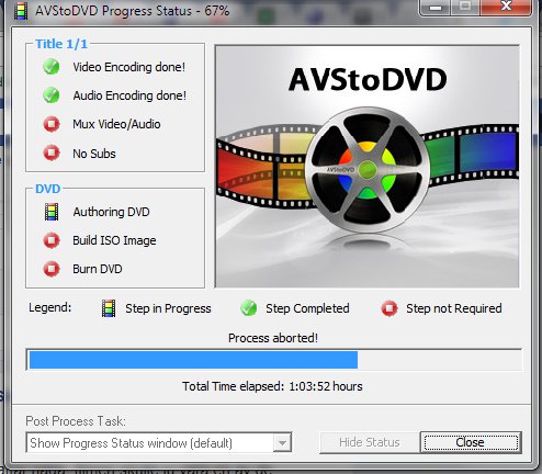

  10. Hi folks, may I ask about this problem. I have been using AVStoDVD for a couple of months, the latest version. I am using it "out of the box" and until yesterday it worked fine with just about anything I threw at it. Now, though, with different MP4 source files that play back fine in VLC, it will not complete conversion to DVD. I get the following error message and a log file which I can't interpret at all (beyond my technical knowledge).
    https://files.videohelp.com/u/226054/DVD_9.log
    Any pointers to how conversion can be fixed?
Name:	AVS process aborted.jpg
  11. Member manolito's Avatar
    Jun 2009
    Germany
    Hi TheNorwegian,
    your log shows that AVStoDVD stumbled at the authoring stage using BatchMux. Video and audio got converted just fine. This means that something about your DVD menu throws BatchMux off. To analyze this further you need to post your BatchMux log file (E:\Mediadisk\DTV og DVD\DVD_9_BatchMux.log). To be able to see this file you might need to uncheck the options "Delete temporary DVD assets files" and "Delete AVStoDVD working files".
    Maybe you should repeat your conversion using a simpler menu. It also might help to specify FFmpegSource instead of A2DSource under "Preferences" for both video and audio.
    Two other things in your AVStoDVD configuration stick out (not related to the current issue):
    1. You use an old and very deprecated version of ffdshow as your source filter. This is no problem as long as your source files are decoded correctly (the HEVC format will not work AFAIK). It is recommended to uninstall ffdshow and the Haali splitter and use a current version of LAV Filters instead.
    2. You use some Microsoft source filters as your preferred DirectShow source filters. This often leads to audio / video sync problems. It is recommended to change the preferred filter settings to either LAV or ffdshow under "Codecs -> Preferred DirectShow Codecs Setup".
    Good luck
    manolito
  12. Thanks Manolito. Here is the BatchMux log. I have no idea what it says.
    I author with DVD menu disabled, always did, and have the same setting now. I also tried changing A2DSource to FFmpegSource but that did not help.
    https://files.videohelp.com/u/226054/DVD_9_BatchMux.log
    When your suggestions did not work for me, I uninstalled the programme and reinstalled it, but the exact same problem occurs.
  13. Member manolito's Avatar
    Jun 2009
    Germany
    Since you do not use menus this issue looks like buffer problems.
    MuxMan (which does the authoring work for BatchMux) is very picky when it comes to buffer underflows. Your target bitrate of 8500 kbps is well inside the DVD specs, but FFmpeg has a habit to overshoot the max bitrate.
    Two things you could try:
    1. Reduce the bitrate settings. Under "View/Edit title settings -> Video" uncheck "Auto Video Setup" and "Auto Bitrate Calculation". Then set your bitrate to 8000 kbps or even lower,
    2. Or change your encoder from FFmpeg to HCenc in the same window. HCenc handles the VBV buffer much better than FFmpeg so there is a good chance that MuxMan will author the resulting streams without errors.
    Cheers
    manolito
  14. The BatchMux log file is reporting "BatchMux: ERROR opening Log File E:\Mediadisk\DTV og DVD\AVS to DVD\DVD_9_MuxMan.log". There was a similar issue here, and the issue was related to some writing permission problems in Wine under Linux.
    In addition to manolito's suggestion, may you try to use as output folder a simpler folder, where you are 100% sure to have writing permissions, such as "C:\DVD"?
    Bye
    MrC

    Your source audio is in the AC3+ format, but this is not compatible for DVDs. Your settings specify to keep DVD compliant audio, but AVStoDVD falsely assumes that AC3+ is DVD compliant which it is not.
    You should try to disable the setting "Keep compliant audio" to force AVStoDVD to reencode the audio track.
    Good luck

    Now exactly WHAT I did the last time, I can't recall, but I DID get the movie converted. Can't say for sure if I just got frustrated and went to another source to convert. But I'm having the same problem. I GET NO AUDIO! I first tried to convert with the "Keep AC3/DTS/MP2 DVD Compliant Audio" dialog box ticked as it's my "default preference". I got no audio (log: Armed Response (2017) - (R) and tried again with the box, "Keep AC3/DTS/MP2 DVD Compliant Audio" UNticked. That log I'm also uploading: Armed Response (2017) - (R)_1. What'd I do wrong?
