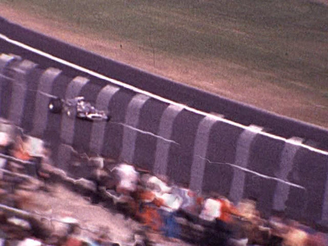

    I present for your viewing pleasure:
    GREEN LINES!
    Mar 2008
