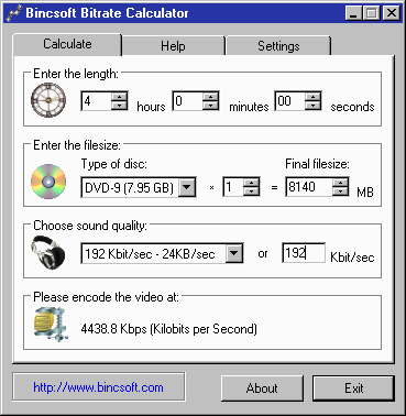

    According to my DVD bitrate calculator you will end up with a video bitrate of 4438 kbps which is a good value for a DVD.
    It is impossible to set a threshold for the video bitrate for good quality. This depends a lot on the source characteristics, i.e. the compressibility of the source. A clip which contains only talking heads without any action scenes is much easier to compress than an action movie. For the talking heads clip you may get excellent quality at a bitrate below 2000 kbps, for the action movie even 5000 kbps might not be enough for a conversion without noticeable artifacts.
    Some clips can be filtered to make them more compressible without compromising the quality too much. Removing some grain or applying some temporal softening can work wonders.
    Cheers
    manolito

  9. @ Manolito
    Thanks Manolito for the advice. I will try out the conversion using 8.5GB discs at a bitrate of 4438kbps as i think i would probably get about that for a single movie on one dvd 4.7GB Disc. As long it xlears the pixelation in the darker scenes when watched back on the 1080p tv it should be perfect for me, as I said im very happy with teh way the comercial DVDs upscale so if i can get my conversion close to that It be nice and good enough.
    also I like the bitrate calculator you are using I must download that and keep it for future use. A handy little tool to have indeed my friend.
    jjcinema1
