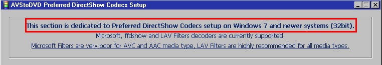

  5. @zoobie
    there are some info to deepen:
    1. LAV Filters 0.69 (included in AVStoDVD 2.8.6 Final) requires at least XP SP3, and you have. You should be able to install LAV Filters 0.69
    2. If you have installed LAV Filters 0.59.1 on XP, then LAV Filters will take the higher merits, overriding MS codecs, very few in XP indeed. No need to change the preferred codecs in XP. That change is necessary and more tricky with Win7 and newer MS OS.
    3. AVStoDVD does not make any sanity check about LAV Filters version. What error are you getting, exactly, and when? You can safely use LAV Filters 0.59.1 with AVStoDVD. Better if you use release 0.69, of course.
    4. If you have installed any codecs packs, please, do unistall all of them and use only LAV Filters.
    @leghorn
    could you please specify better what "same" problem did you get? Unable to use LAV Filters vs Microsoft codecs? Unable to use an old version of LAV Filters? Thanks anyway for sharing your experience.
    Bye
    MrC

    I took out 0.59.1 and installed 0.69 and rebooted.
    I don't have any codec packs installed.
    The LAV buttons are active in the Preferred DirectShow codecs setup but when I click them, I still get ERROR! H.264 preferred codec NOT updated...
    At the bottom, it says User has Admin rights: YES
    A2D is running with elevated privileges: NO (I tried setting this to yes but it won't take)
  7. Member manolito's Avatar
    Jun 2009
    Germany
    I've AVStoDVD (286_Alpha170131_NoInstall) on XP SP3 (32bit) and got it working but it's using Microsoft filters.
    No it doesn't...
    @zoobie
    Please reread MrC's answer. Under WinXP the whole procedure to set the preferred DirectShow filters is not working, because under WinXP this is not necessary. When you install DirectShow Filters, Windows will assign a "merit" value to them. When more than one filter is present for a file format, then WinXP will use the filter which has the higher merit. Usually this means that whichever filter gets installed last, this filter will will get a merit value above the one(s) which is/are already installed.
    This whole thing changed significantly with Windows 7 and above. There now is a Registry Key "HKEY_LOCAL_MACHINE\SOFTWARE\Microsoft\DirectShow\ Preferred" which has all the Microsoft filters in it. Win7 will use the filters from this key regardless of the filter merit, and this new "feature" causes all kinds of trouble. The AVStoDVD option to set the preferred DS filters changes the entries in this reg key to LAV (or ffdshow).
    @Seeker47
    I have no idea why Zippyshare treats my uploads better than others. I certainly did not do anything special when uploading the file. I have noticed that lately they open a new advertising window whenever I download a file, but I have not noticed other bad things (I use a custom Hosts file which blocks tracking and most ads).
    Of course I am open to use different file hosters as long as they do not require to open an account. So Google Drive or similar cloud services are out of the question. I used SendSpace for a long time, but a while ago they became real slow. WeTransfer is another option for me, but they always delete the upload after only 1 week which is a little bit short for me.
    Cheers
    manolito
Name:	preferred filters.jpg
