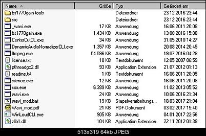

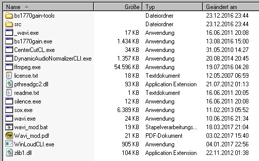

  20. Member steptoe's Avatar
    I keep getting "Trailing options were found on the commandline" when using the wavi mod, wavi works perfectly before using the mod
    No audio track is being written as I'm getting a "at least one output file must be specified" as ffmpeg failed with the above error so AVStoDVD fails the project
    Change back to unmodded wavi and audio is fine
    Tried changing versions of ffmpeg, sox and wavi with the same result each time I change them one by one to see which is the issue
    The issue seems to be ffmpeg is finding something on the commandline it doesn't like or is in the wrong place as everything else is working fine. Sox is creating the files when choosing to upmix in the wavi mod script
    I thought it might have been because some titles have "--" at the beginning or in the filenames but removing these still gave the same errors, so somewhere I'm guessing ffmpeg is getting confused by extra "-" being put in, not 100% certain
    Some of my folders had "-" in front of it to identify them easier in Directory Opus, so I've gone through all that and removed the "-" but the problem still exists
    Any suggestions

    @ steptoe
    So far I cannot reproduce your problem, I need more info about your settings. So I can only guess right now...
    Are you using the latest version of the plugin from here?
    https://forum.doom9.org/showthread.php?p=1801473#post1801473
    Did you install it correctly? I hope you did not forget to patch the AVStoDVD executable (of course this must be redone whenever you upgrade your version of A2D).
    Did you replace the version of FFmpeg in the Wavi folder with a different version? Older versions as well as newer versions do cause issues.
    Your AVStoDVD\Wavi folder should look like the attached image.
    Otherwise I need your plugin settings. Please post the first couple of lines from the batch file.
    Cheers
    manolito
  24. Member steptoe's Avatar
    Originally Posted by manolito View Post
    @ steptoe
    Cheers
    manolito
    [Attachment 41111 - Click to enlarge]
    AVStoDVD wasn't patched, patched it but still exact same issues with extra commands on ffmpeg CLI
    Here is the first lines that I presume tell ffmpeg what its doing, sox encoded upmix fine (as far as I can tell) and created all audio files in temp folder
    H:\AVStoDVD>"I:\Portables\AVStoDVD\Wavi\Wavi.exe" "H:\AVStoDVD\DVD_14_Pagan Gerald Gardner Interview Daniel Farson_1.avs" - | "I:\Portables\AVStoDVD\Aften\aften.exe" -b 192 -pad 0 -dynrng 5 -bwfilter 0 - "C:\Users\steptoe\Videos\DVD_14_Pagan Gerald Gardner Interview Daniel Farson_1.ac3"
    ffmpeg output :
    ffmpeg version N-81045-g450cf40 Copyright (c) 2000-2016 the FFmpeg developers
    built with gcc 5.3.0 (GCC)
    configuration: --arch=x86 --target-os=mingw32 --cross-prefix=/home/rdp/dev/ffmpeg-windows-build-helpers/sandbox/cross_compilers/mingw-w64-i686/bin/i686-w64-mingw32- --pkg-config=pkg-config --disable-w32threads --enable-libsoxr --enable-fontconfig --enable-libass --enable-libbluray --enable-iconv --enable-libtwolame --extra-cflags=-DLIBTWOLAME_STATIC --enable-libzvbi --enable-libcaca --enable-libmodplug --extra-libs=-lstdc++ --extra-libs=-lpng --enable-decklink --extra-libs=-loleaut32 --enable-libmp3lame --enable-version3 --enable-zlib --enable-librtmp --enable-libvorbis --enable-libtheora --enable-libspeex --enable-libopenjpeg --enable-gnutls --enable-libgsm --enable-libfreetype --enable-libopus --enable-bzlib --enable-libopencore-amrnb --enable-libopencore-amrwb --enable-libvo-amrwbenc --enable-libschroedinger --enable-libvpx --enable-libilbc --enable-libwavpack --enable-libwebp --enable-libgme --enable-dxva2 --enable-avisynth --enable-gray --enable-libopenh264 --enable-nvenc --enable-libebur128 --enable-netcdf --enable-libflite --enable-lzma --enable-libsnappy --enable-libzimg --enable-gpl --enable-libx264 --enable-libx265 --enable-frei0r --enable-filter=frei0r --enable-librubberband --enable-libvidstab --enable-libxavs --enable-libxvid --extra-libs=-lpsapi --extra-libs=-lspeexdsp --extra-cflags='-mtune=core2' --extra-cflags=-O3 --enable-static --disable-shared --prefix=/home/rdp/dev/ffmpeg-windows-build-helpers/sandbox/cross_compilers/mingw-w64-i686/i686-w64-mingw32 --enable-runtime-cpudetect
    libavutil 55. 28.100 / 55. 28.100
    libavcodec 57. 50.100 / 57. 50.100
    libavformat 57. 42.100 / 57. 42.100
    libavdevice 57. 0.102 / 57. 0.102
    libavfilter 6. 47.100 / 6. 47.100
    libswscale 4. 1.100 / 4. 1.100
    libswresample 2. 1.100 / 2. 1.100
    libpostproc 54. 0.100 / 54. 0.100
    Trailing options were found on the commandline.
    Input #0, wav, from 'H:\AVStoDVD\Upmix_Temp\normalized.wav':
    Duration: 00:05:03.14, bitrate: 6912 kb/s
    Stream #0:0: Audio: pcm_s24le ([1][0][0][0] / 0x0001), 48000 Hz, 5.1, s32 (24 bit), 6912 kb/s
    At least one output file must be specified
    input format: Raw PCM Signed 16-bit little-endian 48000 Hz mono
    output format: 48000 Hz mono (1/0)
  25. Member manolito's Avatar
    Jun 2009
    Germany
    Sorry, but you did not patch AVStoDVD.exe correctly. In the following line you still have the pipe character ("|") which will not work.
    After the EXE is patched, the line will look like this:
    H:\AVStoDVD>"I:\Portables\AVStoDVD\Wavi\Wavi.exe" "H:\AVStoDVD\DVD_14_Pagan Gerald Gardner Interview Daniel Farson_1.avs" - $ "I:\Portables\AVStoDVD\Aften\aften.exe" -b 192 -pad 0 -dynrng 5 -bwfilter 0 - "C:\Users\steptoe\Videos\DVD_14_Pagan Gerald Gardner Interview Daniel Farson_1.ac3"
    If you are uncomfortable with a hex editor you should use the included PatchIt App which is located in the "Patch" subfolder of the plugin archive. Just in case I'm attaching the latest patched executable (version 2.8.6 Alpha)
    Cheers
    manolito
    //EDIT//
    To be absolutely sure I just tried a conversion using 6-ch upmix mode with a non-patched AVStoDVD executable. I got exactly the same error message as you...
