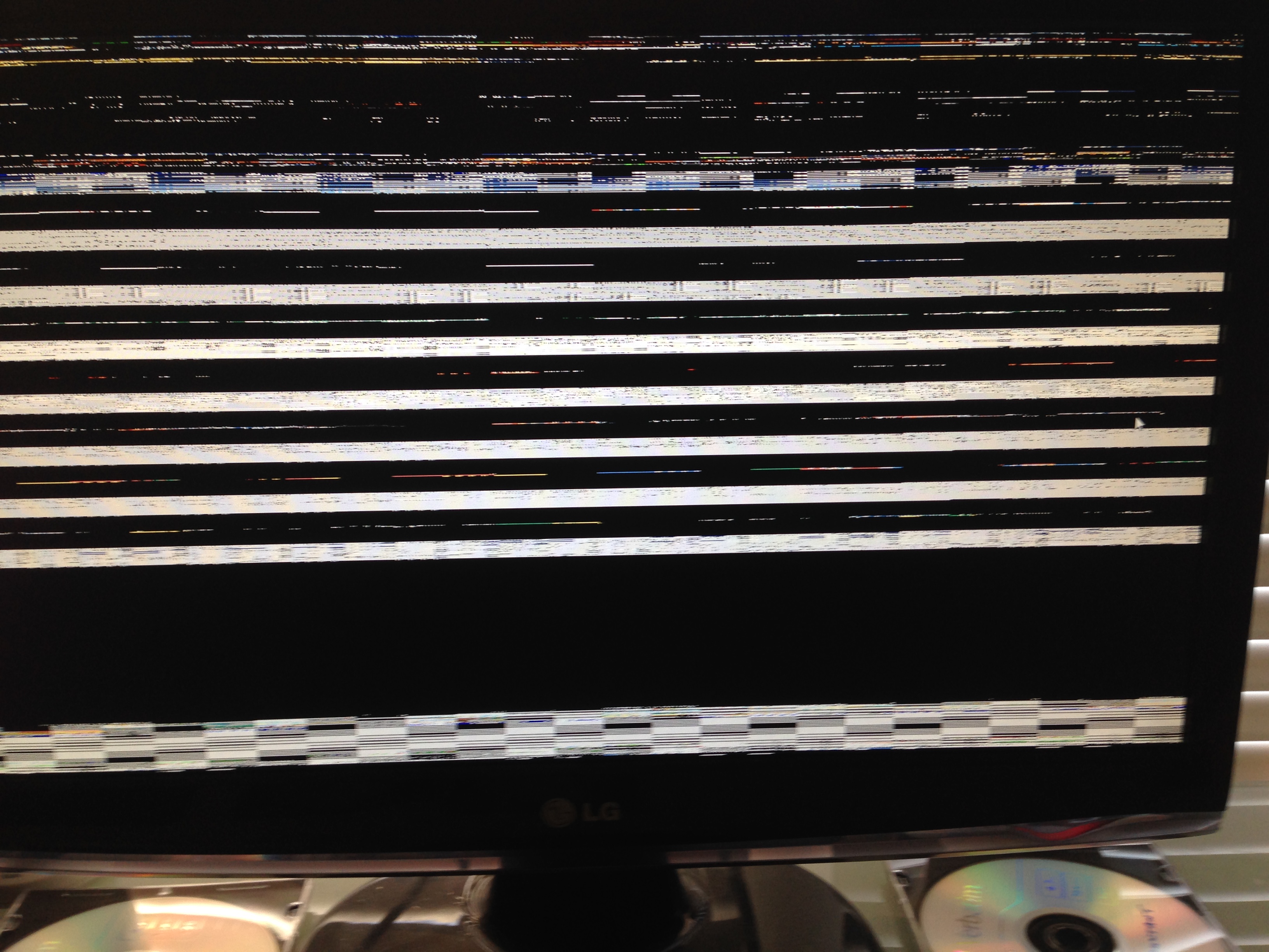

    Hi all,
    Love the program and all the support.
    My father uses this program to make DVDs. He's been using it for years. Nothing has changed in those two year, but he is unable to get by the HC conversion.
    Here is what happens.
    [Attachment 40141 - Click to enlarge]
    Thanks for all the help. Computer just freezes and the monitor displays random lines through it.
    Thanks!
  22. @Grather30
    when exactly does the computer freeze? When starting the project or what else? Since I never got that issue, any type of details is very useful to better understand.
    Bye
    MrC
    AVStoDVD Homepage
  23. Member
    Jan 2017
    Canada
    Happens when going through HC?? Information is from my Dad so lol.
    Thanks!
  24. Your dad should better write here by himself. Tell him not to be shy...
    Bye
    MrC
    AVStoDVD Homepage
