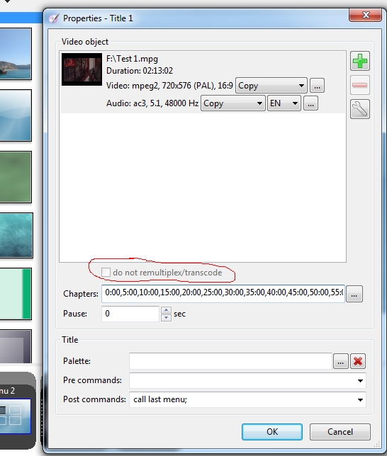

    As you can see both the Video and Audio are set to copy but usually I check the "do not remultiplex/transcode" option as well but for these outputs from AVS2DVD that option is greyed out so I am presuming DVD styler will do another re-encode with its ffmpeg which is kind of taking a step back after using Hcenc in AS2DVD. All I want from DVD styler is to add my menu and not do a complete encode as I have done with my other outputs from AVS2DVD in the past with no issue as they always meet the customised output setting of 4300 so I knew they would always fit on a DVD via DVD styler without a re-encode. I am think maybe because we unchecked "keep mpeg2 compatibility" the out put is maybe not 100% DVD compatible and so DVD styler had to do a slight encode but thats just a thought.

    I read in a thread on the DVD styler forum from Manolito basically saying that if that option is greyed out then you can force it by selecting "copy" under the audio and video options. In another thread the Author of DVD styler has stated that styler checks if the source MPEG file contains navigation packs and if not, it must be remultiplexed to add them. so I guess that DVD styler is just doing that in remultiplexing the mpgs from Avs2DVD and not actually doing another re-encode so in theory these files should not be touched quality ways by DVD styler, its just the DVD structure with menu built (or I think lol!)
    anyway I selected "copy" in audio and video and it didn't take long for styler to built the DVD successfully so I guess this must be correct. The good news is that I can now take the ConvertXDVD finsihed DVD (ffmpeg VBR 1 pass Total play Time 3H45Min) and the AVS2DVD (Hcenc VBR 1 pass Total Play Time 3H45Min (with menu from DVD styler) and do the comparision tests on the PC with VLC player and then on the standalond DVD/BLuray Players on the LCD TVS. I will be asking others to take a look as well just to see what theor opinion is but from talk here I am expecting the HCenc conversions to be of better quality in some way or form to the ConvertXDVD FFMpeg ones. I will update wit the results later in week.
    Thanks again to Manolito and davexnet for both your inputs.

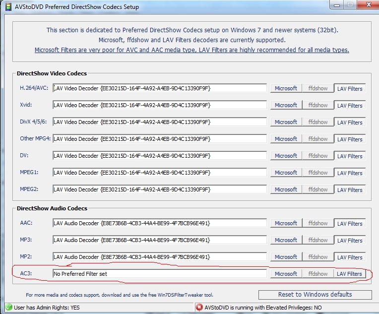

    Run AVStoDVD and check your default codecs from the menus under codecs/preferred DirectShow Codecs Setup
    These should all be set to LAVFilter, but it happens where microsoft assumes its better than everybody else and either refuses to change it or changes it back at random. Audio out of sync is a good pointer to LAVFilters not being the defaults and AVStoDVD cannot change them. Not AVStoDVD but Microsoft not playing
    If they are set to Microsoft codecs, download this little tool that will force change all the DirectShow filters to LAVFilter. I even found out that the 64-bit filtesr were still set to Microsoft, so it does work
    http://www.free-codecs.com/download_soft.php?d=5434d9caba92500582324c2e096b640a&s=820&...tertweaker.htm
    It runs from anywhere as it doesn't need installing, once its run click Preferred Decoders, then check your decoders are set to LAV Video
    Run AVStoDVD again, and check your default codecs again, they now should all be set to LAV Filter if they were not
    Try your project again, it fixed my out of sync when I knew it worked before, then I remembered something about the codecs which refused to change but with that little tool all my out of sync issues were fixed
  9. They seem to be all set to LAV Filters , all but the very last AC3, ITS JUST SAYING "No Preferred Filter set". Now most of my Source files will have AC3 soundtracks as they are DVD Rips so would this be the cause of audio sync maybe? I have included a screen grab as well.
    -------------------UPDATE--------------------------
    its ok fellas I retried the steps and all went well audio is all in sync.

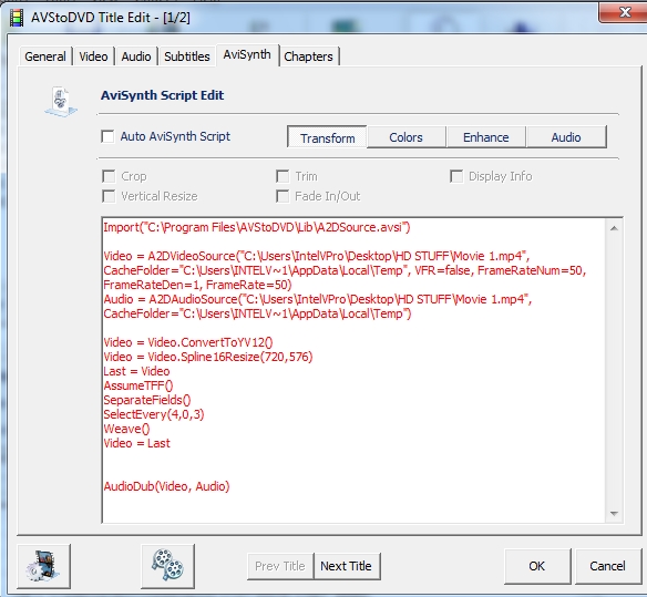

    There are two methods for your frame rate conversion implemented in AVStoDVD. The default method uses DGPulldown. The resulting judder is very light, most folks will not notice it. And the audio can remain untouched with this method.
    The other method is called "PAL Speedup". You can select it under "Preferences -> AviSynth". With this method video and audio are sped up slightly to go from 24 fps to 25 fps. All commercial DVDs use this method.
    The slightly faster video will not be detected by anyone. In most cases the viewers will also not notice that the audio is a bit faster and the pitch is a little higher. This might be different for music DVDs.
    AVStoDVD speeds up the audio in the conventional way, i.e. the pitch will be a bit higher. There is another way to convert the audio which does speed up audio but keeps the pitch at the original pitch. This mode is a little dangerous as it can introduce ugly artifacts depending on the audio characteristics. If you need to keep the original audio pitch you can do this in AVStoDVD by editing the AviSynth script and using the "TimeStretch()" parameter.

  12. @manolito
    Thanks for the wealth of information. I understand the Interlaced method more clearly now and the way it drops fields rather than whole frames. I can also see how this method would be pointless in going from NTSC progressive 23.976 content to PAL.
    Out of the methods you have explained I think I will give the "PAL Speedup" Method a try as if no ones really notices the video or audio speed up a little I think that may be the best one for me to try especially if commercial DVDS use this method it must be reliable enough for this type of conversion.
    Just to confirm I am doing this method correctly I just open AVS2DVD Under "Preferences -> AviSynth" I tick the "PAL Speedup" box and then just add my source file and so a conversion as normal?
    I will try this out tonight and see what the results are like.

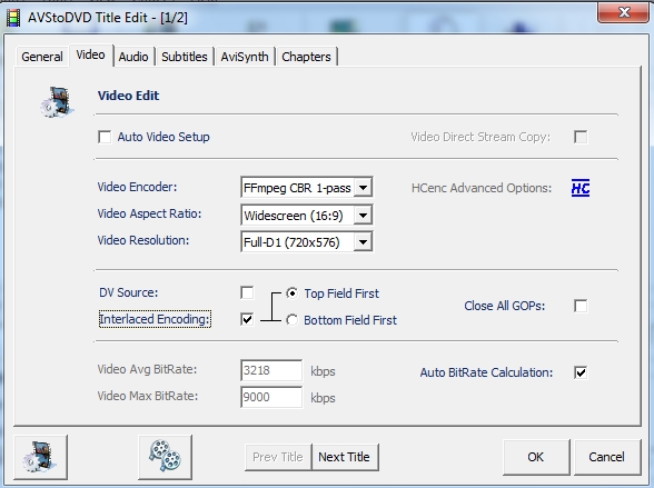

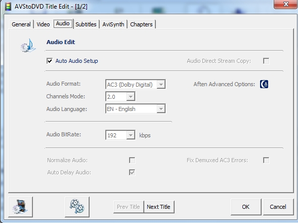

  14. @manolito
    Thanks its works great. I dont notice the speed up or the audio pitch change at all.
    The only thing is I had to use FFMPEG 1pass as when I used Hcenc 1PASS I find my audio is always out of sync I checked all my "preferred direct show codecs" and all where set to LAV FILTERS but the very last one "AC3" It was Microsoft so I changed it to LAV not sure if this made a difference as I then tryed FFMPEG 1PASS and all seems to be in sync. So Not 100% sure if its the HCenc side of things or that LAV settings.
    I have made my DVD up from 2 source titles. AVS2DVD seems to compress both to the DVD4.7GB without any issues at all. one is the NTSC Footage @ 23.976FPS Progressive and the other was already a MPG PAL file at 25FPS Interlaced. AVS2DVD sees to have converted both very well by using the PAL Speed up for the NTSC source and as the PAL Source was already PAL Compatible the PAL Speed up seems to have not altered this file which I am very happy about I it only changed the source that needed it. I ticked PAL SPEED UP in the preferences then added my source files and then selected DVD Structure output and in each titles I changed the Video properties to Video Encoder FFMPEG 1PASS.
    I also checked Interlacing and Top Field First for both as I rember you saying most commercial dvds are interlaced for pal so I guess this can't do any harm can it?
    also I was wanting to experiment with your plugin for FFMPEG 2PASS to see if it helps quality over the 1pass as If it is the HCenc that is causing my sync issues I will have to just stay with FFMPEG in my conversions with AVS2DVD.
    jjcinema

    For HCenc 1-pass VBR causing audio sync issues while FFmpeg 1-pass CBR does not I only have one explanation: Seek errors during the first analyzing pass. You can only overcome this by either using 2-pass VBR or by using a source filter which indexes the source. This would be DGIndex for MPEG2 sources or FFmpegSource (ffms2) which should work for any source. Try to change the source filter for video and audio (under "Preferences -> AviSynth") from A2DSource to FFmpegSource and see what happens.
    It is true that most commercial PAL DVDs are flagged as interlaced, but this does not mean that the content is also interlaced. If the DVD was made from real optical film (as opposed to Video) then the content will mostly be progressive, and it makes a lot of sense to encode such sources as progressive. (Main reason is that MPEG2 encoders are more effective in progressive mode, i.e. they deliver higher quality at the same bitrate.)
    Unfortanately the only way to find out for sure if the content is interlaced or progressive is visual inspection. Load the source into a software player which does not try to deinterlace (I use VirtualDub) and step through scenes with horizontal movement. If there are no combing artifacts then the source is progressive and should be encoded as progressive. In AVStoDVD you would have to change the title properties from interlaced to progressive. (Title -> Edit Source Title Info -> Video Scan Type)
    If you really cannot get HCenc to work without sync problems then I would recommend to use my FFmpeg VBR plugin. The AVStoDVD built-in mode for FFmpeg is CBR without B-Frames which only gives you good quality at very high bitrates. My personal threshold is about 7000 kbps. For lower bitrates you should use one of the VBR modes. Make sure to get the current version of the plugin from this post:

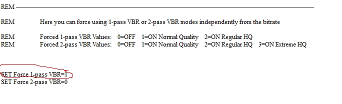

  16. @manolito

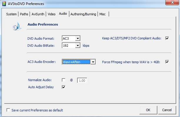

    I tried changing the source filter for video and audio (under "Preferences -> AviSynth") from A2DSource to FFmpegSource for the Hcenc conversion and it made no difference I'm still getting audio sync issues.
    Because of this I decided to switch to FFMPEG and use your Plugin to try a 1pass VBR Instead of the default 1Pass CBR. I tried a 2 pass but it took over 2 hours to complete so I am not sure if I set the values correctly in your .BAT file. I Have included screen grabs for what I think is a 1pass VBR setting but Im not sure what to do about the second screen grab as its related to setting the Matrix and the use of Mplex. Basically I will be putting 2 movies on one DVD and want to use the best FFMPEG setting via your plugin. Now I know that the 2pass will be better but I want to see the Speed vs Quality differnerance between the two before I settle on one. Can you point me in the right direction with the .BAT file settings? I would be much appreciative.
    Also on my test the audio was insync 100% so Im not really sure why Hcenc makes its go out of sync but The FFMPEG and your plugin seem to be working fine where that issue was concerned. Im I right is saying that if I set
    SET Force 1-pass VBR=1
    SET Force 2-pass VBR=0
    this will force a 1PASS VBR which should be better than the default 1PASS CBR? Also if the force option is set here does it matter about the values of the "threshold" settings or are these ignored?
    jjcinema

    Getting audio sync errors only with HCenc but not with FFmpeg is really very strange. There were reports that on some Win10 machines users could not get HCenc working at all, but sync errors even when avoiding DirectShowSource - that's a first for me.
    Whatever, you already figured out quite well how to use the FFmpeg VBR plugin. The first couple of lines in the batch file where you can force encoding modes and HQ modes independently from the video bitrate were added quite recently. The original concept was to switch between different modes automatically depending on the video bitrate (like AVStoDVD does it when "Smart Selection" is activated for the encoders). It turned out that many users were more comfortable with a way to force modes no matter what the bitrate is.
    1-pass VBR and 2-pass VBR settings are parsed from top to bottom, so if the 1-pass VBR value is not "0" then 1-pass VBR is forced, the value for 2-pass VBR is ignored. And yes, when you force one of the VBR modes, all threshold based encoding mode decisions are disabled.
    And yes, 1-pass VBR is far superior over CBR (at least over the AVStoDVD default CBR mode). The default CBR mode does not even use any B-Frames (Bidirectionally Predicted Frames) which makes it quite inefficient. I only use the default CBR mode for bitrates above 7000 kbps.

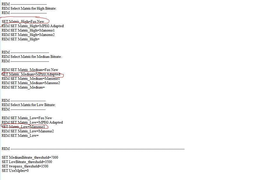

    also would Mplex be better to use to lower the chance of any audio sync issues appearing and if I want to use Mplex do I just add 1 so it looks like this:
    SET UseMplex=1
    one more thing I am slightly confused how to use the different matrix's to what do you mean by "To use the ffmpeg built-in MPEG Standard Matrix select the "Matrix_xxx=" entry" and in the following code for say the Medium Matrix do I change the "SET Matrix_Medium=MPEG Adapted" value to something like SET Matrix_Medium=Manono1 or do I delete the REM part or just add one of the Values (Fox New, Mpeg adopted, Manono1, Manono2)
    to the line REM SET Matrix_Medium= so it becomes REM SET Matrix_Medium=Manono1?
    This part of the codes Im not sure where to edit the values:
    REM Select Matrix for Medium Bitrate:
    REM ---------------------------------
    REM SET Matrix_Medium=Fox New
    REM SET Matrix_Medium=Manono2
    Can I set the Plug in to a 1passVBR using Mplex and let it automatically select the most appropriate Custom Quant Matrices based on the default values you have already set?
    Sorry for sounding stupid Manolito but I am learning bits as I go along so I appreciate your help and patience.
    Many Thanks
    jjcinema
    This is just basic batch file syntax. For the 4 matrices which come with the plugin, you just have to remove or add the "REM" at the beginning of the line. No need to type a matrix name manually. (REM stands for "Reminder", it disables the rest of the line which follows the REM statement)
    If you do not want to use a custom matrix, but use the FFmpeg built-in matrix instead, enable the "SET Matrix_xxx=" command. The "SET var=" command removes the variable "var" completely, it becomes undefined. I added this command just for better readability, the effect is the same as if the command was not there at all.
    So basically all you have to do is define one (only one!) matrix for each bitrate by removing the REM statement for the matrix you want and adding the REM for the matrices you do not want to use.

    Yes of course. The default values for matrix selection are:
    Fox New for bitrates above 7000 kbps
    MPEG Adapted for bitrates between 3500 and 7000 kbps
    Manono1 for bitrates below 3500 kbps
    This is quite conservative and should give you good results in most cases. Personally I only use the Fox New and the Manono1 matrices, the threshold to switch between them is at 5500 kbps. Just a matter of personal taste...
    Cheers

    SET UseMplex=1
    also is there much difference between 1PASS VBR 1=ON Normal Quality and 2=ON Regular HQ?

    Yes, this is the correct setting to use Mplex instead of FFmpeg for multiplexing.

    I have been running your plugin with my HD progressive to Interlaced PAL workflow using the settings and code we talked about and its performing fantastic. Im getting very very good results and most importantly no audio sync issues like I was having with Hcenc. Great work my friend.

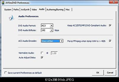

    sorry I spoke too soon. did three conversions all came out fine but the latest on has the audio sync issues. All my HD recordings has the same specs so not sure why this one was different. I have included my log file and screen grabs of my settings I use plus the settings I use in your VBR Bat file ( I had to zip it to get it to upload).
    Love the programme but this audio sync issue Im getting is a real pain.
    would it be because my audio encoder in preferences is set to "wavi+avin"? if I changed i tto FFMPEG (safemode) or one of the other would this make a difference, Im not sure what each of these settings do as I also use the default.
    any help is welcomed.

    I went over your logs, checked your settings, and I did not find anything suspicious. The VBR plugin cannot have anything to do with audio sync, using Wavi+Aften for audio processing is also reliable. I cannot believe that changing the method to something else like FFmpeg Safe Mode would make any difference.
    I still have the suspicion that your source files are the problem. Are you absolutely sure they have no sync problem? I remember you mentioned a while ago that your TV recorder splits up the video into separate files, and after the segments were merged together again you had sync problems after the merging point.
    Only two things you could try come to my mind right now:
    1. Change your source filters from A2DSource to FFmpegSource for both audio and video (but I think you already tried that in the past).
    2. Remux your MP4 source file to MKV using MKVToolNix and use the MKV as your source.
    If these things make no difference then I am out of ideas...
    Can you cut out and upload a segment from your source file which has these sync issues?
    Cheers

    Unable to tell what the problem is with the synch, really need to evaluate the whole encode. Was it in synch to begin with and then drift out?
    Was the whole thing out, etc,etc.
    Secondly, the problem with the interlaced mode is that the source contains 24 unique fields in 50. I don't think the script as-is handles it
    accurately . Whether this is something to with the synch problem, I don't know
