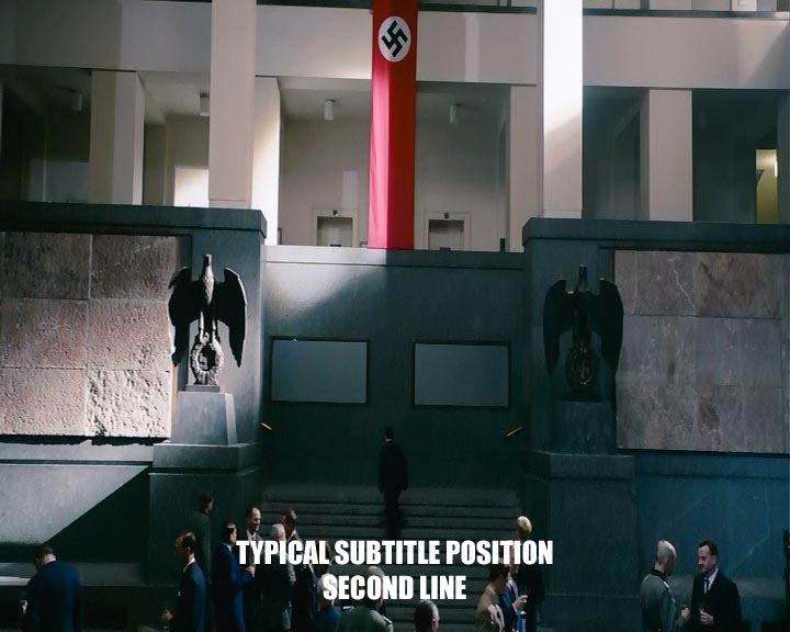

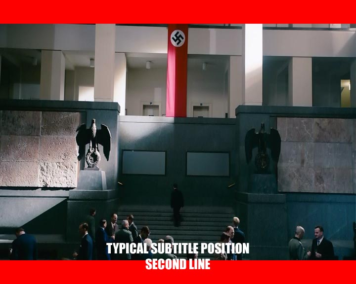

    Originally Posted by RBTO View Post
    I noted in looking at video frames, the original PAL are anamorphic while the converted NTSC are not, if that's worth anything.
    It's not. By that definition, all DVDs are anamorphic. I think you mean in the PAL DVD, at 720x576 and unresized, the people look tall and thin while in the NTSC DVD, at 720x480 and unresized, the people look "normal". Except they don't. 720/480=1.5. "Normal" would be 1.33:1, like 640x480. The people you're seeing at 720x480 are actually somewhat squat and fat, before the resize.
    Please correct me if I've not said what you meant. Anyway, none of this has anything to do with the subtitle problem you encountered.
    Not all DVDs are "anamorphic". When widescreen features are transferred to DVDs, there are two choices: letterbox the image and insert black lines at the top and bottom which results in these blanked lines not contributing to vertical resolution of the image; stretch the widescreen image vertically so it occupies the full 480 lines thus utilizing full vertical resolution for the image, and then have the DVD player recompress the image vertically to its widescreen format (DVD players have this capability). The latter approach is used on "anamorphic" DVDs (Blu-Rays tossed this process). This process still didn't fit every widescreen movie, but it increased the utilization of the video lines available, and of course it still results in letterboxing of the final image.
    Anyway, when I saw the PAL image, I incorrectly concurred that it was an "anamorphic" DVD. As it turns out, "The Saboteurs" has a 16:9 aspect ratio so no widescreen treatment is needed (hence this DVD is not "anamorphic"). You are completely correct in saying the 720x480 format needs to be resized to fit the 16:9 aspect ratio (the pixels aren't square but rectangular). My bad.
    What I was trying to say is that if the PAL frame is resized to the NTSC frame and the subtitle frame isn't, it might be the reason behind the problem I was having. Take a look at the attached images. I placed a sample subtitle across the PAL frame in the first illustration. In the second, I resized the frame to approximately 83.3% height (dropping the pixel count from 576 to 480) for the NTSC conversion. This was applied to both the image and the subtitle. In the third illustration, I applied the reduction to just the image and look what happens to the subtitles - just about what I was seeing before I raised them 90 pixels so they were back on the image area.
    That may or may not be what happened, but that was what I was trying to say in my original post. Scratch the anamorphic bit.
