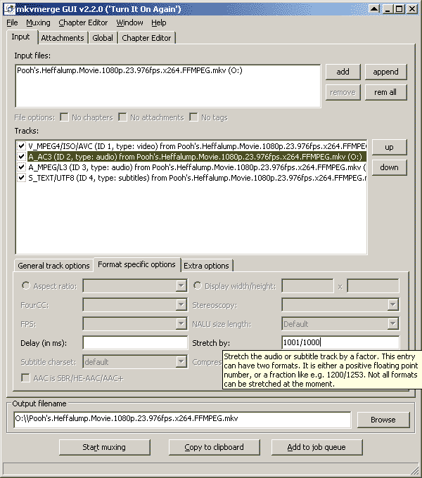

  14. I often demux audio from mkv with MKVextract GUI to recompress them to make them smaller to fit on DVD. Quite often some of the audio files ar 3 to 7 seconds shorter. And the delay is not fixed. It is stretched over the whole audio track. I have solved this issue by setting playback ratio - there is such option available in MKVmerge GUI. I put e.g. some 10001/10000 and everything fits. I assume the stretch ratio was put in the MKV file in the first place. But its lost when extracted. But I do not have proof of it. Also it does not solves the problem how to stretch the audio when it has to be converted to DVD. I use CoolEdit if its stereo, or I download lower resolution avi with the same sound if it is 5.1 sound.
