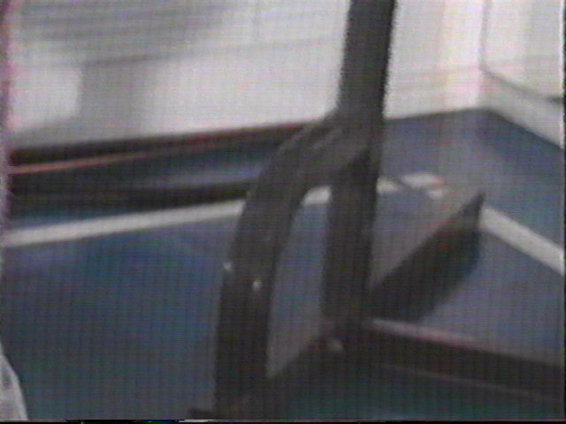

Whenever i try to capture with my Hauppauge WinTV (BT878) card i get these awkward vertical lines in the picture. Seems like some type of grounding problem or something that interferes with the card. Have tried moving it a couple of slots down but no difference. Can't remember i had these before. I don't have my equipment hooked up right now so i could be wrong, but i think it appeares more (or only) when i run PAL60, not 100% sure.
I should say that i try to capture from my Telefunken VCR by the way.
* Both the S-Video and antenna connection give the same result.
* Tried other cables.
* When connecting VCR to TV there no disturbances in the picture.
Thank you very much for your help!

	There are 50 repetitions per horizontal line. If the pattern is stationary then it is about the 50th harmonic of the horizontal line frequency. If it moves then it is not a harmonic. Either way, a poor ground could be responsible but it could be a poor ground return in a cable to the card as well as a ground in the computer.
 It could also be interference from another product coming in through the power line or radiated by another product. For the first, try unplugging other nearby products and for the second, try moving other equipment further away.
