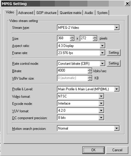

  1. I am trying to convert several Divx videos to MPG for ultimate burning to DVD. The conversion from DivX to Mpg shows a slight jerkiness or hesitation every 4-5 sec. The original AVI file does not have this and is smooth. I am using TMGENc Plus 2.5.
    The original avi has a frame rate of 23.976, but the encoded mpg is still jerky with either 23.976 or 29.97 f/s. These are the relevant screen. I am using the mpg conversion guide posted. Does anyone have any suggestions?
    Use 23.976 with 3:2 pulldown(under encode mode I guess) and author to a dvd and it should look okey. Or try convert with FAVC instead, it does a good job and is pretty easy to use also.

  4. I made some progress... It appears that the jerkiness is when I use Windows Media Player to view the mpg file. When I use TMGEnc DVD Author to view the mpg, the jerkiness is not there. Does that mean it is the codec used by Wind. Media player?
    thanks,
    Jack
  5. I'm a MEGA Super Moderator Baldrick's Avatar
    Probably. It may work better if you play the authored dvd with windows media player. Just playing 23.976 fps 3:2 pulldown mpgs might cause strange playback in some players/codecs.
